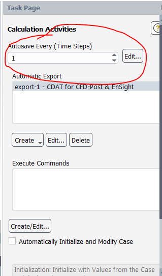

    • jaufarusadique
      Make sure this value is not 0 (zero)
