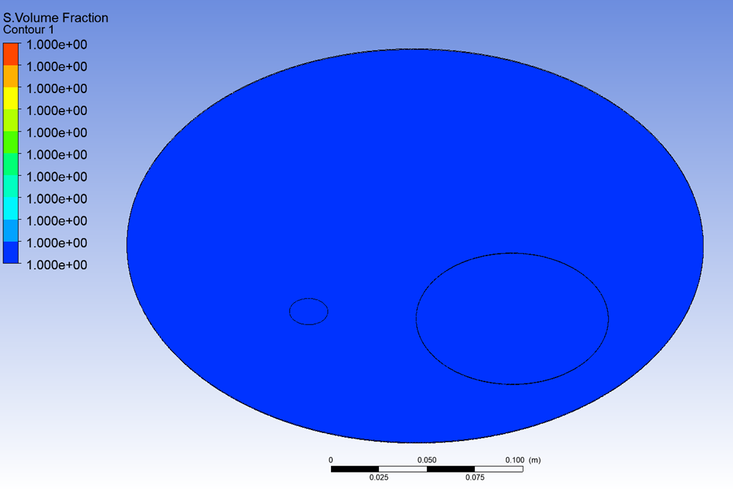

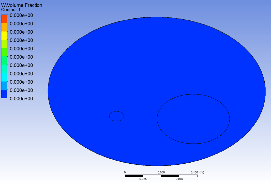

      Originally, the grinding space was water, and then different liquids were added to observe the volume fraction in the area, but only the volume fraction of a single liquid remained after production.

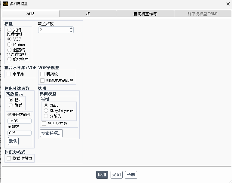

      The model uses vof to set two phases and two different liquids
      What boundary conditions were set, what initial conditions and how well did it converge during the run?
    • hone zifu

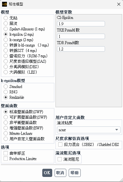

      Set VOF and k-eqsilo in the model, set S water as the first phase and L water as the second phase in the vof part, set the speed of 0.2 for the inlet, set the rotating surface for the upper and lower surfaces, and set the surrounding circle as the pressure outlet
      And which zones did you patch with which phase?
