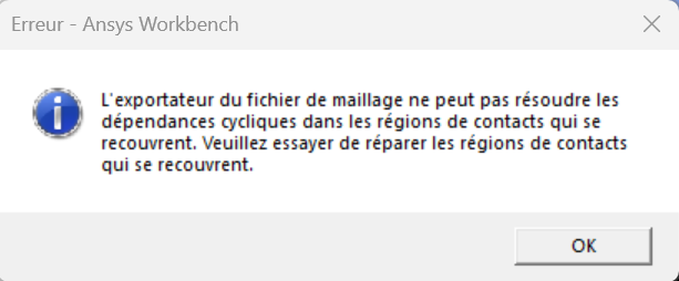

      I have an error about contact region and cyclic dependance. How to fix it ?
      Thank you,
      Louis
    • Stella Peloni
      Sometimes this is due to automatic contact generation. Please, verify these contacts (if you have any), but also the manually created contacts for overlapping. You can do this check by right clicking on Contacts and then selecting Check Overlapping Contact Regions. In the Message region, an Info may exist saying about overlapping (check below).
      Right click on that, and then Go To Objects, to visualize the overlapping contacts in the tree.
      Have a nice day ahead.
