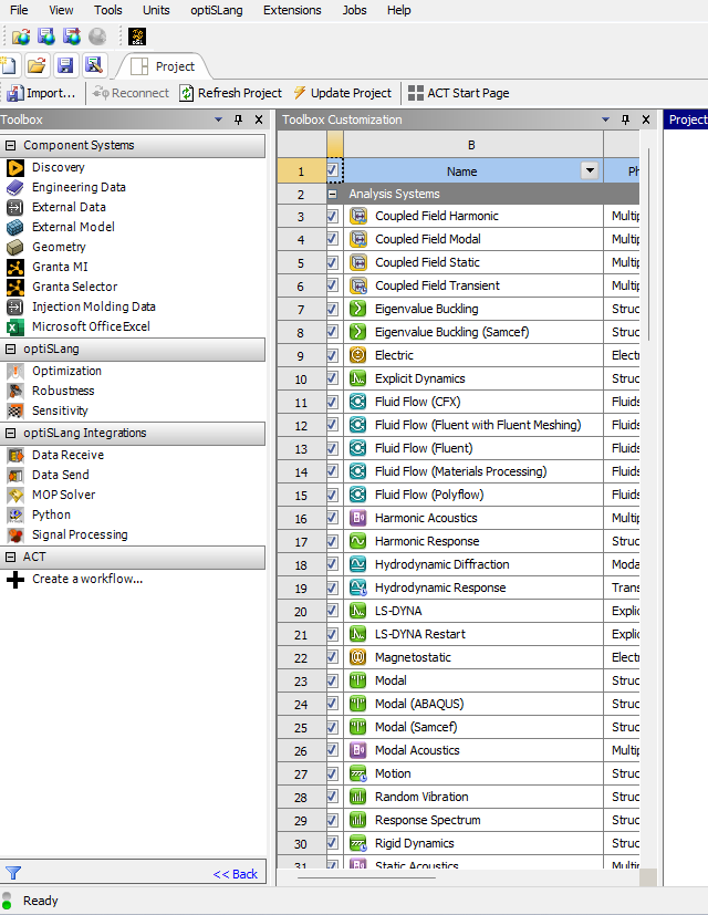

Hi Farhad,
1. Can you please check if you have added server details in Ansys client licensing settings?
2. Can you confirm if you have required licenses to use Fluent? If so, can you try resetting Workbench from View –> Reset workspace.
3. Open a file explorer and type %appdata% in the address bar. Locate the Ansys folder and rename it to Ansys.old.
I hope this helps,
Mrunali.Â
