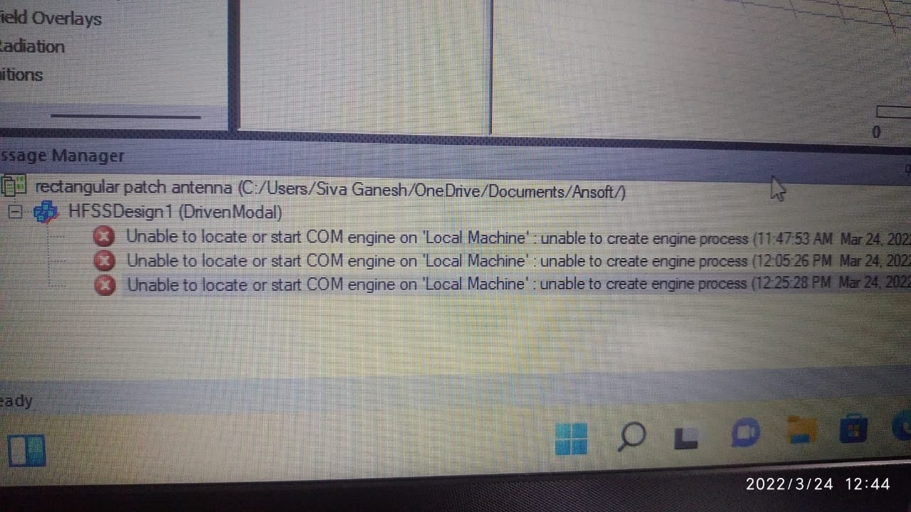

    • vijayalakshmi
      Hello everyone,
      I use Ansys Electronic Desktop (EDT) student 2019 r1 version. I have installed the software on my laptop. I was working on in EDT. In one of the designs, when I started simulation, I got the error message that . The error message is,
      rectangular patch antenna (C:/Users/Siva Ganesh/OneDrive/Documents/Ansoft/)
       HFSSDesign1 (DrivenModal)
        [error] Unable to locate or start COM engine on 'Local Machine' : unable to create engine process (11:47:53 AM Mar 24, 2022)
        [error] Unable to locate or start COM engine on 'Local Machine' : unable to create engine process (12:05:26 PM Mar 24, 2022)
        [error] Unable to locate or start COM engine on 'Local Machine' : unable to create engine process (12:25:28 PM Mar 24, 2022)
      Can someone please explain to me what the issue is?
