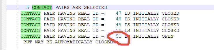

      Hi ,reading this old discussion, can you please tell to me how to actually find those contact in ansys by the ID number?nIs there any search tool in ansys to do that?nBy myself in the model I have defined only two bonded contacts, But when I did the contact pairs check ansys has found 5 contacts one of them is open but may be closed. Can you please explain how to find this last contact using the real ID number 51 and what it means that it may be closed?nThank you!nn
