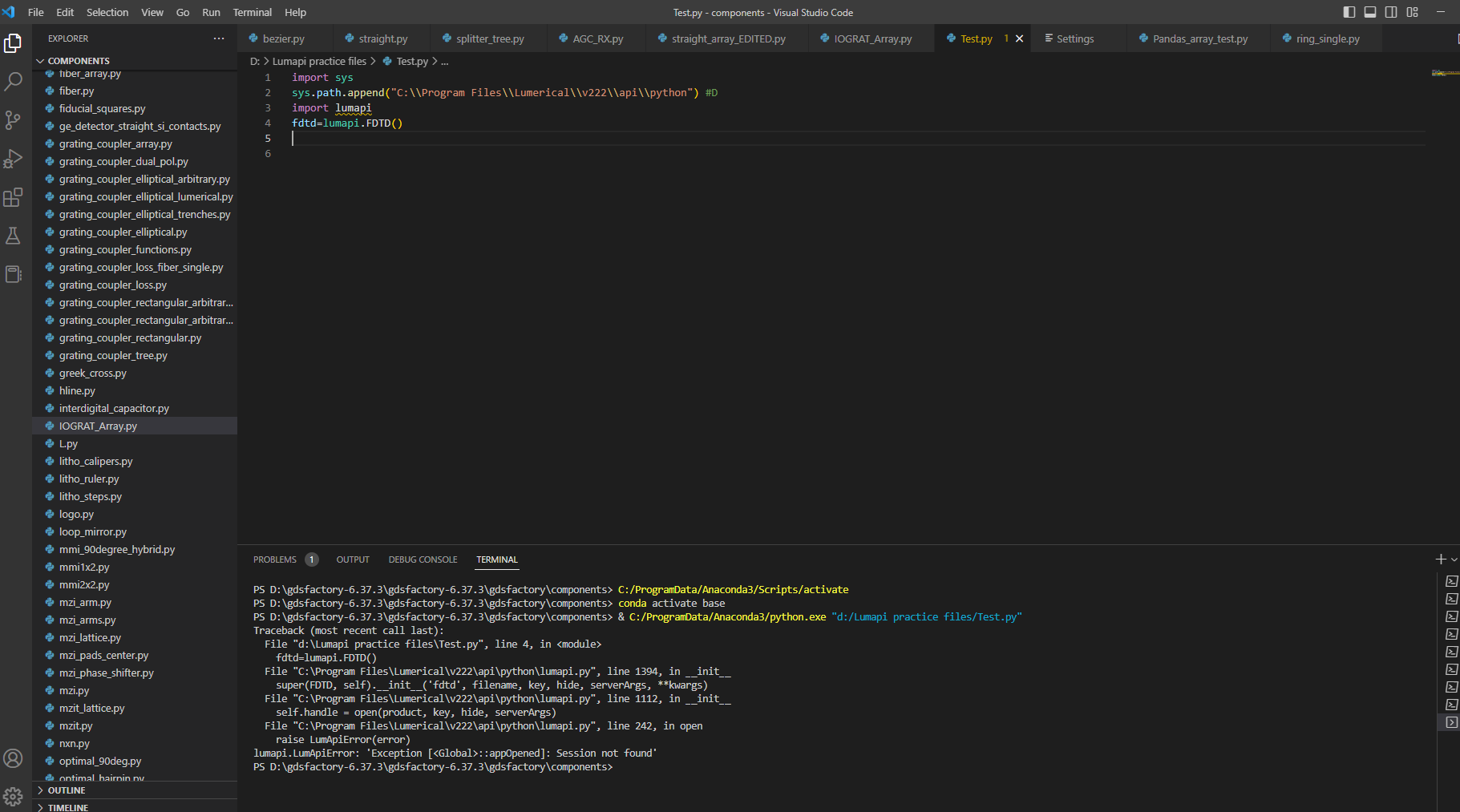

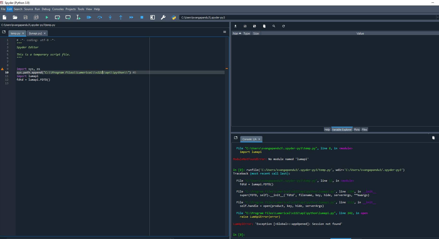

      I am trying to implement atuomated layout simulation using lumapi module with the layouts designe din GDSFactory. This is similar to constructing an FDTD model using Python within Spyder or Jupter notebook. When I run the script, the FDTD starts to open but them no layout opens eventually and it ends up giving an error in the console. I have raised the ossue on Github and was told to contact ansys support but could not reach out to them on git. It would be great if someone could review my case so I can send detailed information. Here are some images associated with the error. I have soecified the api path in my code.

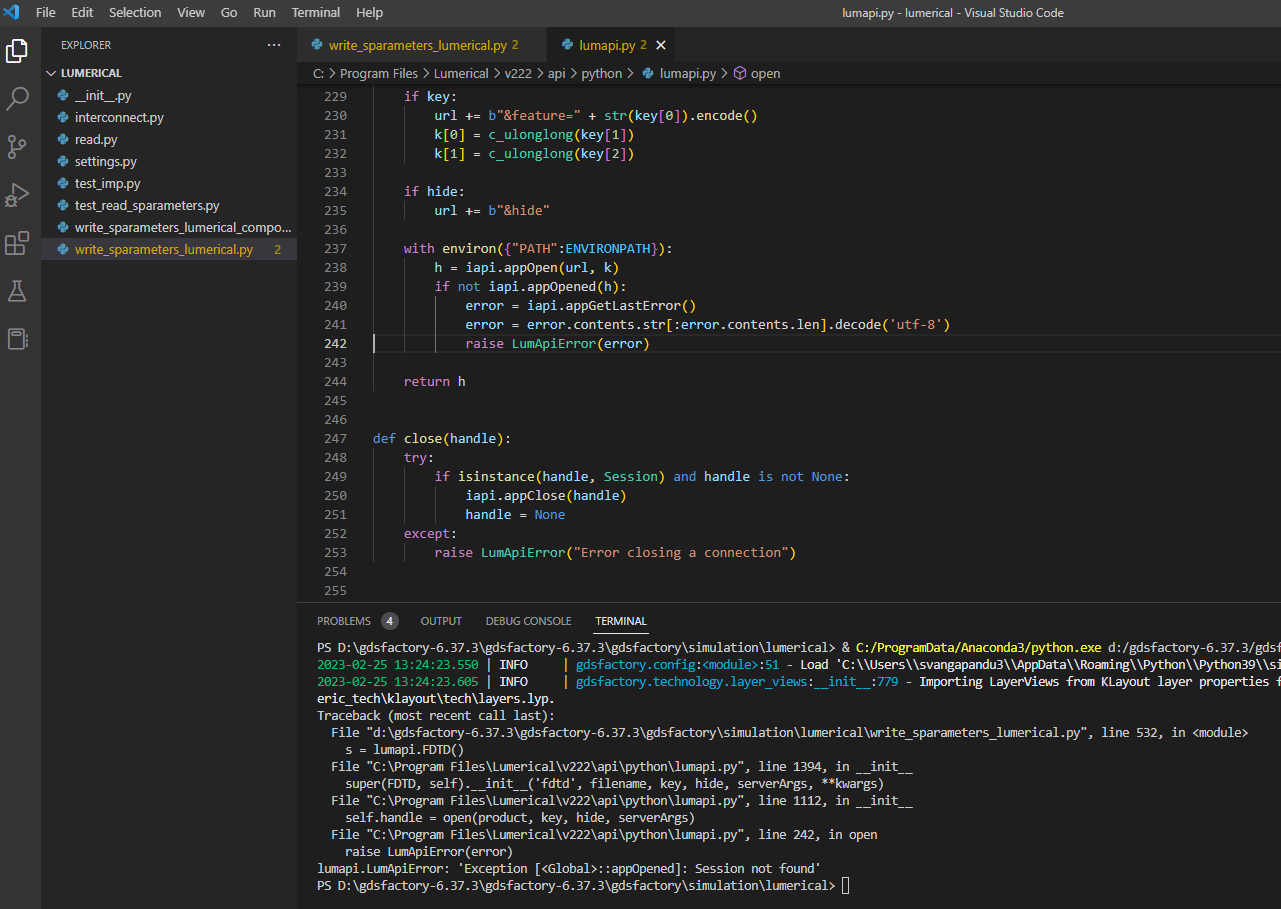

      The erro seems to originate from the lumapi.py file in the Lumerical's directory.

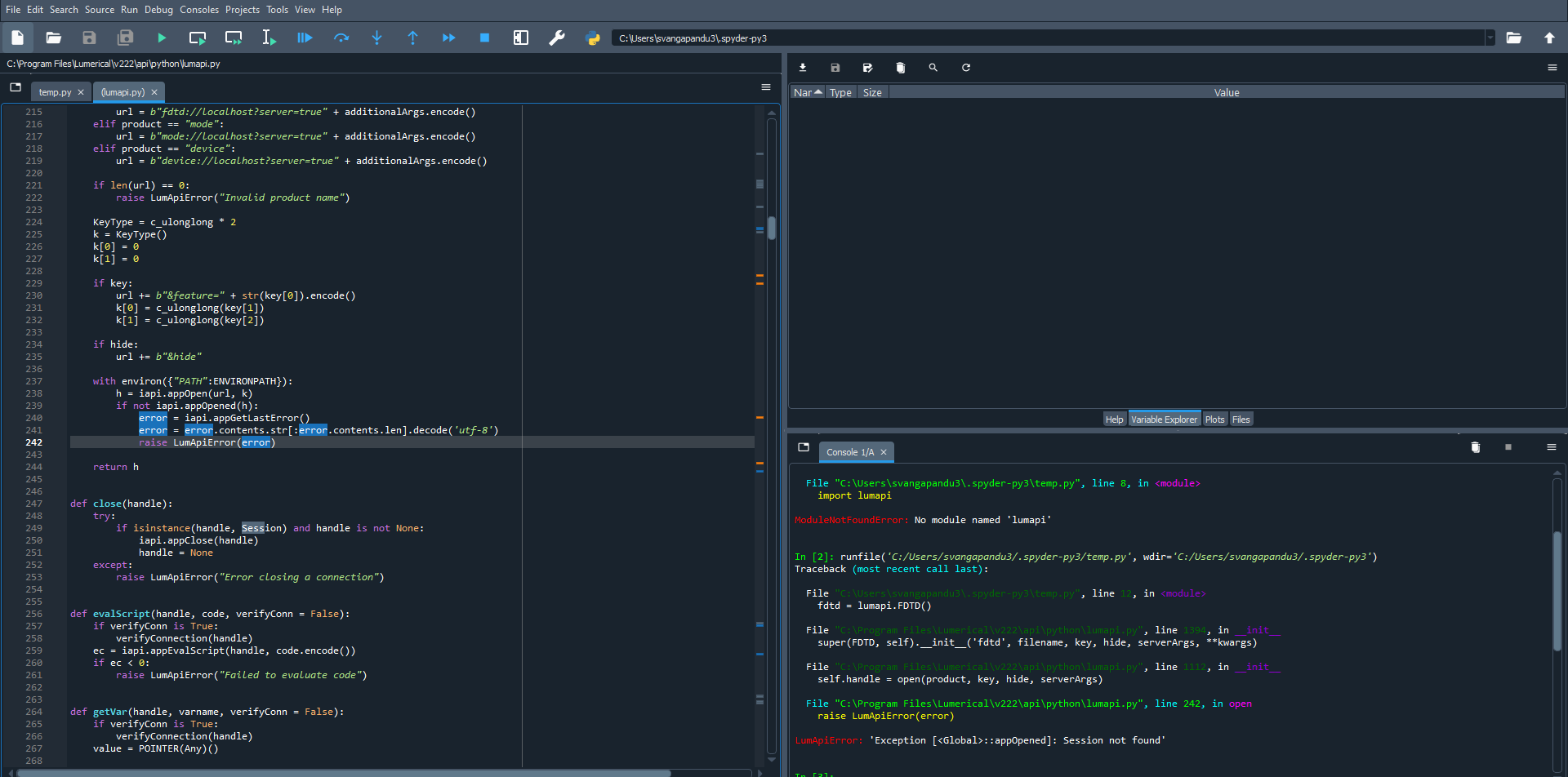

      I have the issue even there. It seems that the error/except is due to the environment path. Ihave anaconda installed in my system and Spyder comes with it. As you can see, I wrote few lines of the code to just start an FDTD session. But an exception is raised pointing to the line #242 in the lumapi.py script in the Lumerical's api directory.

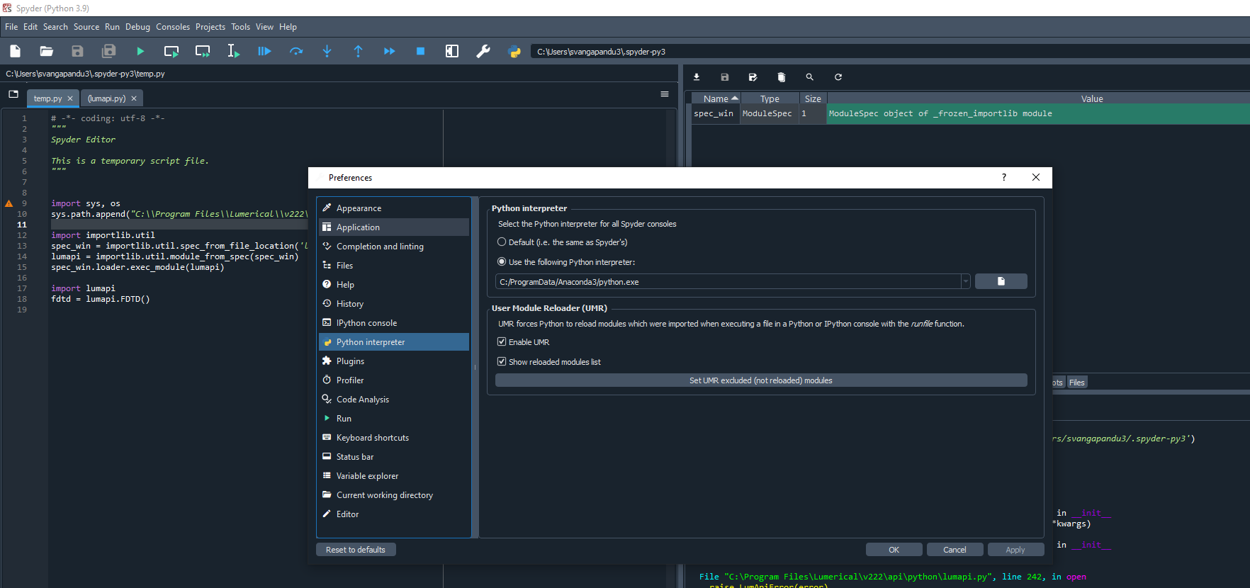

      Hi Taylor,
      I tried changing the sys.append path. It didnt help. I still get the error.

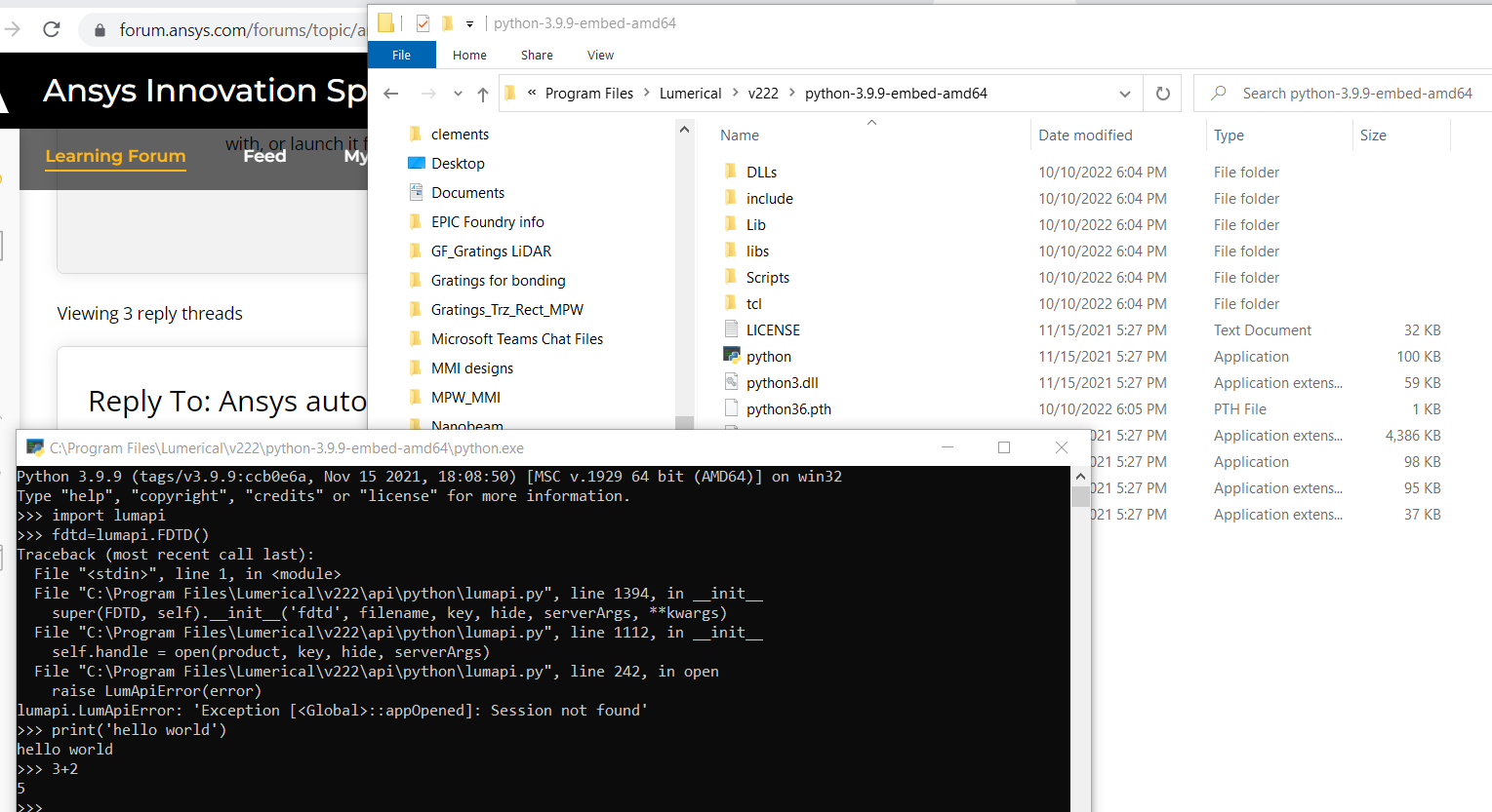

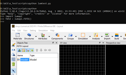

      I tried to set the interpreter in the Spyder IDE to the Lumerical’s Python interpreter (provided with the package). Then I ran the script which gave the same raise exception error
      Alternately, I tried opening the interpreter directly from the Lumerical by right clicking it. Then I wrote the two lines “import lumapi”, and “fdtd=lumapi.FDTD()”. I still get the same error.
      Not sure what’s going on here

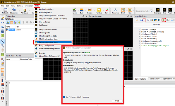

      • Lito
        @rakesh_krishna,
        Have you tried running the script from the Lumerical CAD > Script file editor window with the Python integration shown as "Active"?

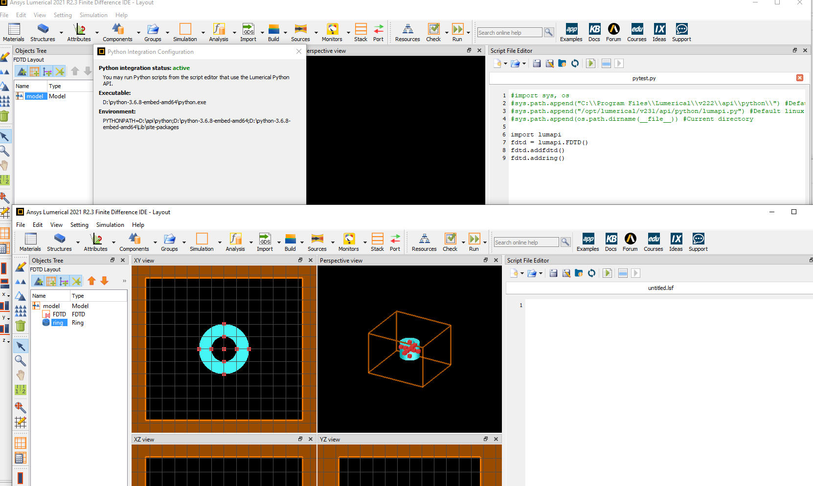

      Thanks Lito, I think we are getting somewhere close to solving this. I have two questions.
      a) Firstly, I have not enabled "Use python provided by lumerical option". So the Python exectuable path is located in my usual python folder installed in my machine. When I enabled this option, the executable path is located in a folder named "python-3.6.8-embed-amd64" in my D drive. This is not like your path which is in Programfiles directory of C-drive. Not sure, how I got this folder into my system though?
      Now, when I run the simple pytest script, it works fine. I get a new FDTD opened up with a ring in it. This is as expected.
      b) The goal is to use an external IDE (like Spyder/Visual code) to interface with FDTD. It still does not work. Do you think it has to do the interpreter path? The IDE like Spyder/VScode were installed in a bundle with Anaconda. So the python interpreter used is the default python.exe from conda. Anyway, I tried three different inerpreter paths:
      D:\python-3.6.8-embed-amd64\python.exe
      C:\Program Files\Lumerical\v222\python-3.9.9-embed-amd64\python.exe
      C:\ProgramData\Anaconda3\python.exe
      I still end up getting the error.

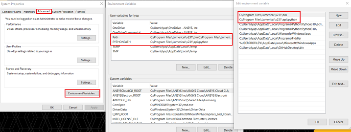

      To run outside the CAD/GUI, you will have to add the API and Lumerical install path into your environment (PATH / PYTHONPATH). Your "Anaconda" should already be in your environment. Similar to the screenshot/image, my Python3 installation is already in my environment. I simply added the Lumerical install and API path into my environment. Ensure that the required modules to run our API is installed on your Anaconda/Python installation.
      >>> Create or modify environment variables in Windows – Ansys Optics
