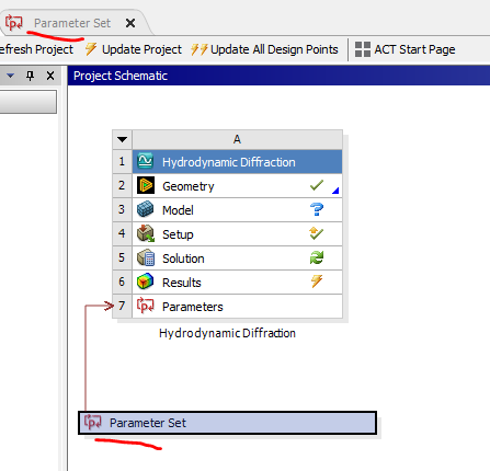

SubscriberHello,when we want to compare different configurations of moorings ,is it possible at ansys aqwa or do we have to make the same procedure every time first at the workbench?I mean do we need to create new files for other mooring configurations?And...which is the difference of making the geometry at designmodeller from making it at spaceclaim?
April 12, 2023 at 3:37 pm
Yu Bi
Ansys EmployeeHi, you can set up parametric analysis for different configurations of moorings. Click the square box before the configuration parameters you would like to change, there will be a "P" appear in the box, and then in Workbench Project Schematic, you can open the parameter set to do parametric analysis.
DesignModeller and SpaceClaim are two different tools. The ways to use them are different, but the requirements for geometry generated for Aqwa are the same, e.g. surface body without thickness, etc.Â

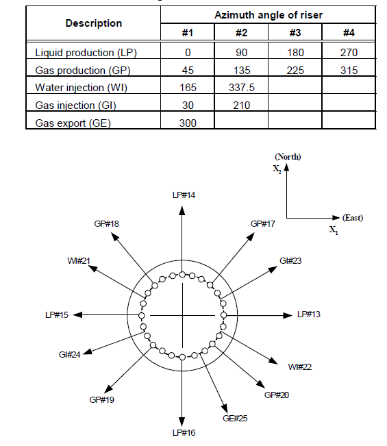

Hello again.Thank you for the answer.When i say different configuration,i mean different cases of layouts .For example …case 1:parallel moorings for a structure…case 2:perpendicular moorings for the same structure .Or different number of moorings for the same offshore structure.What parameter should i use in this case? …Is it possible to plot graphs of all(for example 3-4 different cases) cases at one diagramm?
Thank you again!
April 18, 2023 at 3:52 pm
Yu Bi
Ansys EmployeeYou need to start a new Aqwa model for each of those mooring configurations. AqwaGS can draw and merge the results of different models in one diagram.
