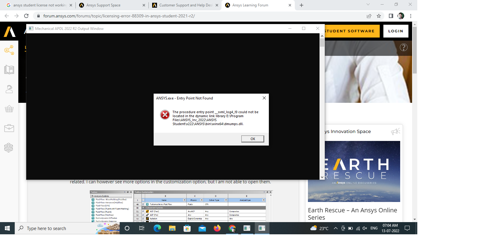

      I have downloaded ANSYS 2022 R2 student version from ANSYS. After installing it, when i trying to start ANSYS Mechanical APDL, it is showing a error "The procedure entry point_svml_hypot4_19 could not be located in the dynamic link library E:\Progem File\ANSYS Student\v222\ANSYS\bin\winx64\Cadoekernel.dll" when i click ok it started to show the similar error with "cadoe_algoriths.dll" , "Cadoelegacy.dll" and so on..... I could not able to start the Workbench solver module also.
      I have tried to reinstall with some other drive, Disable anti virus. But nothing helped me. Can any one please resolve this issue. Attaching screen shot.

      Could you please try copying the file E:\Program Files\ANSYS Student\v222\tp\IntelCompiler\2019.5.281\winx64\svml_dispmd.dll and other .dll files from this directory to E:\Program Files\ANSYS Student\v222\ansys\bin\winx64
      Thanks
      • mdmech.mech
        Thank you very much sir, Now It is working fine☺️
