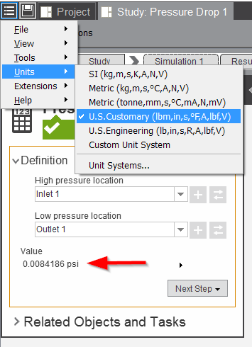

SubscriberAm using ansys aim for finding FLOW COEFFICIENT. so i want to convert pressure unit from pa to psi , and mass flow rate kg/s to us gallon per min. How can i convert those units in ansys aim.

thanks for your replay. can i use expressions or calculated value for unit conversion

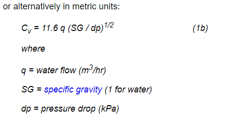

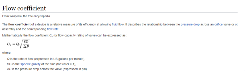

The flow coefficient is GPM (US gallons per minute) that a valve will pass for a pressure drop of 1 lb/in2 (psi).
Using the above formula, the expression in AIM can be written as follows:
The units obtained from this calculation are correct as per the definition of flow coefficient.

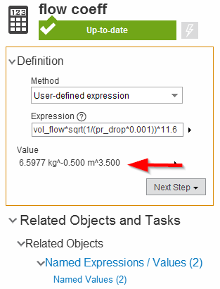

my mass flow rate=53.688kg/s=850.95 us gallon per min(kg/s and bar is my ansys aim result)
pressure drop=1bar=14.5038 psi
CV=Q*sqrt(1/dp)=223.44Â Â (it is hand calculation)
i need this value or more or less equal to this valueÂ

You will have to use expressions like the one mentioned below:
First, calculate volumetric flow rate as follows:
Volumetric flow rate = mass flow rate (kg/s)/density (kg/m3)*conversion factor
where conversion factor =Â 15850.323 (1 cubic meter/second = 15850.323 141 gallon/minute [US])
This will give the value of volumetric flow rate i.e. Q in us gallon per min, although the actual units returned by AIM will be different and should be ignored in this case
Now, Cv = Volumetric flow rate*sqrt(1/dp(psi))
Again, you will have to ignore the units that you get in the above expressions.
