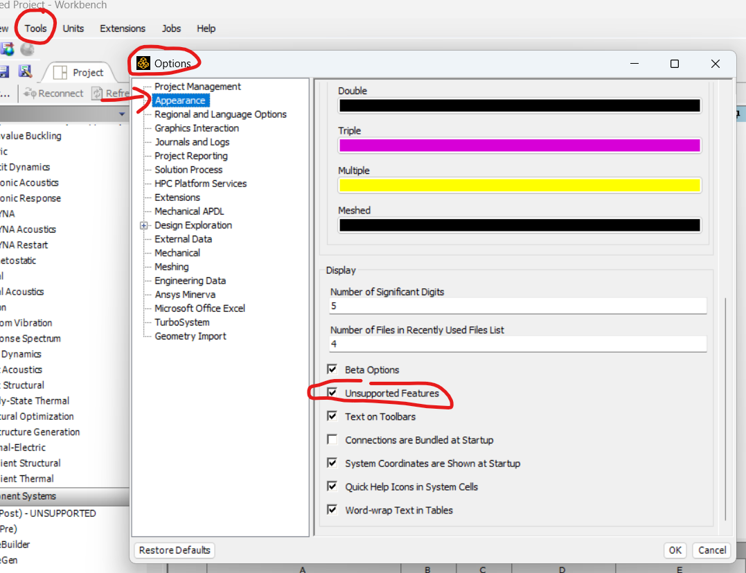

SubscriberPlease clarify:
What does this mean "unsupported" ? -
March 6, 2026 at 10:52 am
Rob
Forum Moderatorhttps://ansyshelp.ansys.com/public/account/Secured?returnurl=/Views/Secured/corp/v252/en/wb2_help/wb2h_optionsappear.html
March 6, 2026 at 11:07 am
valerym.m5
SubscriberDear Bob
thanks a lot !

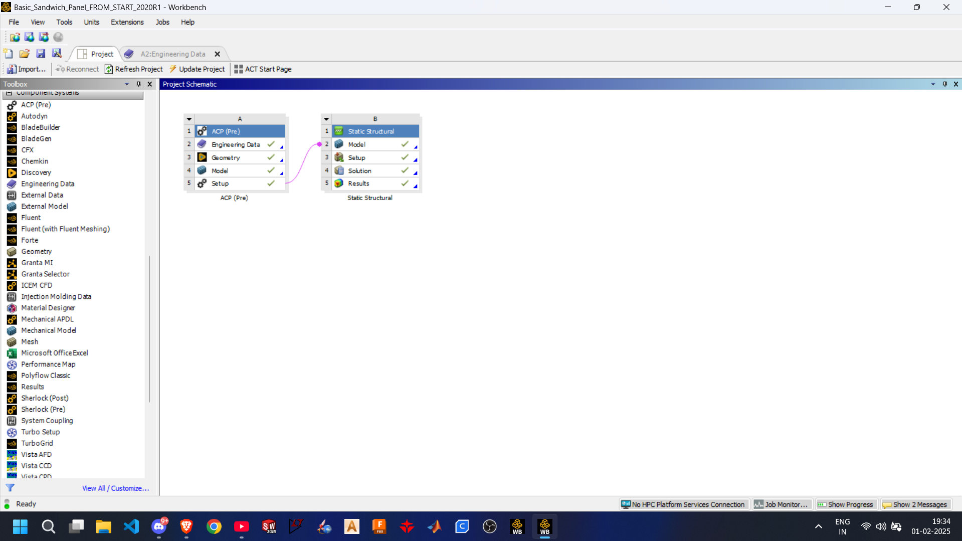

SubscriberHi. My Ansys, 2026 R1 (and 2025 R2) student version, appears ACP Post Unsupported.
I try to run a simulation of a simple shaft of the race car of the students.
ACP Pre run ok, Statistic Structural run as well to, but ACP Post do not run.
Someone can help me?
Best regards.
