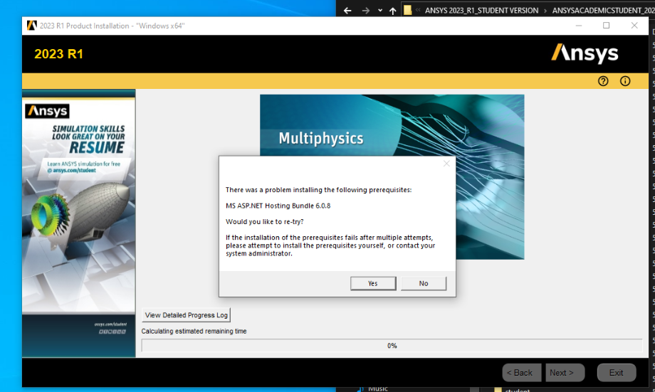

May 8, 2023 at 4:57 pm
May 8, 2023 at 7:08 pm
peteroznewman
SubscriberYou should try searching Google with the phraseÂ
install ms asp.net hosting bundle 6.0.8
and you will find the solution.
May 10, 2023 at 3:19 am
VJ
Ansys EmployeeYou can try to reinstall the prerequisite, but if you continue receiving the same message and are not experiencing problems when running the ANSYS 2023 R1 products; the problem is just during installation, these errors can probably be safely ignored. The .Net 6.x was just released in early November and it's possible the detection logic we have in the installer is not expecting this more recent version of Ansys. -
May 10, 2023 at 9:13 am
nellaiapperanand
SubscriberThanks for the reply VijayÂSolved the issue by Enable IIS on windows & updating from .net 6.0.8 to dotnet-hosting-6.0.16-winÂANSYS_2023_R1_student version working now ?-
May 10, 2023 at 12:34 pm
VJ
Ansys EmployeeAwesome! thanks for sharing.Â
