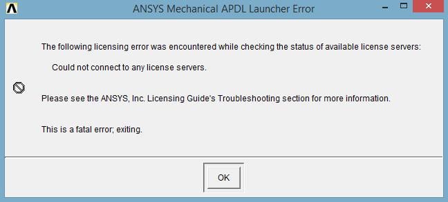

Ansys EmployeeHi,
The licensing key for our Student products is built into the download, so if you've followed the installation instructions correctly you shouldn't see such an error - This indicates that your license file hasn't been identified/and or you've inadvertently installed the ANSYS License Manager. If you have other any other versions of ANSYS product installed, or a very early version of the Student Product (Release 17.2 or earlier) then you will likely have the full ANSYS license manager installed.
To correct this problem you need to uninstall the license manager and the R19.0 ANSYS Student product, reboot your machine, then re-install the ANSYS Student R19.0 Product. See here for the solution, scroll down the thread to see Peter Newman's verified answer.
February 9, 2018 at 6:50 pm
maniraj5
SubscriberHi,
Thanks for your answer...
I uninstalled my old ANSYS software successfully. But, i can't uninstall or remove ANSYS license manager completely.. How can I uninstall or remove the ANSYS License manager from my pc.
February 10, 2018 at 5:14 pm
February 12, 2018 at 2:42 pm
peteroznewman
SubscriberUninstall all ANSYS from the computer.
You have to extract the files from the zip file for ANSYS Student 19.0 into a folder on your C: drive.
In Windows Explorer, type %AppData% in the path field. You will be in the Roaming directory. Delete the Ansys folder, then go up a level and down to the Local directory and delete that Ansys folder too. Finally, if there is any Ansys folders under C:Program Files, delete those.
After uninstalling all ANSYS, manually use regedit to delete:
- HKEY_CURRENT_USERSoftwareANSYS
- HKEY_CURRENT_USERSoftwareANSYS, Inc.
- HKEY_LOCAL_MACHINESOFTWAREANSYS, Inc.
Restart your computer. If you can turn off your anti-virus during the installation, that may help.
