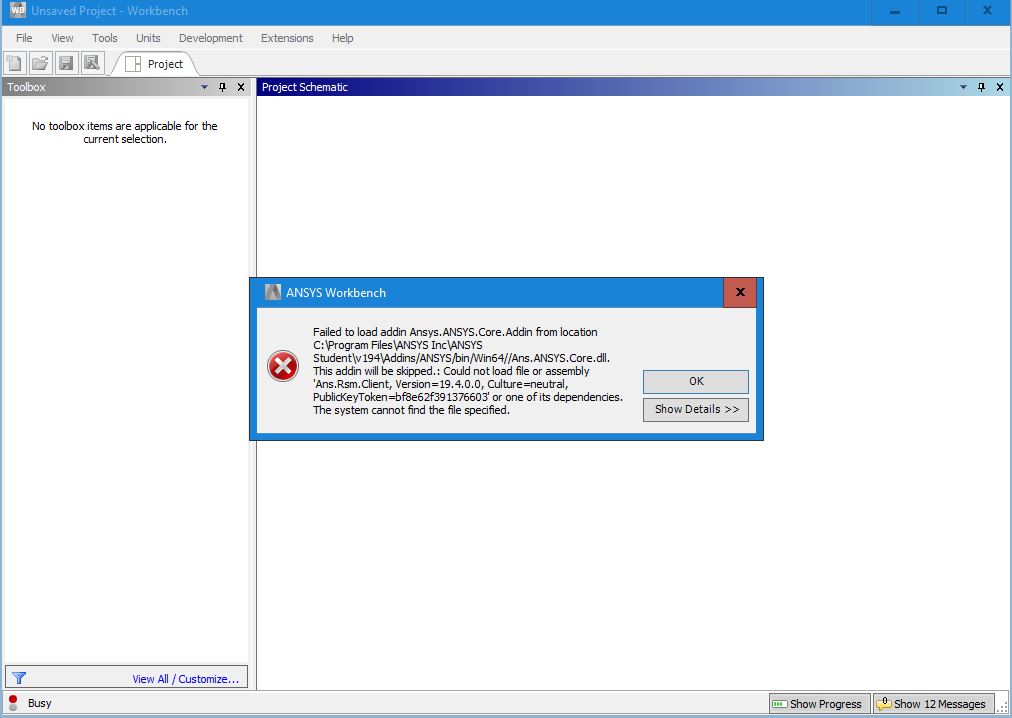

      I downloaded the student version from the site. After extracting the set up I installed it with admin privilege. I am unable to  open both workbench & apdl. Getting an error. There is text file generated in C:Program FilesANSYS IncANSYS Student path which says  couldn't execute "C:Program FilesANSYS IncANSYS Studentv194RSMbinAnsConfigRSM.exe": no such file or directory. So help me out here, how to resolve this issue?

         ###### Error #######
       What does it mean? & How to resolve this issue?

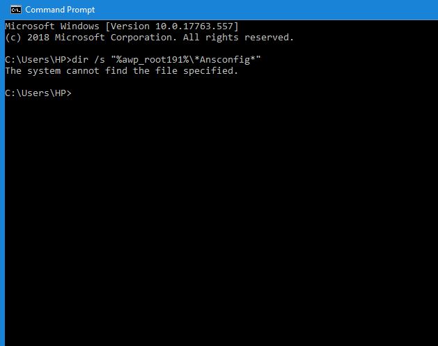

      Do you have any security software like Firewall, Anti-virus, etc. ? If so, make sure you try reinstalling it while those are disabled.
      Also, open the CMD Prompt, and issue the following command
      dir /s "%awp_root191%*Ansconfig*"
      then post the output of it here.

    • rhishib
      I do have Anti-virus which i disable during the installation. After using the above command in CMD Prompt, I;ve got the following attached output. I've also attached the error I am getting while trying to open Workbench. I am able open APDL without any difficulty.

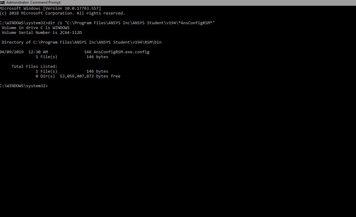

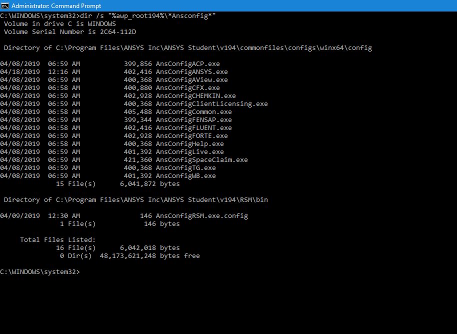

    • tsiriaks
      Sorry, I forgot that you are using 19.4 (2019 R2) , please use this command instead.
      dir /s "%awp_root194%*Ansconfig*"

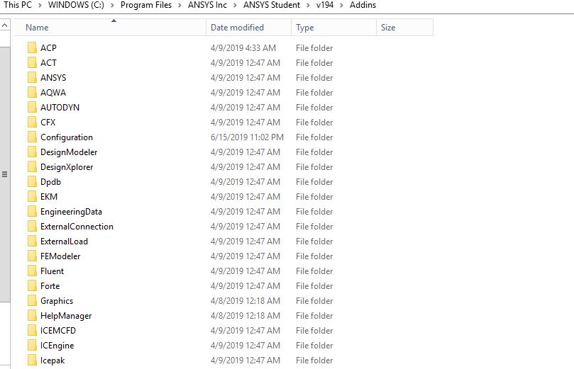

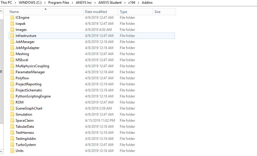

      but your installation seems to have a lot of files missing, especially those used with Workbench.
      Could you post the entire content of your C:Program FilesANSYS IncANSYS Studentinstall.log  file ?
      Also, right click on the installation package that you used (after unzipped) , then 'Properties' and post the screenshot of it here.

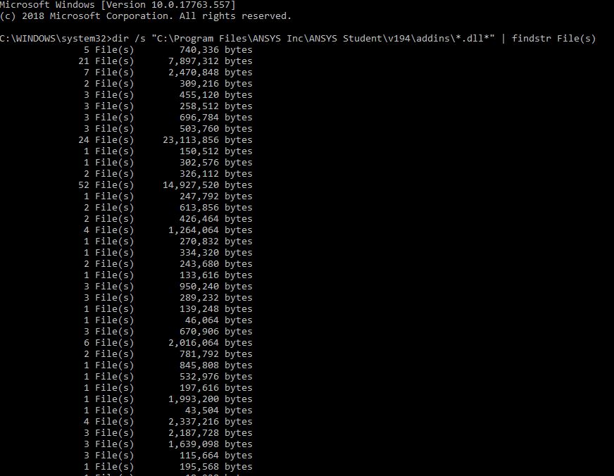

    • tsiriaks
      Also, one more thing, can you check how many files are missing when you launch Workbench, like this thread
      /forum/forums/topic/workbench-start-errors/
      chances are that you still have something on the machine that interferes with the installation.

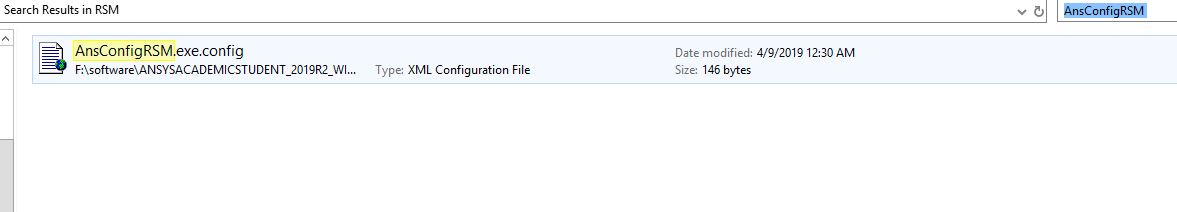

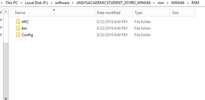

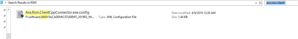

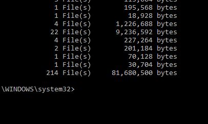

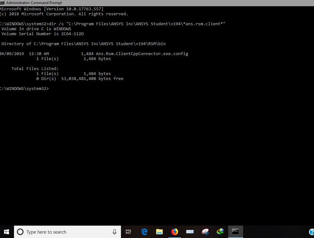

    • rhishib
      Thank you for your response. After running the command in CMD the following outcome appears on screen

      You must be missing some dll files under certain folders. Can you run the following command
      dir /s "C:Program FilesANSYS IncANSYS Studentv194addins*.dll*" | findstr File(s)
      then post the screenshot of the output
      Thanks,
      Win
    • rhishib
      No dll file exist on this path, all folders.
    • tsiriaks
      Can you show the output of this from the CMD Prompt
    • rhishib
    • tsiriaks
      Hmm, they seem to be there.
      From the error message in Workbench, can you click 'Show Details' , then copy and paste the entire text message here ?
      Do you get the same errors if you open Workbench with 'run as admin' ?
    • rhishib
      Yes, I get the same message when I open Wokbench as admin & without admin too. The message after clicking show details is as follows-
      System.IO.FileNotFoundException: Could not load file or assembly 'Ans.Rsm.Client, Version=19.4.0.0, Culture=neutral, PublicKeyToken=bf8e62f391376603' or one of its dependencies. The system cannot find the file specified.
      Fusion log:
      WRN: Assembly binding logging is turned OFF.
      To enable assembly bind failure logging, set the registry value [HKLMSoftwareMicrosoftFusion!EnableLog] (DWORD) to 1.
      Note: There is some performance penalty associated with assembly bind failure logging.
      To turn this feature off, remove the registry value [HKLMSoftwareMicrosoftFusion!EnableLog].
      Call stack:
         at System.Reflection.RuntimeAssembly.GetExportedTypes(RuntimeAssembly assembly, ObjectHandleOnStack retTypes)
         at System.Reflection.RuntimeAssembly.GetExportedTypes()
         at Ansys.Core.Commands.Core.Registry.FindAllCommandTypesInAssembly(Assembly assembly, Boolean includeInternal)
         at Ansys.Core.Commands.Core.Registry.RegisterTypesFrom(Assembly assembly, Boolean includeInternal)
         at Ansys.Addins.Infrastructure.Utilities.LoadTimeInitializer.RegisterCommandsAndQueries(AddinLoadContext context)
         at ACP.Addin.Load(AddinLoadContext context)
         at Ansys.Core.Addins.AddinManager.setupAddin(String path, String name, AddinBase addin)
         at Ansys.Core.Addins.AddinManager.LoadAddin(String name, String path)
    • tsiriaks

      what is the output of this
      dir /s "C:Program FilesANSYS IncANSYS Studentv194*ans.rsm.client*"
      also this
      dir /s "C:Program FilesANSYS IncANSYS Studentv194*AnsConfigRSM*"
    • rhishib
    • rhishib
    • tsiriaks
      ok, so even the manual extraction still have files missing.
      Go to your 'RSM' folder from this step
      "F:softwareANSYSACADEMICSTUDENT_2019R2_WINX64rsmWINX64.7z  , then manually extract this using any unzip tool. You should get 'RSM' folder. "
      How many files do you have in 'RSM' folder after unzipping WINX64.7z ?
      Also, search inside that 'RSM' folder for keywords 'ans.rsm.client' and 'AnsConfigRSM'
    • rhishib
      Afrer manual extract, I found 3 folders in RSM folder.
    • rhishib
      After searching inside that 'RSM' folder for keywords 'ans.rsm.client' and 'AnsConfigRSM' I found 2 files as follows
    • tsiriaks
      Your extraction really missed some files. There's supposed to be, at least, AnsConfigRSM.exe in

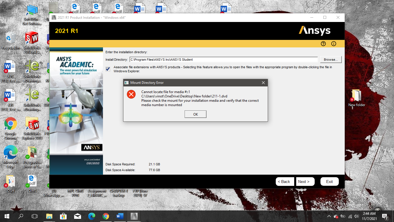

    • Vinotharan
      HI, i download student version 2021 r1 ,
      Try extracting the downloaded file into somewhere that's not OneDrive. We've had some issues with that as it adds random characters etc into paths.
