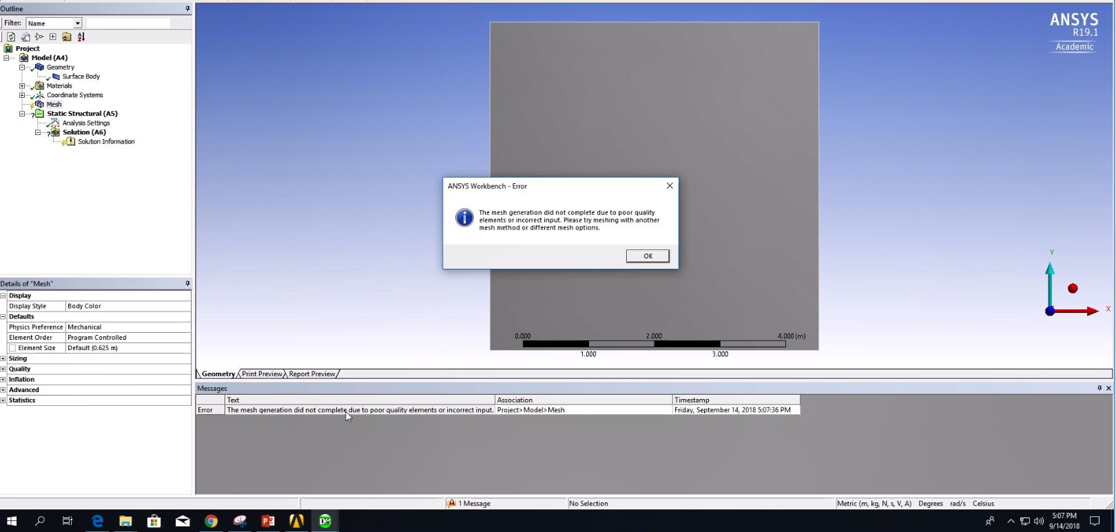

    • luizjr0
      I am having the same problem with Ansys 19.1. I tried to reinstall the prerequisites as DavidYakinian suggested but the problem persists. I cannot create the mesh even with a very simple geometry.

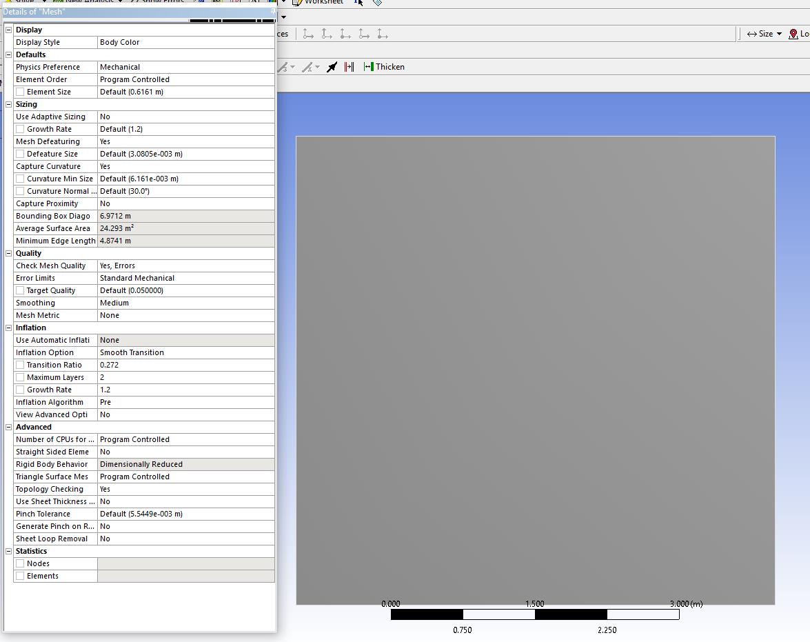

      Can you please post some snapshots of all the Details of "Mesh"? Expand everything, Sizing, Quality, Inflation, Advanced and Statistics?
      This is a very rare problem and it is hard to debug as we are unable to reproduce it, If you are at a university have you tried on a different computer or even a friends computer (please make sure you use the same ANSYS download)? This is not a fix but might get you going and eliminate any problems with the installation file.
      Lastly, can you please provide complete details of your machine, configuration etc?

    • luizjr0
      SandeepMedikonda please find below the link for the video on youtube.
      I will take some more snapshots later with the mesh details. This problem happens with any mesh. In the case of the video, I am trying to generate a simple default mesh.
      Yes, I am at a University and this problem is happening in all the computers that have the 19.1 version installed that I tried (4 different machines).

      SandeepMedikonda, Please, see below the details of the mesh (everything on "Default"). The machine I am using has the following configuration:
      Intel Core i7-4790 CPU 3.60 GHz
      Installed memory (RAM): 8.00 GB
      System: Windows 10 Enterprise x64
      I am writing from the University of Nevada, Reno.
      The problem occurs in the 19.1 version only. The computers with previous versions installed (18.2, 18.1, or 17) do not present the error.
