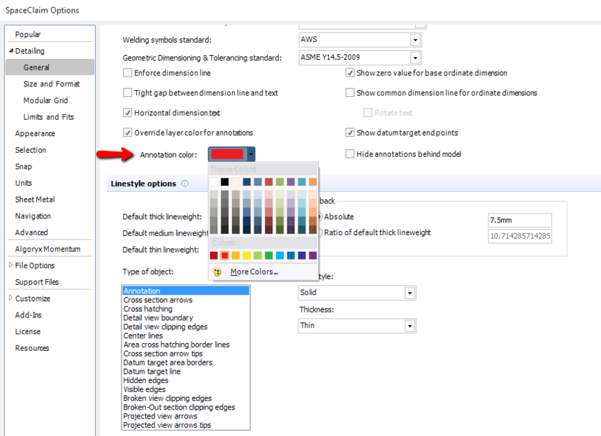

December 6, 2018 at 10:00 am
December 6, 2018 at 10:17 am
Francois Fosse
SubscriberThanks Naresh.
As far as I understand this is global default parameter. Can I have different colors on same sheet. Please confirm. My need is to have default color on some annotation then red color on another one. -

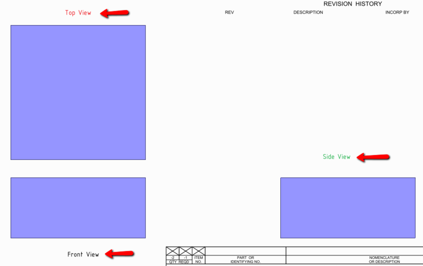

December 6, 2018 at 10:44 am
Naresh Patre
Ansys EmployeeHello Francois Fosse
Though it is a global parameter, its not a default one. For example, if you create an annotation text with black color, then go to the options panel and change the color to red. Now any new annotation that you create will have red color. If you again change it to some other color, the next annotation will have that color. See below image which shows annotation texts in 3 different colors created on the same drawing sheet.

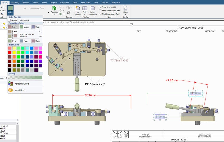

December 6, 2018 at 10:16 pm
Ethan Geometry Rabinowitz
Forum ModeratorFrancois Fosse Also, if you go into the text field, select the text and change the color in the same way, it will not change the leader color. This works on only 1 annotation at a time.

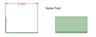

August 24, 2020 at 9:37 am
dirk
SubscriberHi Ethan Rabinowitz ,
This reply is on behalf of Devy van Dinteren .
What we would like to see in SpaceClaim is an additional default color for the Dimensions.
See the example below, if the default annotation color is black and the default dimension annotation color is red, the resulting drawing sheet would look like this.I will add this in the forum Ideas section so people can vote.
