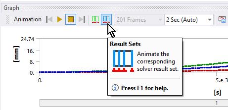

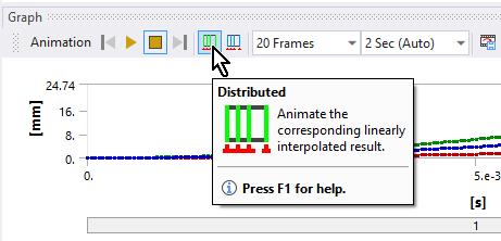

      I don't clearly understand your question. Please use the Insert Image button to add a screenshot of the two parts in relation to the ground. Please show a screenshot of a frame of each animation that shows the difference you ask about. The animation tool has two settings, Result Set and Distributed. Which one did you use?
