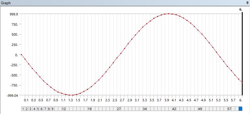

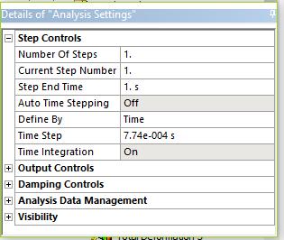

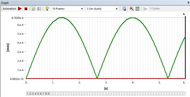

SubscriberSorry for the late response. I have made a little change. I have added a sinusoidal time-dependent force of magnitude 1000sin25132.7*t where 25132.7rad/s is my rot vel. I got 2 peaks within the range of 6s but these two are of same amplitude rather than decreasing amplitude. To get a stable system I need the amplitude should be is in decreasing order. What will I do to get the desired result? below is my analysis settings, force graph, and the graph of total deformation.
graphical representation of force:
graph of total deformation wrt time:
