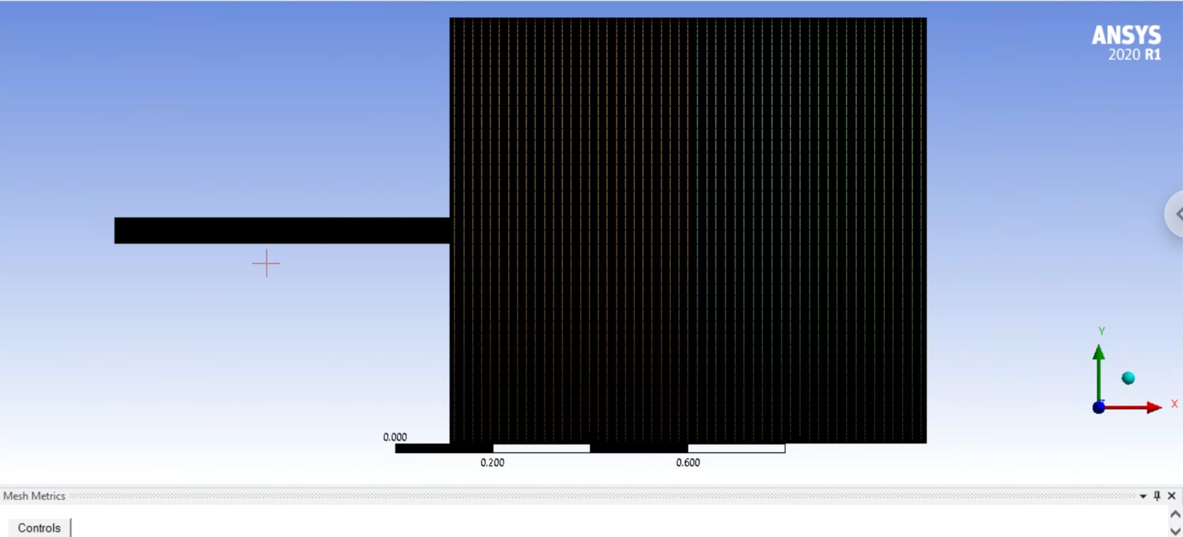

      And I have one more question. I am using explicit formulation with explicit transient formulation to simulate the shock wave in shock tube using inviscid model. but the residuals are not going below 10^-1. Here I attached the photograph of the residuals vs iterations. So, can I consider this solution as converged one. Can I trust this solution?? How can I make sure that it is converged??
      Thank You.
      Prem
    • YasserSelima
      Definitely not converging.
      How does your mesh look like? Are you using density solver? your time step?
    • Prem1996
      Yes I am using density solver. And here I am attaching few photographs which shows the geometry and mesh. max skewness is 0.4246 and min is O(10^-3). Min orthogonal 0.905 and average orthogonal is 0.9987.
      thank you.
      regards
      prem
    • Prem1996
      And yes I just used the courant number 0.5 instead of the time step size.
      thank you
      Regards
      prem
    • YasserSelima
      Hi Array
      I don't see your mesh causing this large residuals. They are slightly large but I don't think they case this issue. and 0.5 Global Courant number is good.
      Not sure what is the issue
