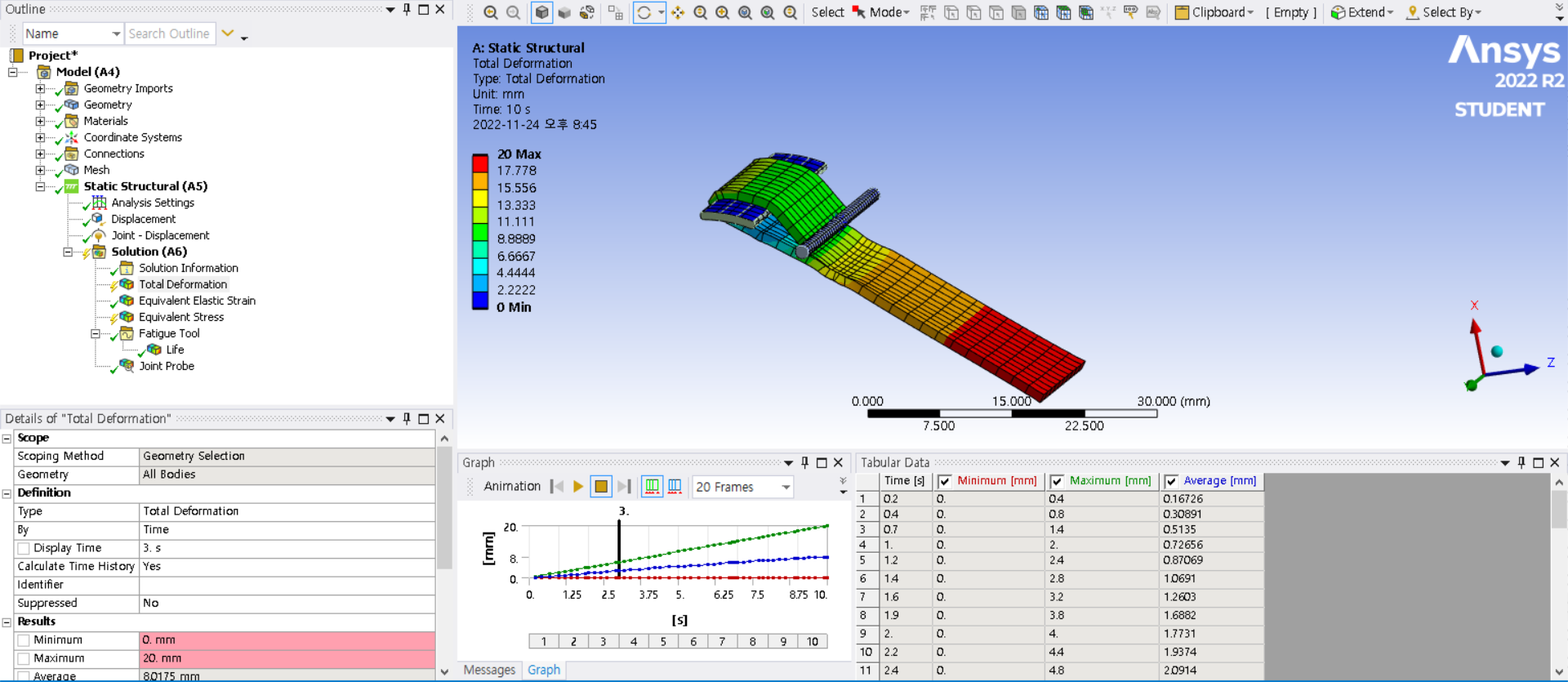

SubscriberI made a ansys model like V-belt.ÂI want to know fatigue life or stress applied to pully object ( rigid object ).ÂBut In ansys, Flexible bodies must be on the contact side(in this case, A belt) and ansys shows only result of contact side. (without total deformation)ÂHow to know fatigue life or stress of pully While the belt is spinning?Âplease help me....?ÂÂ -

SubscriberI don't see a pulley or a V-belt in the image you show above, but I will ignore that and answer the question you wrote.
Fatigue is based on cycles. One cycle of stress occurs on each revolution of the pulley. The cyclic stress comes from the tension in the V-belt applying a lateral force to the pulley. A simple way to get the fatigue life of the pulley (and shaft!) is to model the pulley and shaft as flexible bodies. Apply the lateral force to the pulley and ignore the fact that it is spinning. You have SN curves defined for the material of the pulley in Engineering Data, which is required. In the Fatigue tool, it should be configured for Fully Reversed Load Ratio to account for the fact that the lateral force pulls then pushes as the pully rotates relative to a fixed point on the pulley. The Life plot is then read as number of revolutions to failure.
November 24, 2022 at 12:58 pm
byenogwu son
SubscriberFirst thank you for answering?
Then I wonder that can i know stress or fatigue life of that wide-flat pully in that image?
(the red one is pulling side, the green one is pushing side and it is rope)
i'm forward to your reply and thank you for your answering again??
