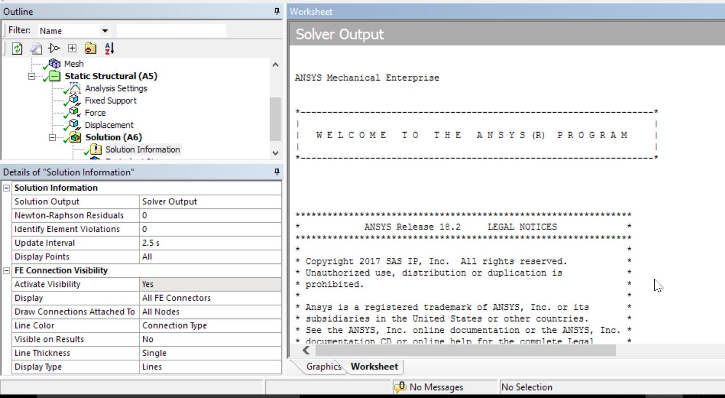

      Hi! I've tried to simulate a friction stir welding process on ansys workbench 17,
      My computer has a i7 7700 HQ, 64 gb ram, but the messeage "an unknow error ocurred during solution" apeared constantly. I already check all APDL codes and the analysis settings. It could be the sub steps i defined in analysis settings? Or the Apdl?
       I use a SOLID 226 element in all the geometry, also the contact and target surface was defined in the conecctions window, this area of contact was defined witch these the apdl codes, the contact between plates.

    • Rahul Kumbhar
      Hi Luis,
      Click on Solution Information, go to Solution Output. In this window use ctrl+F and search "error" / "warning" for detailed messages. It may help to pint at correct section of the code where APDL is failing.
