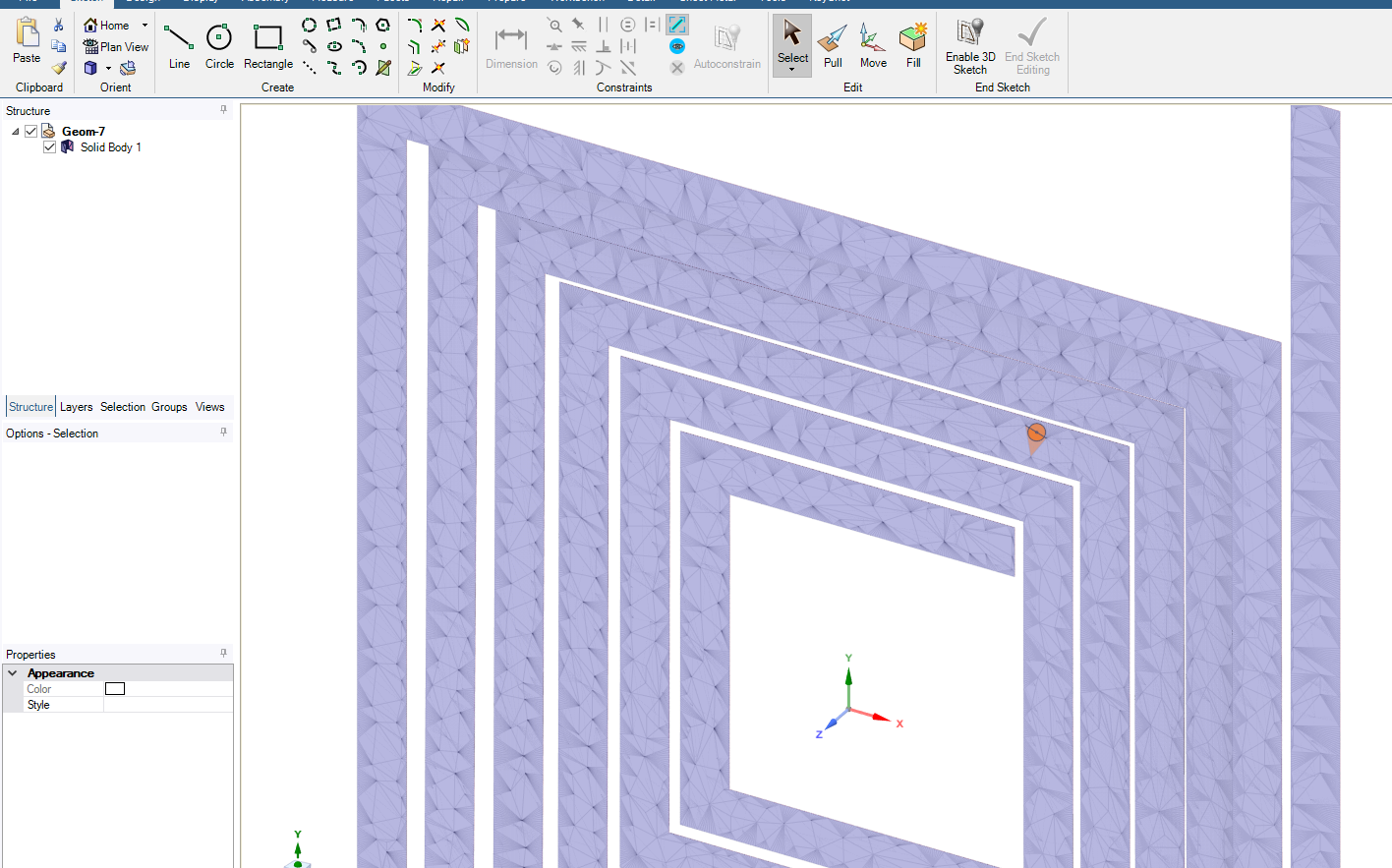

      So I have a spiral design. Previously, I was getting a solver error which with the help of an Ansys employee, I was able to solve by changing the mesh sizing. Now, I have a different spiral design and I am getting this error(Picture 1). I would really appreciate your help with this error.
      Picture 1: Shows the geometry with the error
      Picture 2: Shows the geometry mesh and mesh size (element size =0.01)
      Thank you,
    • ErKo
      Hi
      As it says, this means that this very small structure is deforming too much under that load.
      The warning/error tells that it could be due to supports, a too large force (e.g., try and solve with ~ 1 microNewton instead) and or material properties.
      All the best
      Erik

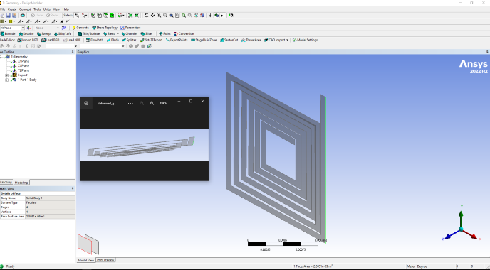

      I got the deformed geometry from static structural by exporting 1) as STP file format and 2) as pmdb format.
      1)STP format: I imported STP format file in new geometry module and bridged it to HFSS in the workbench. However, the geometry gets distorted in both Design modular and HFSS. I have attached pictures below.
      2)PMDB format: I imported PMDB format file in new geometry and bridged it to HFSS in the workbench. However, I get an error when opening the HFSS design geometry.
      Erik, I would really appreciate it if you can help me get this deformed geometry in HFSS as I have tried multiple approaches. Can I send you my files?
      Picture 1: Imported deformed geometry(0.1mm nodal displacement) in new Design Modular -PMDB format
      Picture 2: Imported deformed geometry(0.1mm nodal displacement) in new Design Modular -STEP format
      Similar distorted geometry in HFSS with STEP format.
      Picture 3: Error when opening HFSS geometry with PMDB file format.
      Thank you,

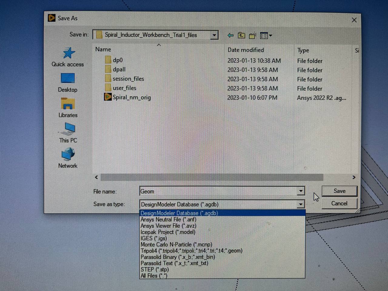

      I changed the deformation scale factor from 1.6(Auto Scale) to 1(True Scale). Then I exported the geometry as .pmdb file. I opened that file in design modeler and I tried to export it as .sat file, but I don't see that option.
      Thanks,
      Sneh

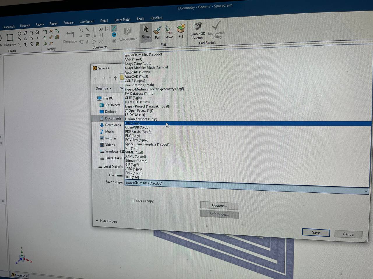

      You can do that from Spaceclaim instead (.sat export).
      Then open HFSS, and go to the main menus, and Modeler - > Import and choose the sat file.
    • Sneh Patel

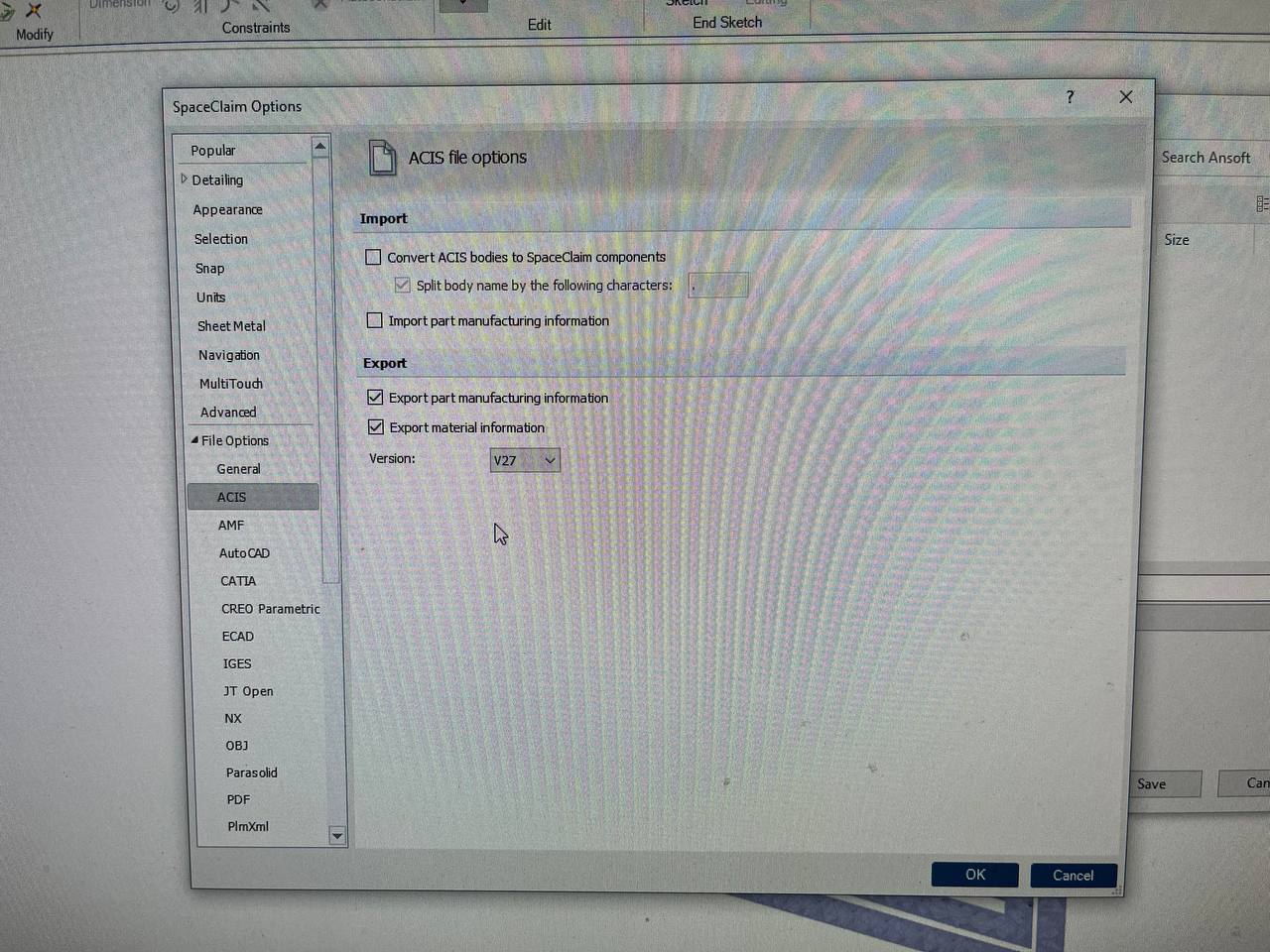

      Still I dont see an option for .sat export. I went to Spaceclaim options -ACIS (picture below).
    • ErKo
      You need to convert from stl to solid body - see this forum and the interent on how to do that. ALl the best
