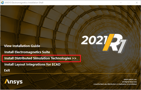

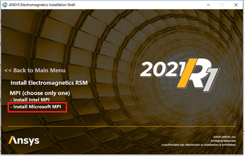

1 - Installing MS MPI from the ANSYS Electromagnetics Installation Shell (my screenshots are 2021R1 but, similar to 2021R2)
Install Distributed Simulation Technologies
Install Microsoft MPI

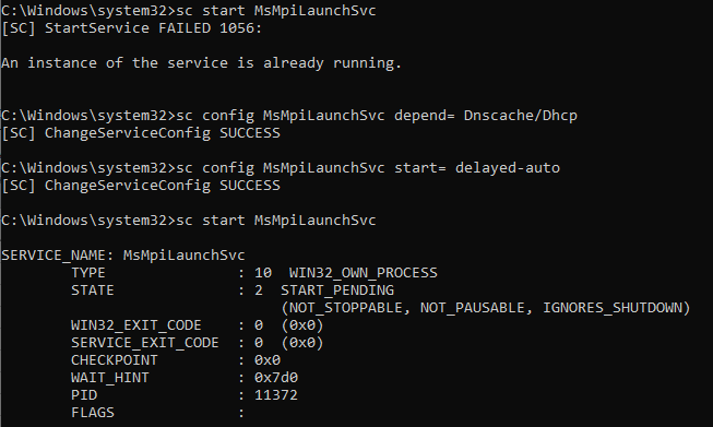

2 - Start the MS-MPI service by opening an elevated CMD(rt-click on CMD and "run as admin") and run these three commands:
sc configMsMpiLaunchSvc depend= Dnscache/Dhcp
sc configMsMpiLaunchSvc start= delayed-auto
sc startMsMpiLaunchSvc

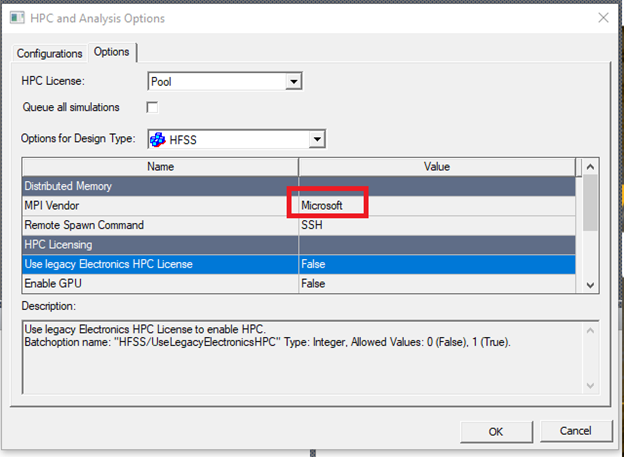

3 - set MPI type in AEDT to MS-MPI in "HPC and Analysis Options" -> "Options"

Thanks for the post. This worked very well for me, but now even the Microsoft MPI stopped working. I tried running the commands but when I run the start MsMpilaunchSvc I get a "SC StartService FAILED 1056: An Instance of the service is already running". The service appears in task manager, but HFSS doesnt seem to be able to use it properly.
I tried closing that task and rerunning the 3 commands in the previous post and I get:
with HFSS still unable to use multiple cores.
Any ideas?
Thanks
John
