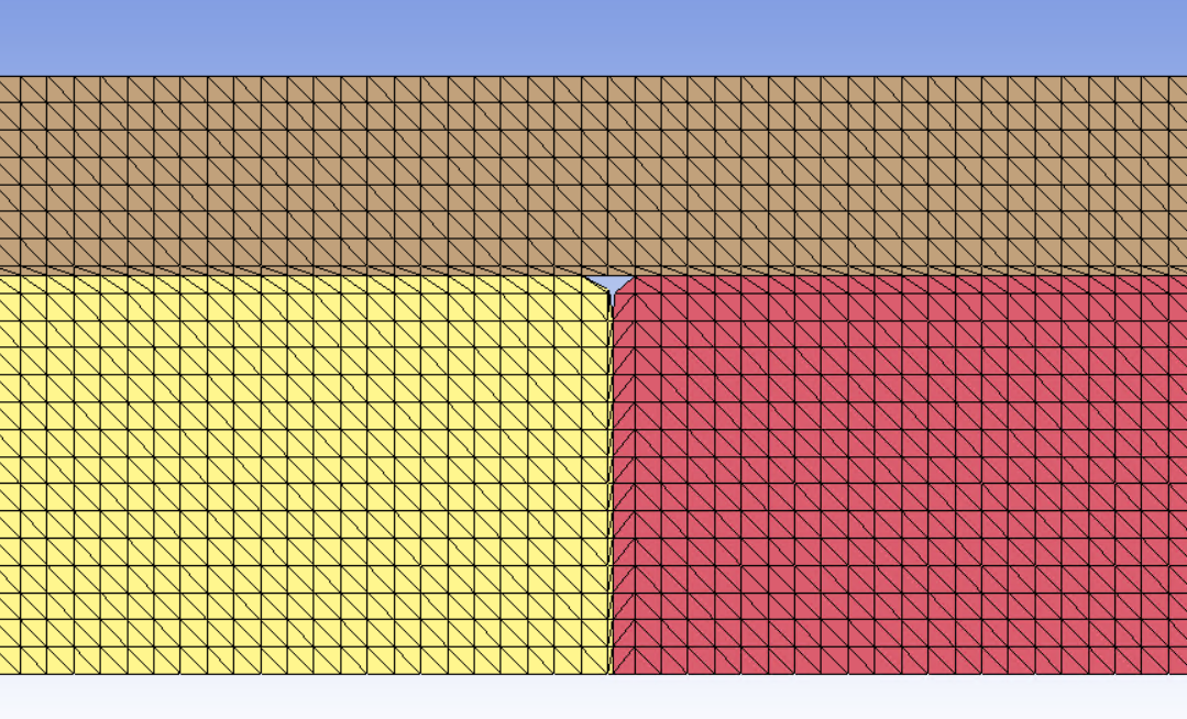

SubscriberHello, I have a model which contains water (yellow), air (brown), and water with a damping coefficient (red). The water is modelled using MAT_NULL and the air is modelled using MAT_VACCUUM. For some reason there is a blank area where the two water types meet. My process for filling the volume is as follows:
- Fill entire geometry with air
- Fill water portion using BOXCORÂ
- Fill the damped water portion using BOXCOR
The boxes are defined so that they meet at the exact same point. I have tried altering the value of NSAMPLE but it has not changed anything. I have seen S-ALE examples online and none of them appear to have this issue which I am having. Does anyone know why this is occuring?
September 12, 2023 at 4:31 pm
Ian Do
Ansys EmployeeHello Caleb,
LSPREPOST represents the AMMGs via their volume fractions. At the corner, it will reconstruct the interface, in this case, with roughly a 45 deg slanted plane. It is just an artifact. It is not wrong. The finer the mesh the smaller this gap is. If you are curious, look "Young's modified Interface reconstruction methods". It is very tricky and complex. But it does the job.
