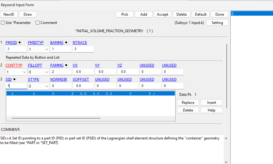

      When I am using the workbench, there is no option of ALE bodies under model. So i thought that using the LS Prepost might work. So I have imported the mesh from the workbench together with the keyword file. Then I made ALE2D and so on.
      The issue comes from material groups and used Volume fraction geometry to "patch" the bodies in the background domain. So firstly it needs some VOID parts, I have created them but it does not seem that Volume fraction geometry lets me input them. But for some reason presense of those eliminate the "cannot find void body" error. Then I am keep getting
       *** Error 21153 (STR+1153)
           Flag BAMMG = 2 specified in card *INITIAL_VOLUME_FRACTION_GEOMETRY
           is out of range. It is an ALE AMMG ID and its value should
           be greater than 1 and less than 1.
      I have tried switching the ID of the AMMG around, from 1 to 4, but it would only show up as 2, 22, or something.
      Does anyone know what is going on? ID being greater than 1 and less than 1 means it cannot be 1, but it is not 1.
      (The following pic is me putting BAMMG on 1, same error message)
      I am just confused how would you run a axisymmetric ALE simulation in ls dyna in general,

    • gl6fp
      ok guys i figured out, you have to make seprate empty parts that will become material for ale, and patch your original fill parts with vaccum.
