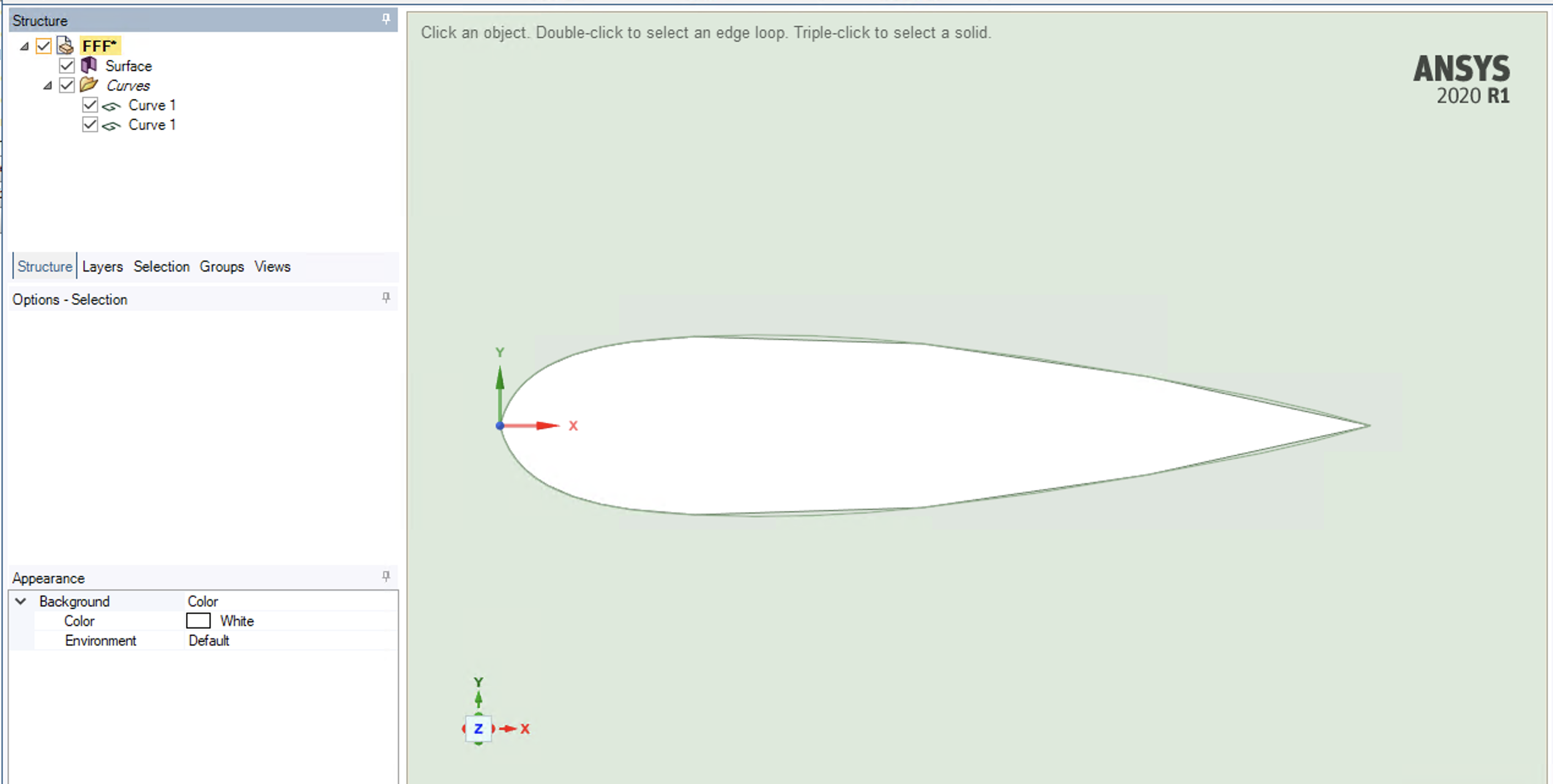

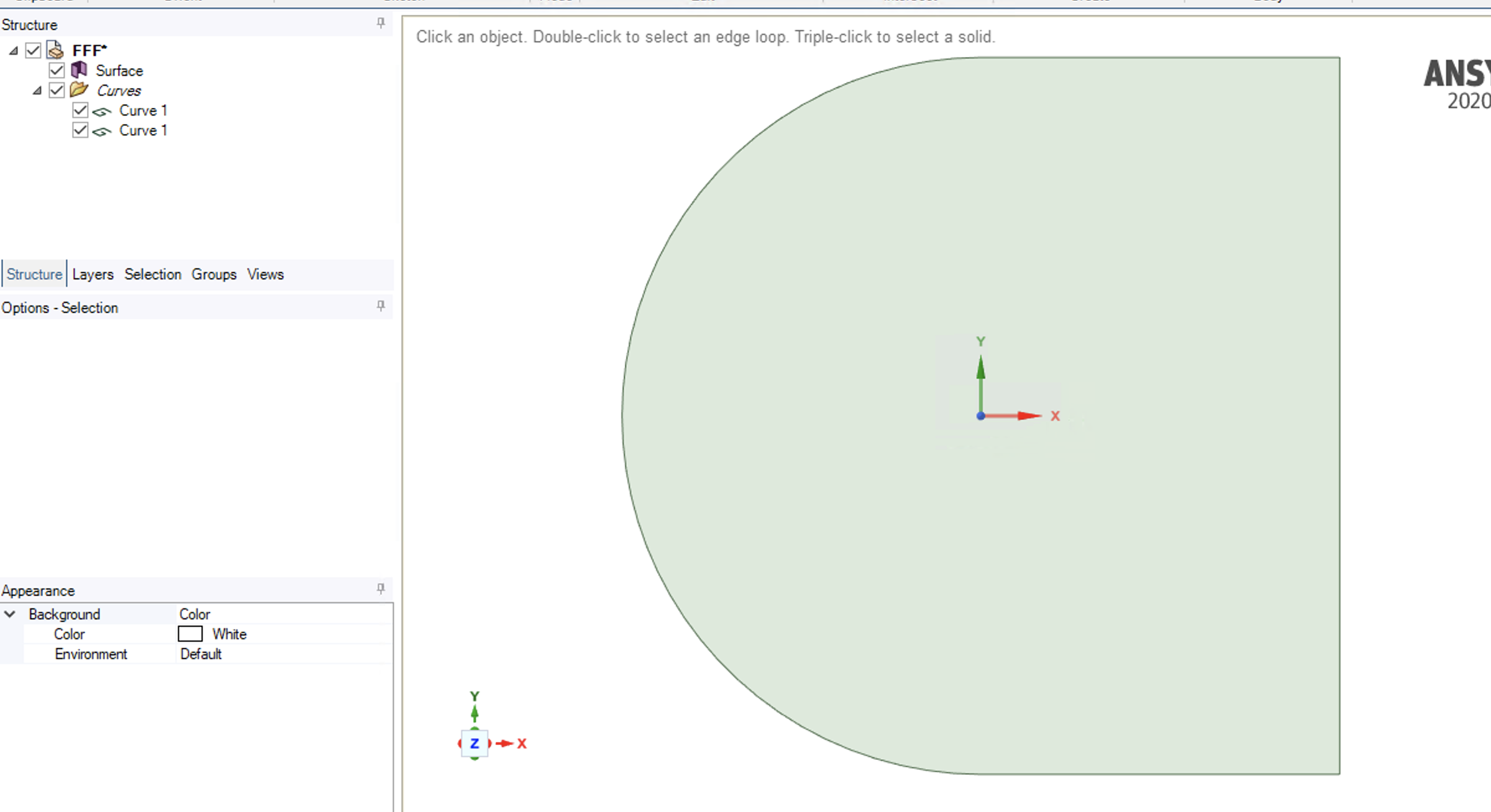

First stage I would like to know how to make the attached geometry in spaceclaim geometry. I have data for profile of airfoil. I need to know
1-how to upload the airfoil into spaceclaim
2- how to subtract the rectangular shape and airfoil
3-how to make nice meshing around the airfoil

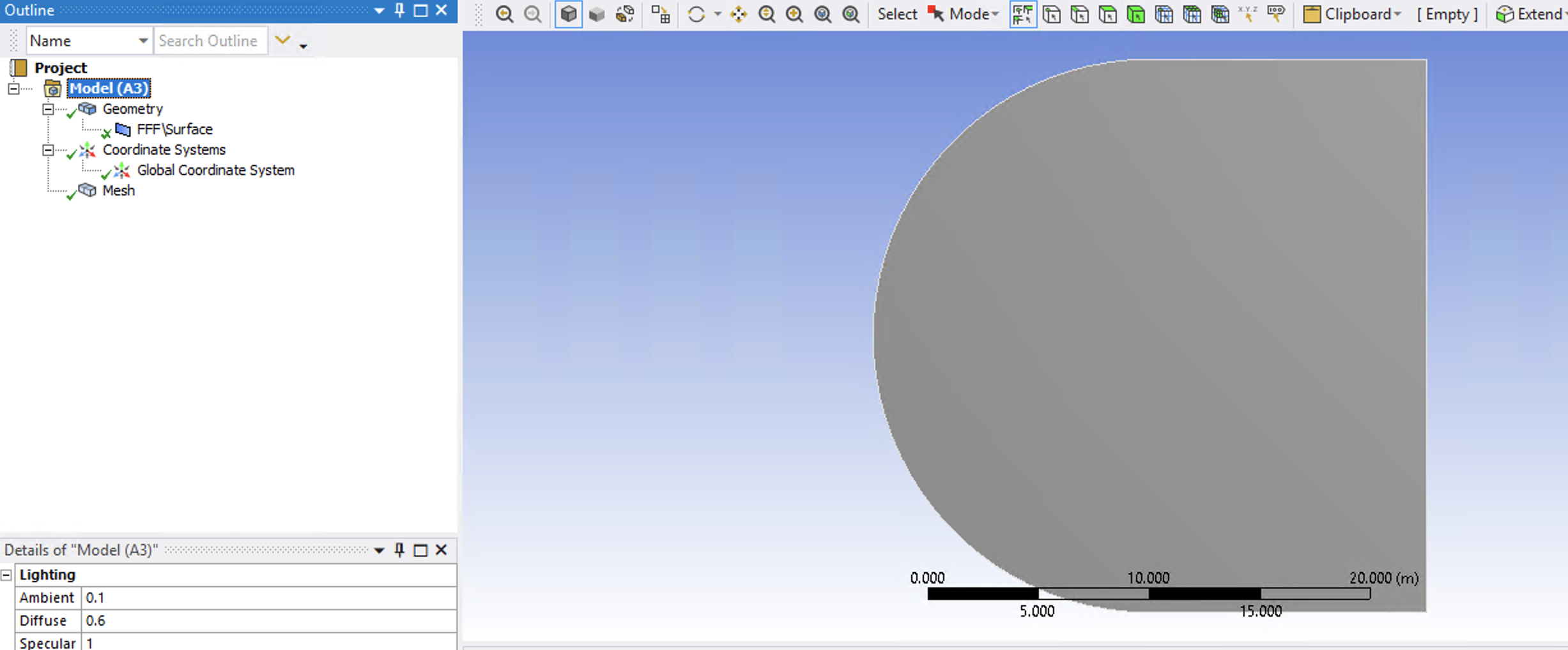

I watched the clips in youtube as you mentioned. I can upload the airfoil and i have the geometry as you can see in attached figures, but when i go to make mesh i cannot see the airfoil. i made two surfaces, one for flow field and one for airfoil, and then i delete the airfoil surface.

I sort my problems with meshing and geometry.
