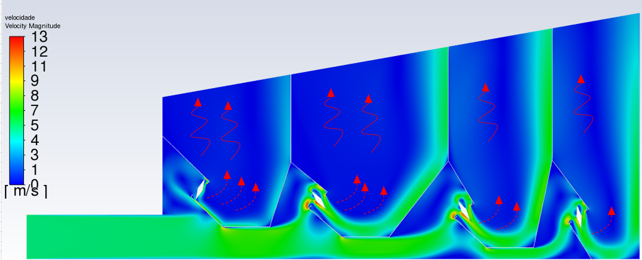

I aim to simulate forced air through ducts and evaluate pressure drop (at dampers) and evaluate the air flow distribution over the outlet region.
Outlet geometry will be studied to distribute "equally" air through plenun chambers.
After results, evaluate pressure (for diferent inlet velocities) to size the fan needed to overcome the pressure loss.
My attempt is:
1- forced air flow through dampers;
2- forced air flow through dampers + exhaust system;
Figure 1: Duct + Dampers + windbox

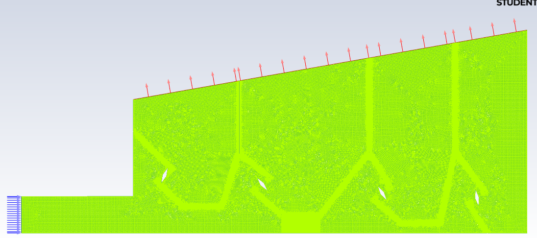

Forum ModeratorThe result looks sensible. If you push air in it'll adjust the mass flow to each section such that the pressure drop is the same. If you want a uniform extract set the inlet as a pressure boundary and use a velocity outlet (or negative velocity).

SubscriberBeing fair, i've already seen this system working, and it works together:
1 - forced air inlet (forced draft fan);
2 - exhaust air outlet (exhaust fan);

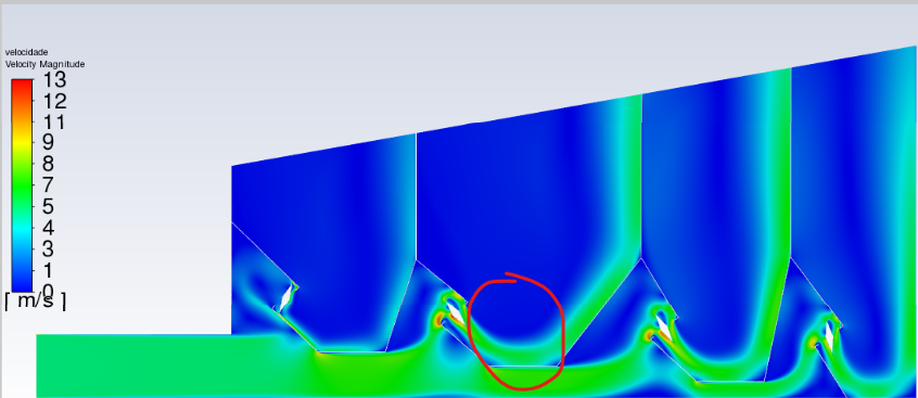

As you said, pushing air it''ll adjust mass flow to each section because of pressure drop caused by different dampers positions (flow area), but after entering each section, it should distribute air over all the chamber to, then, go out through all outlet region (edges at Figure 1 - red arrows). What i see, at Figure 4, is air flowing out near the wall only, at located region, while recirculation zone exists at most part of it, and air is comming in). Why air isn't flowing out? That's why i don't think it's right.
I aim to optimize pushing air through all exists, like choosing best damper positions (or/and flow rate or/and pressure required)
For uniform extract, i should set inlet as pressure boundary (not velocity inlet) and use velocity outlet (instead of pressure outlet). But i didn't realize how to do both together yet (push and exhaust), i believe (if it's possible) i could achieve a best air flow distribution through all edges region (red arrows - Figure 1) if it could be done. Or my setup ins't good enough.
Thank you in advance.

Forum ModeratorYou'd explained what you wanted to see, but not the why. You're actually modelling something quite complicated, and it's not covered in under-grad courses. The fact you've picked up the feature and are questioning the result is good. Why should the jet detach from the wall and spread? Have a look at the Coanda effect, and also think what's on the end of the domain, ie where does the flow go after the manifold?
April 26, 2022 at 10:59 amelisio
SubscriberSince my outlet region was supposed to be at same exhaust pressure - let's say -200mmH2O -, i'd expect air deatching from the wall and filling each section, going upwards (not recirculating) reaching a bigger chamber (which is not in domain). That's why i asked about pushing and exhaust air at the same Volume Control.
Explaining this, maybe i should extend my domain to avoid these recirculation shown at Figure 4. Rob, What would you consider wise to my case: 1- set inlet as pressure boundary or 2- set outlet as pressure boundary? 3- simulating both and check results.
By the way, what are preferential tools to avoid recirculation / making my outlet region exit? Extending domain?
April 26, 2022 at 2:11 pmRob
Forum ModeratorExtending the domain is the usual method to avoid recirculation, but you also need to consider what happens in reality. Ie if the system vents to atmosphere then you may find the real system also behaves in this way. If there's a downstream flow restriction (eg a filter) the chamber my pressurise to some extent which will even the flow out. If you check the flow split over the four sections it'll not be even, again that may well be correct.
I wouldn't use a pressure in & pressure out in this case as the solver will mass flow AND split will become part of the solution. The end result will be much as you have in the above but getting there will be painful.
April 27, 2022 at 10:41 amelisio
SubscriberI agree mass flow will be different at each section, but i am not sure about those localized outlet vectors (caused by coanda effect). I will create my restrictions at each outlet section (and extend it) to evaluate its behavior.
After all these points, i believe BC should be velocity inlet + pressure-outlet, which should works fine.

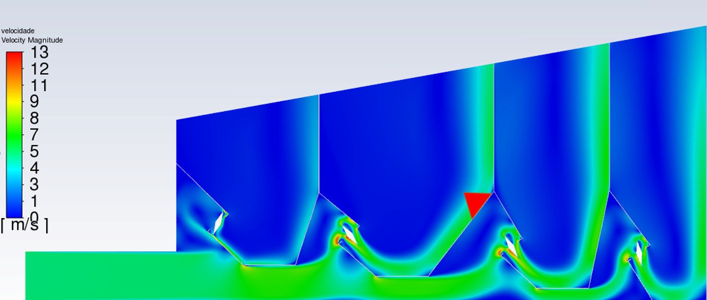

Forum ModeratorIf you want to spread the air into the manifold zones more evenly you need to look at the entry system. You're currently forcing flow to turn through the valve(?) assembly, but then not doing anything to encourage jet spreading.
May 4, 2022 at 11:06 amelisio

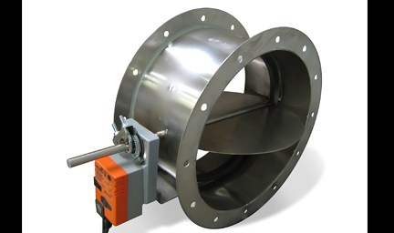

SubscriberFlow is passing through a butterfly damper (flat plat), like the image below:
As you can see at Figure 1, dampers are represented by hollow diamonds, each section has different dampers positions. Velocities are high at these restriction, it forces air flowing directly to wall (but not spreading to chamber after hitting it). I will try two ways:
1 - Setting lower/higher speeds at damper to monitor coanda's effect over the wall. By physics, theres a inflection point which it shouldn't occur anymore, right?
2 - Assembling some kind of deflectors (red triangle):
May 4, 2022 at 11:31 amRob
Forum ModeratorThere is a point where the jet won't form, but that'll be a very low speed. Jet sticking, Coanda effect etc are why certain fluidic devices work, and where my PhD supervisor spent his academic career & it's still keeping him out of (some) mischief now he's retired.
A deflector may work, as may a diffuser. That's for you to discuss with your supervisor. We (staff) are only supposed to help with the software questions.... Of course when you model it you'll find out.
