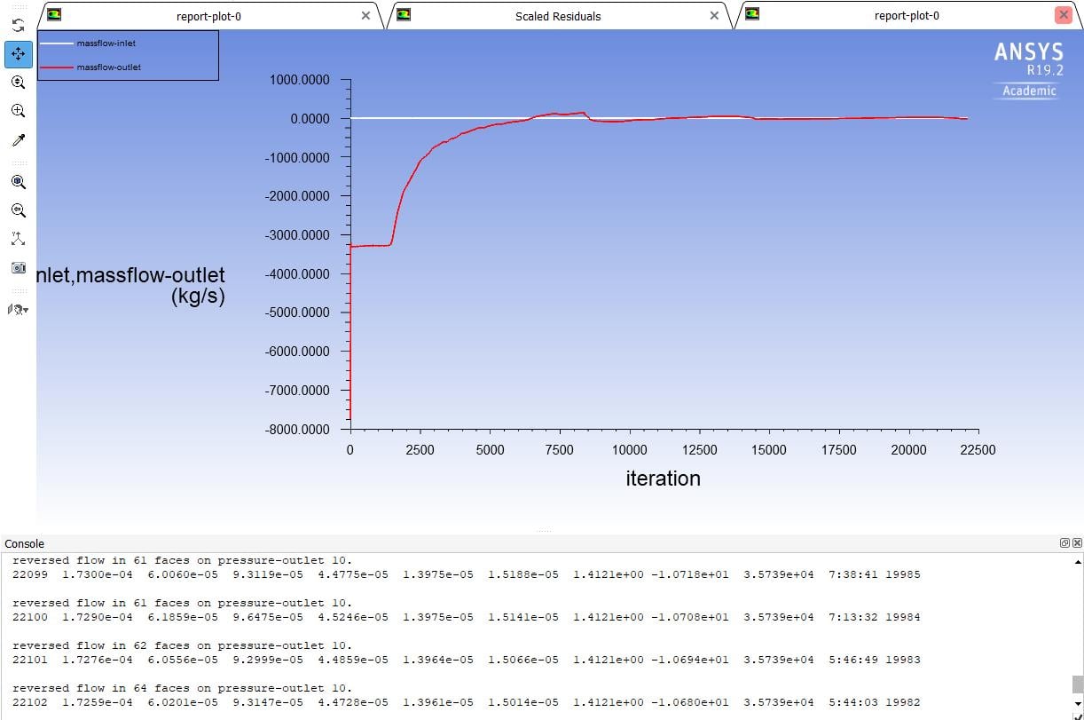

      For my thesis I have to simulate the flow in an aerospike nozzle. After some initial problems my simulation converges, in addition to the residuals I also looked at the mass flow at the inlet and outlet, but this differs considerably. The mass flow at the outlet is by a factor of 10 larger than at the inlet, additionally I often get the message during the simulation that reversed flow is present. The force on the nozzle wall is a hundred times greater then calculated. Does anybody have an idea what this could be due to?

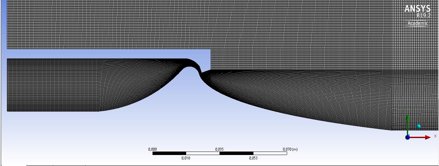

      I am of the opinion that my mesh is ok, because the most important key figures are kept (Max. Skewness < 0.98, Min. Orth. Quality > 0.1, Average Element Quality > 0,775, AR <5 besides some cells at the wall where the AR is up to 30). The outlet is also far enough away from the actual nozzle geometry (about 10 times the length of the nozzle)

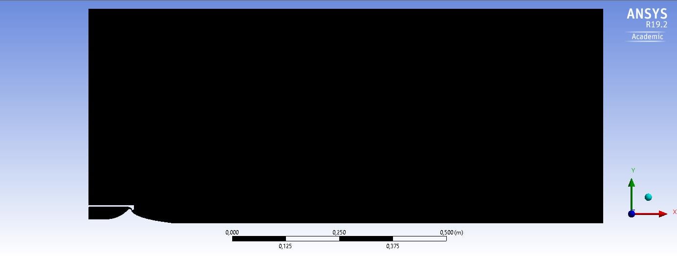

      I have also tried a massflow inlet but then the simulation didn't converge at all. Attached are some pictures of the Mesh. If something is missing I will provide it as sonn as possible.

      It seems like the massflow is also converging, but there is still a Factor of 10 between the massflwow at the inlet and at the outlet.

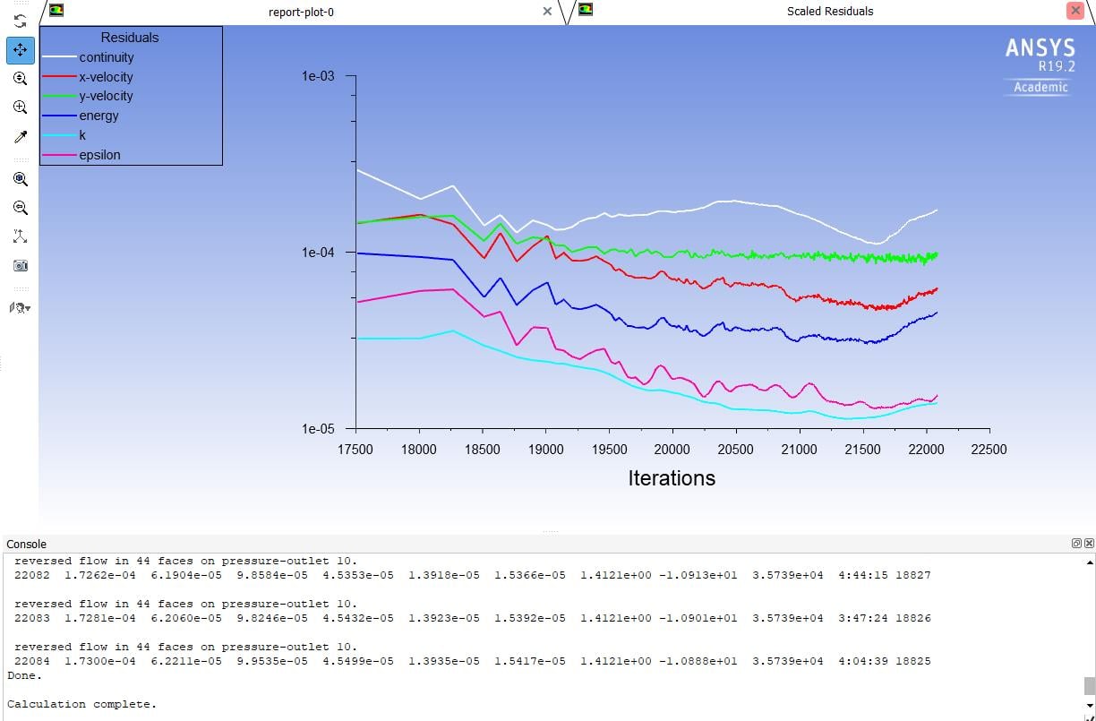

      So its basically the same results as with ROE-FDS. Residuals are converging after 15000 iterations but for the last 4000 iterations there is a reversed flow in ~250 faces on the pressure outlet. The massflow at the outlet is still higher compared to the inlet. The force on the nozzle wall is also considerably too high.

      How about changing the boundaries to pressure farfield (right, top and left boundaries)?

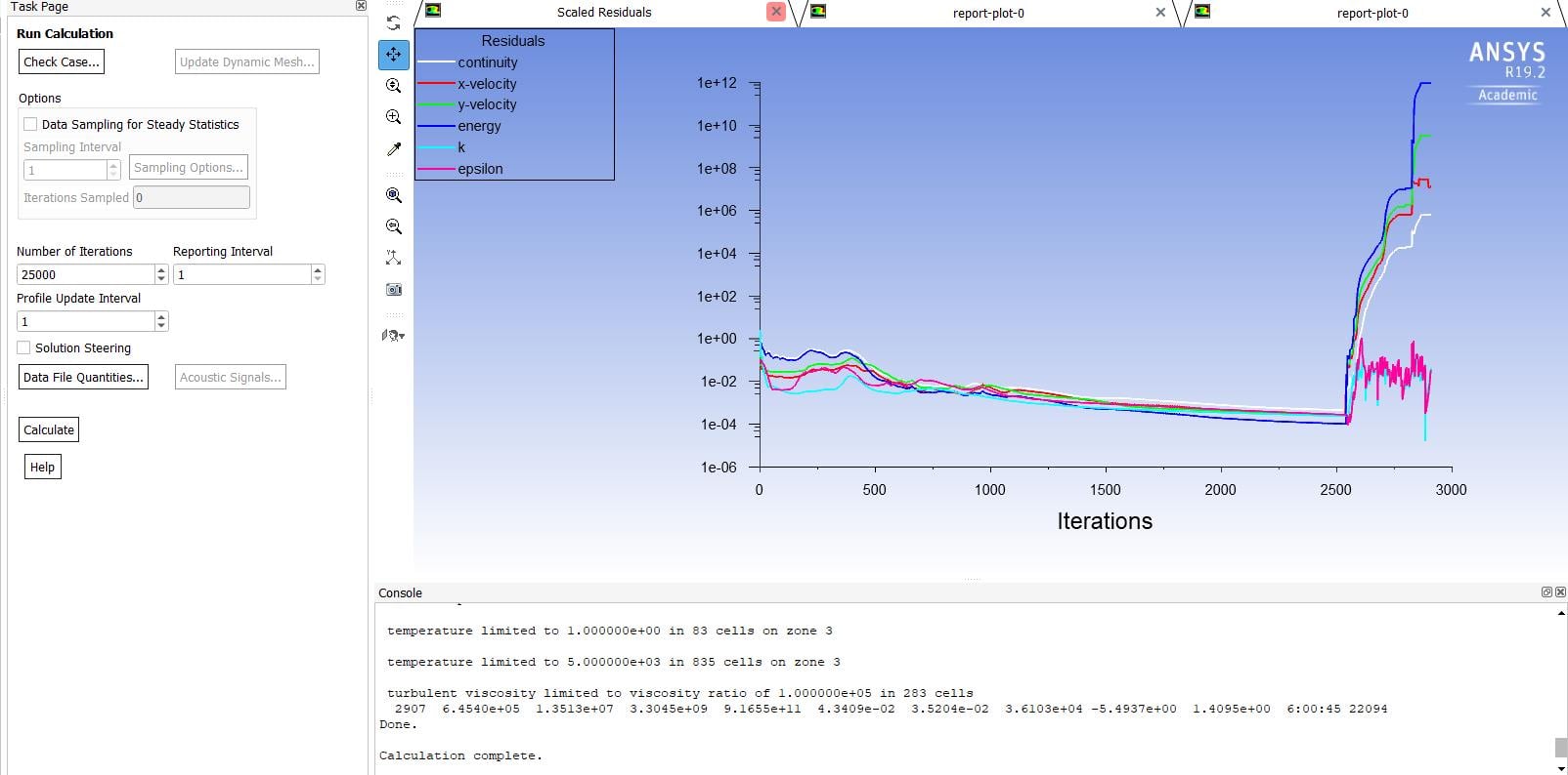

      Unfortunately, this didn't work either. Now the simulation isn't converging at all. First of all the residuals seem to converge very fast but after 2500 iterations the residuals are exploding. I tried it with different Mach numbers for the pressure farfield.

      I am very sorry for my late response! I had to write exams, but I am now back on my thesis. Since I last postet I have refined my Mesh (especially  paying attention to the y+ value) and applied a Pressure Farfield at the left boundary and at the outlet. When specifying the free stream Mach number at M = 0.6 my simulation converges and the massflow at the inlet equals the massflow at the outlet (which was the biggest mistake in my previous simulation). However, if I change the free stream Mach number to smaller values the simulation isn't converging anymore, which I don't really understand.

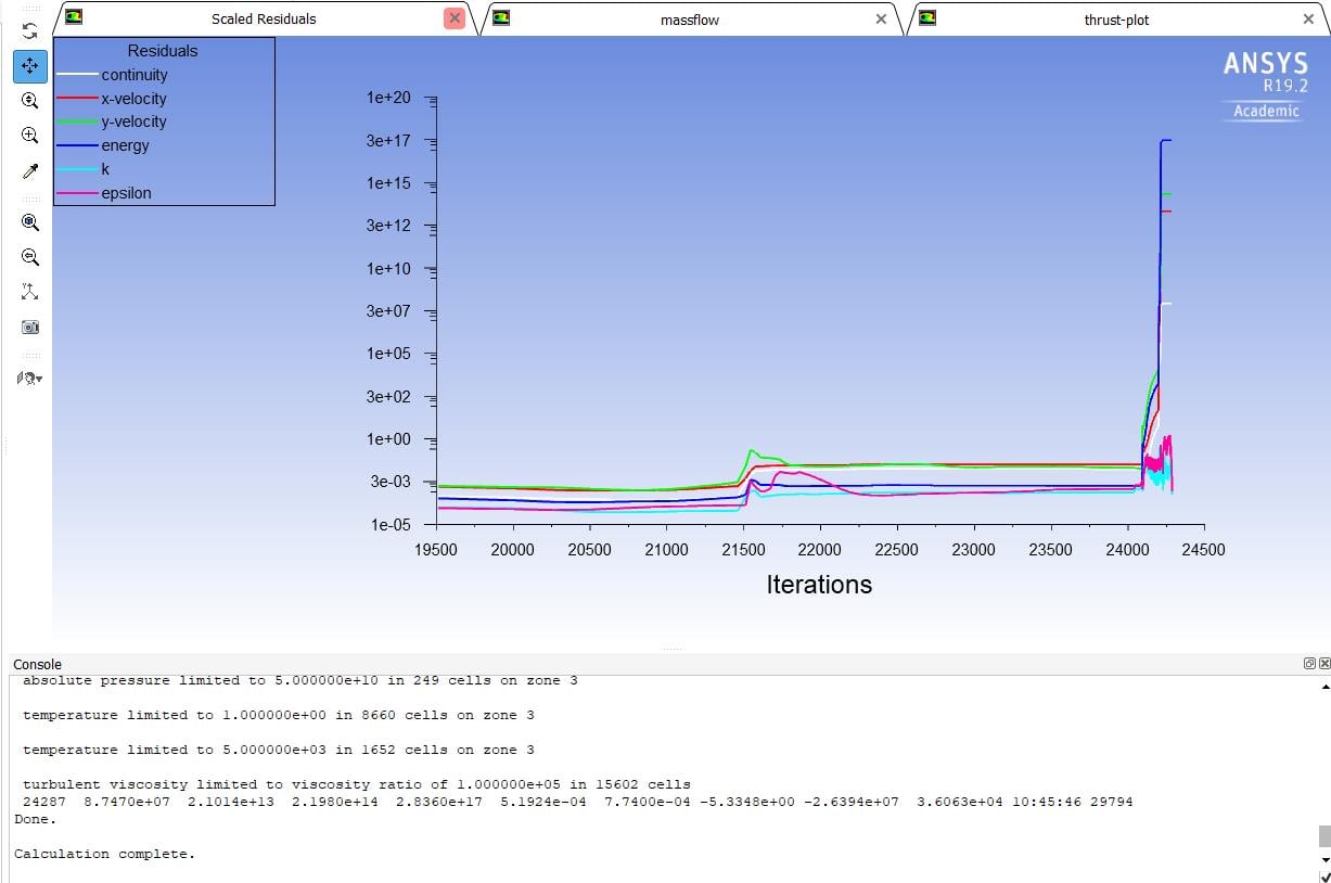

      Thank you for your answer. What exactly do you mean by 'review the flow field carefully'? If I run the simulation with a freestream Mach number of M=0.3 the residuals are exploding after ~20000 Iterations. When this happens, I get the message that the turbulent viscosity ratio is limited to 1e5 and that the temperature is limited to 5e3 K. But this only happens with low Mach numbers at the pressure farfield.
    • KruX
      This are the residuals from my latest simulation. After the spike at 21500 iterations I tried to reduce the Courant Number and the URF, but it didn't help. However, I noticed that the residuals started to rise again when the massflow at the inlet equals the massflow at the outlet. When I started the simulation, both were negative and then they slowly started to converge. At 21500 iterations the massflow at the inlet was equal to the massflow at the outlet (with a different sign) and then the residals explodes and I get the message that temperature, absolute pressure and turbulent viscosity ratio are limited.
