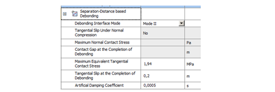

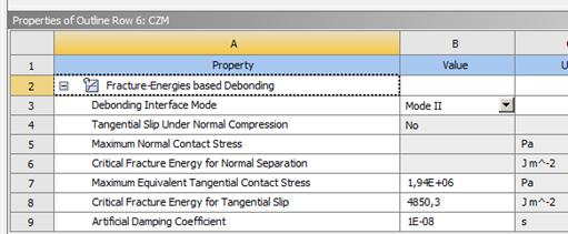

November 2, 2020 at 5:52 pmJoanaAzevedo
Subscriber.Hello!
I started by using the CZM method, with the option of Fracture-Energies based debonding (attached image). The image values are my experimental values.
Then in the Model I added the fracture and then the Contact debonding (which only works with Bonded and separation contacts).
When in the contact between the galvanized steel tube and the concrete cube I place “Bonded” the software runs and gives results (not the intended one) and when I place “No separation” the software doesn't even run, an error appears (next image).
I was only able to resolve the error by using a very high value for the Critical Fracture Energy (1e + 14 j / m2) and the strength results are much lower than the experimental ones (around 55KN).Next image.
I don't know if any of the steps described are wrong.Thanks.

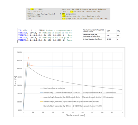

.June 29, 2021 at 7:42 pmJoanaGoncalves
Subscriber.Hello!
Initially only with the CZM, the model ran to the peak and then an error appeared saying that the model did not converge.
Then I tried to implement the commands (https://ansyshelp.ansys.com/account/secured?returnurl=/Views/Secured/corp/v194/ans_ctec/ctec_czmhealing.html?q=czm) ) in the adhesion contact zone simultaneously with the CZM).
What happens next is that there is a post-peak response, but as you can see from the chart, it's still far from what I want. Can you help me please? Thanks!
Joana Gonçalves
