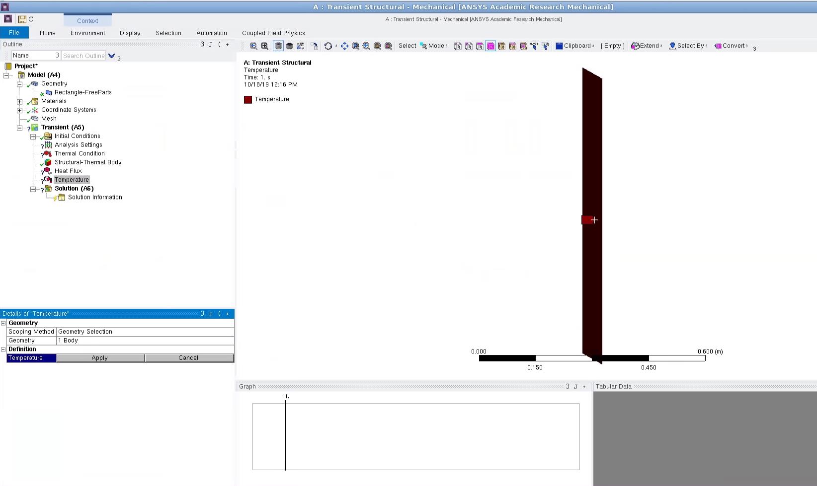

I am working in the transient structure analysis system and I cannot input any tabular data. I have checked several tutorials and when they clicked on tabular data, a window pops up in which we can enter data. However, nothing happens on my screen. I have also tried the external load but it still does not work.

Ansys Employeeplease post some snapshots and provide links to what tutorials you are referring to.

Ansys EmployeeOk, 2 Issues here:
1. You are using an the Coupled Physics ACT plugin from an older version in what looks like a newer version of ANSYS. Is it ANSYS 2019R3 (available as a beta feature in 2019R2)? If it is then you should be able to directly use the Coupled Transient Analysis system:
2. Coupled Field analysis does not use the concept of EKILL/EALIVE which is a lumped layer approach to building metal parts. You might want to start off by using the AdditiveWizard which comes pre-packaged in as an extension. Refer to the help for complete details.
It is also a linked analysis that uses weak coupling.
Here the video you might want to follow:
https://www.youtube.com/watch?v=eK0n7Q0IqyM
Lastly, there is some other systems issue with you the graphics on your linux machine. The context-dependent menu isn't quite available here.

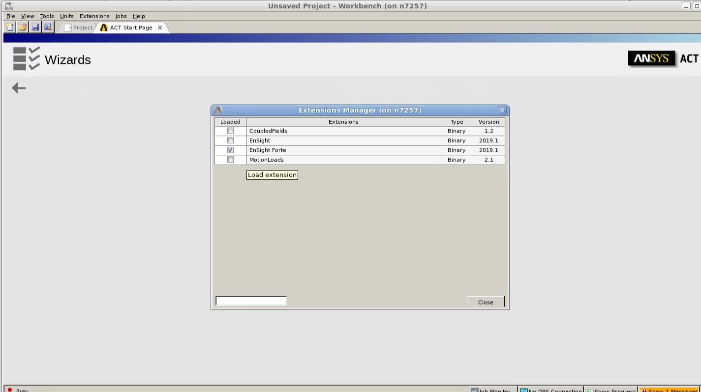

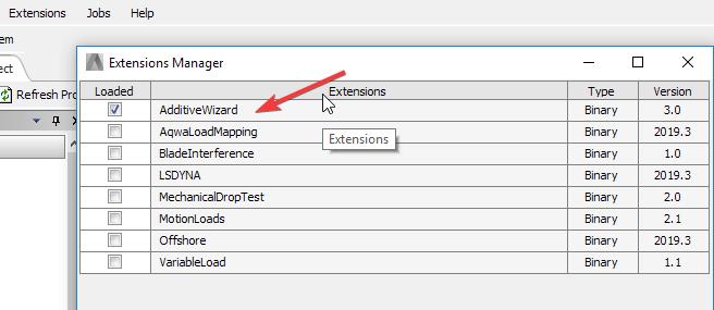

SubscriberAlso where can we find the AM wizard? We have access to the additive suite but do not know where to download the AM wizard
Thank you
October 23, 2019 at 4:18 pm
Sandeep Medikonda
Ansys EmployeeIt comes pre-packaged. Just activate it using Extensions>Manage Extensions as I show above

SubscriberIs it only available in windows?
October 23, 2019 at 4:37 pm
Sandeep Medikonda
Ansys Employeeyes, it is very likely...
October 23, 2019 at 5:18 pm
Sandeep Medikonda
Ansys EmployeeOn Linux, you might've to work without the Wizard. Please see Chapter 5 in the help to understand the general steps.
