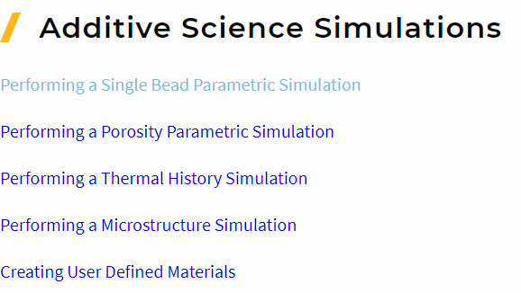

I am doing my thesis in additive manufacturing . My major focus now is the simulation of the melt pool geometry. I have read a good number of journals and a got some idea about the modelling. But I am not able to find a material to do the melt pool simulation using ansys. Which module can be used for this melt pool simulation? Kindly share the sources for leaning . That would be very much helpful for me to progress further. Thank you all!

SubscriberThank you . But I studied that ANSYS additive science is a parametric software and we cant get the temperature contours like workbench. Is that true? Correct me if I am wrong. Thank you once again

Forum ModeratorIf you search on here there are a couple of others looking at laser sintering and melt pools. They're using Fluent and UDFs to add in laser energy & motion.
