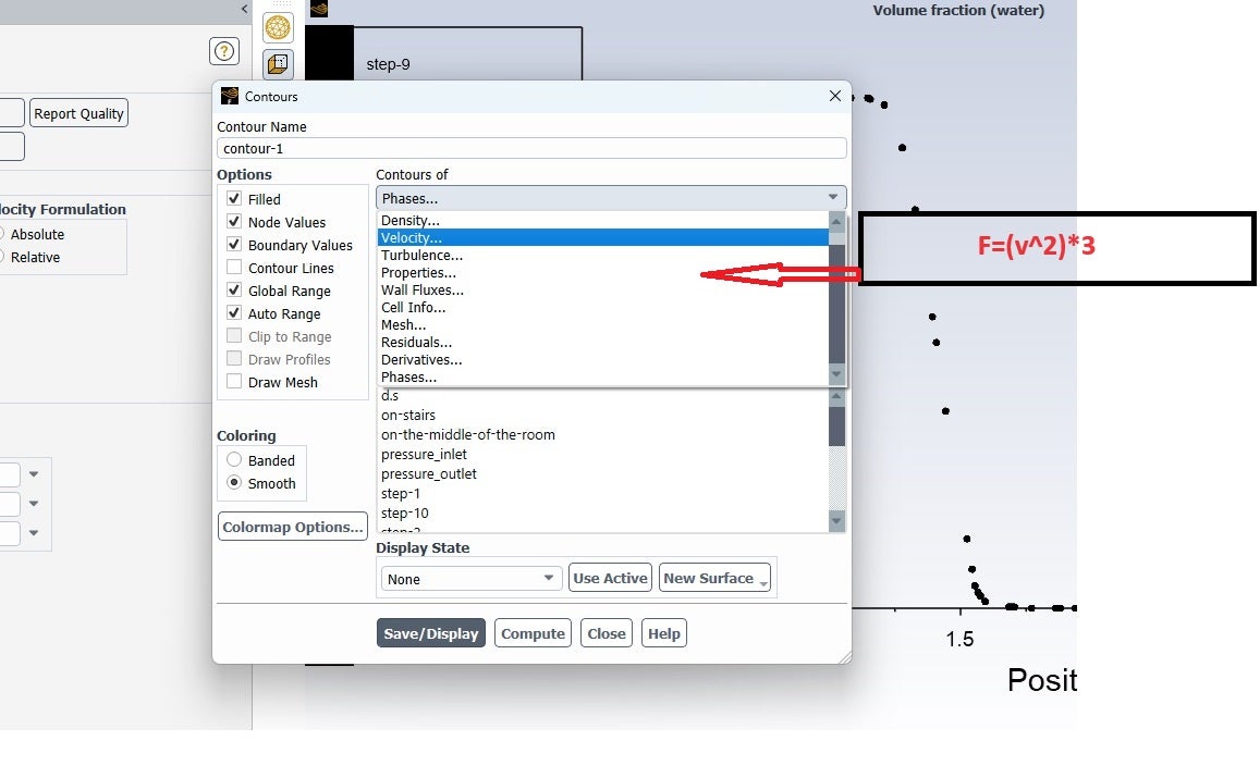

      Hwllo every one,
      Can I create a contour for a specific variable in Ansys? For example, ANSYS creates a velocity contour. Can I create a contour for (velocity*velocity*fixed number)?
    • SRP
      You can create custom field function and use it in contours.
      Please check ansys user's guide to create custom field function: 42.5. Custom Field Functions (ansys.com)
      Thank you.
