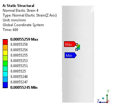

      Cut the model down to a 1/4 model, in other words a 2 mm x 3.5 mm piece and put symmetry conditions on the cut boundaries.
      You only need a tiny piece of substrate behind the polyimide. In the example I show, I have created a 1 mm thick piece. I'm also ignoring the cylinder radius for simplicity and have made a flat substrate.
      Here is the strain on the face in the Y and Z directions from the cylinder with the pressure, without the polyimide body..
      Here is the strain on the tiny piece of substrate without the strain gauge.
      See that the surface strain is identical. Below is the mesh on the polyimide. It has 3 elements through the thickness.
      Below is the stress on the Polyimide with that strain. Note the large gradient at the "free edge" at the top. The bottom edge is the symmetry face.
      If I simulate that for 60 seconds, I can plot the Equivalent Creep Strain, which has a gradient at the top free edge where the stress gradient existed.
      Attached is an ANSYS 18.2 archive which you can open in 19.1 (I don't have that version installed).
