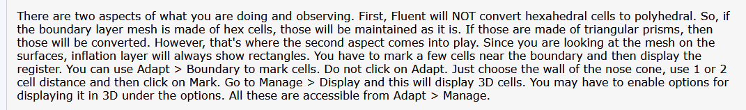

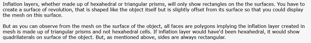

      Some where i found this asnwer..is it true ROB?
      I think i got the answer , i cant adapt boundary layer, even my mesh is created as polyhedral in Ansys Flent meshing

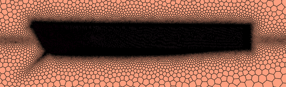

      You can adapt the boundary layer, but there are rules for anisotropic adaption.  Please post exactly what panels you're using.
    • tumulpurwar
      Hi Rob

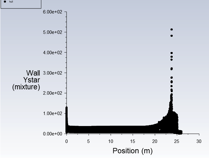

      This is hull around which i have fine prism layer and currenntly after running some itaeration , my y is shown in photo,i want make it betwenn 30 and 300 , and due to this reason i want use y adaption, i am not sure, why you dont recommend y* adaption?
      Anisotropic probably is expensive in terms of memory.and even if i use anoisotropic my y* will never come in range what i want

      Dynamic adaption means Fluent will refine and coarse automatically as the crition are met. It's commonly used for free surface modelling where the free surface moves and we don't want to refine regions that we don't have to.
      If you need to refine near the wall you'll need to use anisotropic on the boundary layer. This has limitations (you must adapt the whole cell layer, and that layer must terminate at an external boundary or be "looped").
      I have not recommended either y+ or y*, I am trying to explain adaption.

      In my case i need to refine either prism layer or refine velocity gradient near hull wall, as well as need to refine with help of criteria pressure waves(sea waves hitting or resisting hull movement forward)
    • tumulpurwar
      Also i dont want to refine further boundary layer, as you can see from my earlier photo of y* plot, i want to coarse and fine boundary layer so that in can come under 30 to 300, as i am using wall function, thats why i think anisotropic will not help here, what you say?

      So i guess conclusion is
      y* adaption for 2019 R3 license with polyhedral cells doesnot work for PRISM LAYERS
      Anisotropic can work
      For tetrahedral ,y* adapt can work
