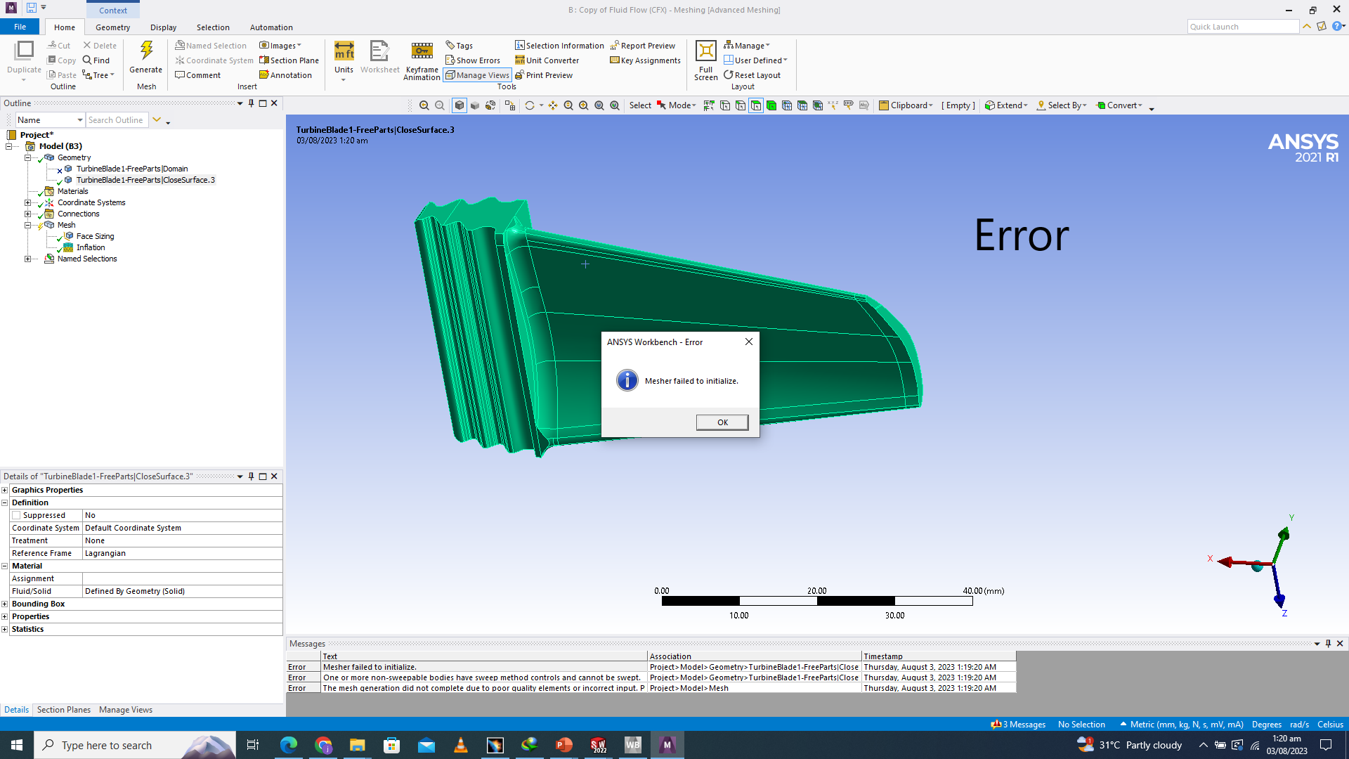

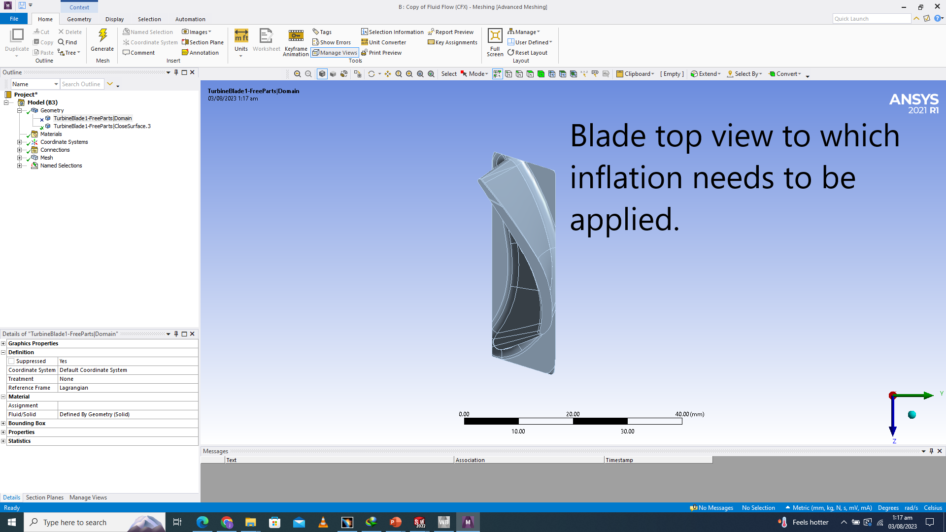

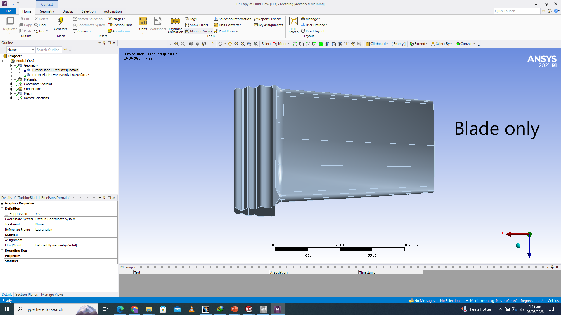

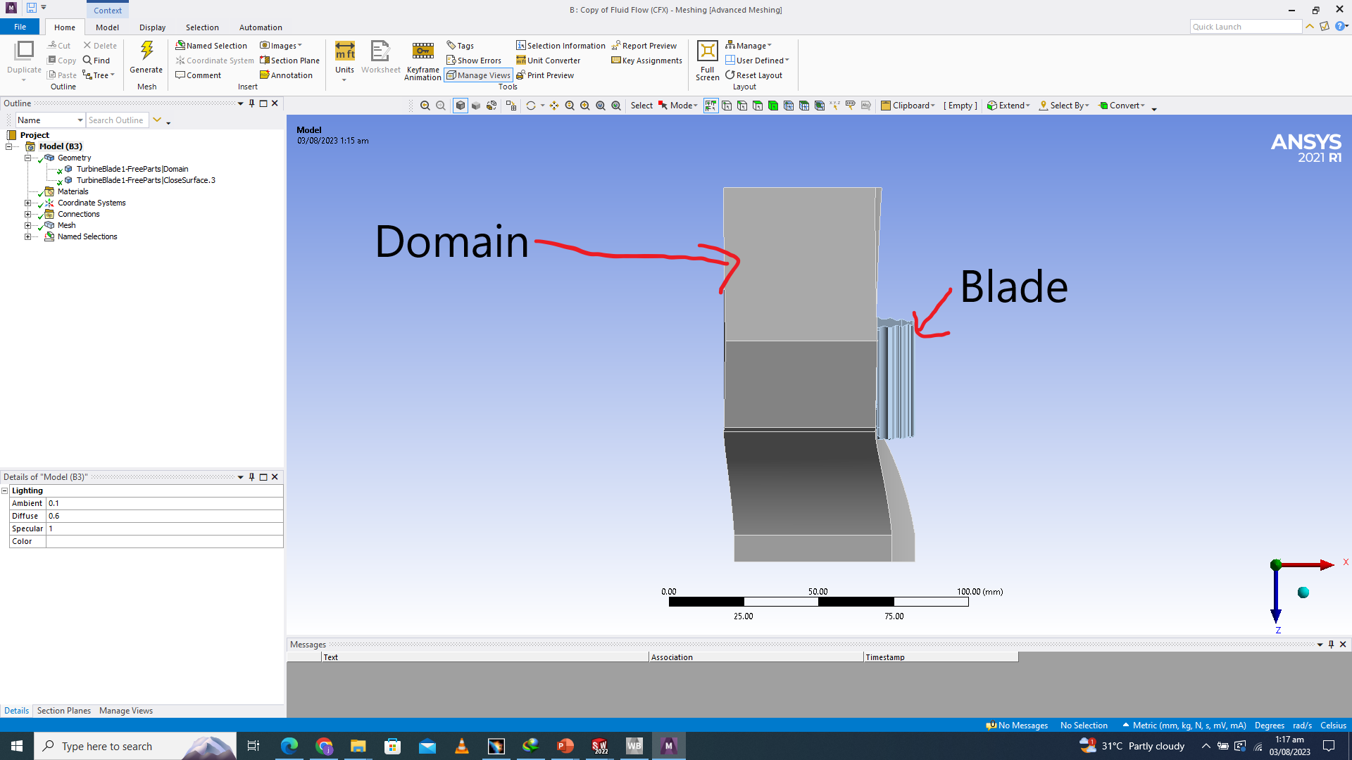

Actually i want to study effects of the flow on the balde in cfx. My blade is wi
    • Jack Cool
      • On what edges should i apply the inflation.(Which geometry to be selected in details of inflation and which boundary to be selected. )
    • CFD_Friend
      Hi Jack,
      Inflations are to be provided inside the fluid domain. Select the fluid domain as the geometry and choose the blade walls as boundary.
