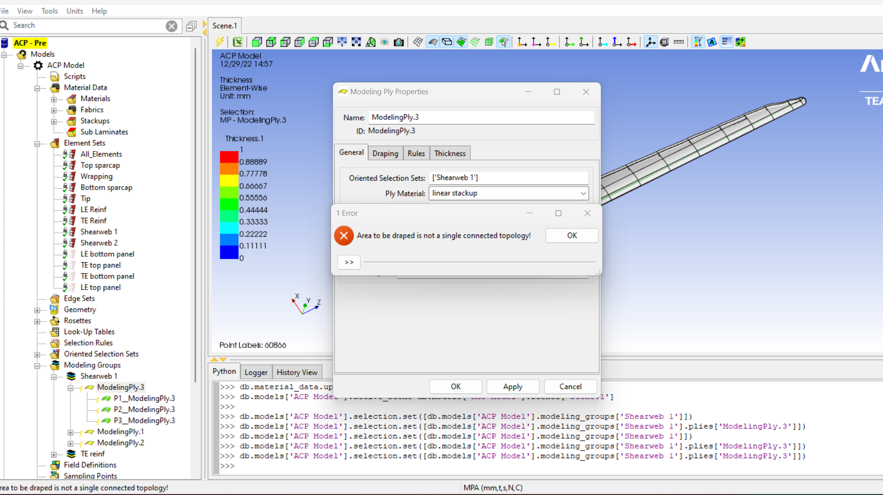

      I want to analyze Composite Wind turbine blades in fatigue.
      1. When I try to create a modeling group in workbench, I gott an error message( as shown in the screenshot). What this error mean,s, and how can i solve this problem.
      2. I want to vary the section thickness in longitudinal direction of my model. How can I do this?
    • bhagwantP
      Hello Sushil ,
      Have you used shared topology in modelling?
      Looks like error is prompting that there are more than one bodies where topology didn't happened.
      Thanks

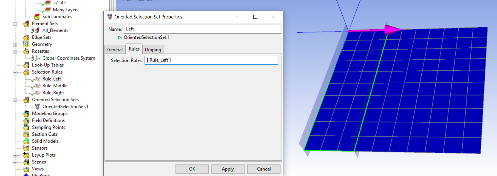

      While using the selection rule how to consider the abrupt section change. I want to create sandwich panel "section rule" will create notch in each dividing plane. Does it effect on fatigue analysis of the blade?
    • Reno Genest
      Hello Sushil,

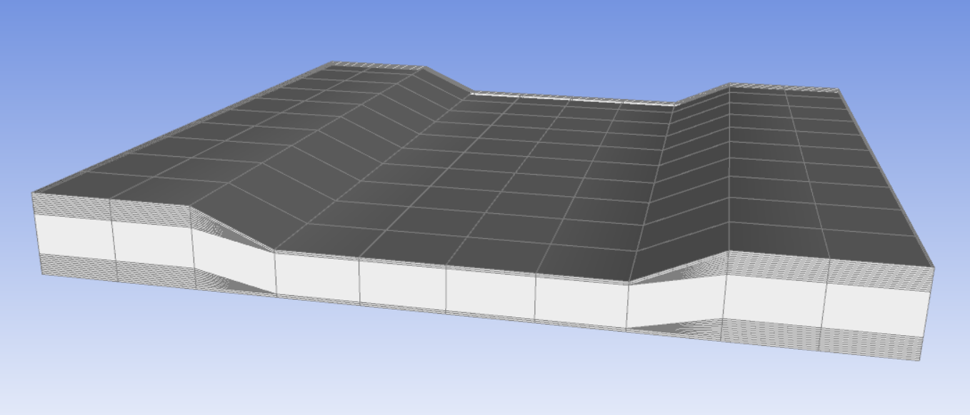

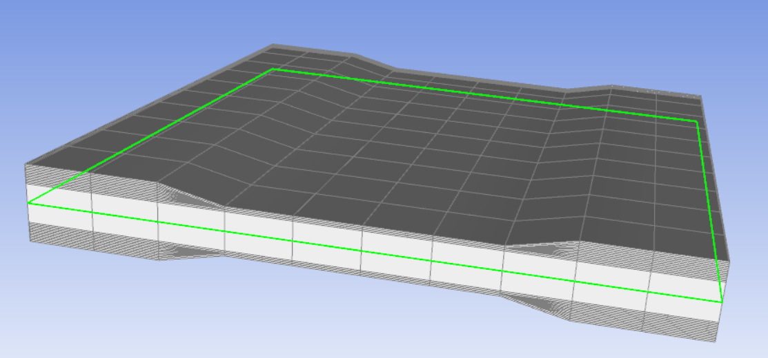

      You can create abrupt section changes by defining a different number of layers for each oriented element sets. This will lead to ply drop off. Here are 2 ways of doing it:

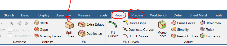

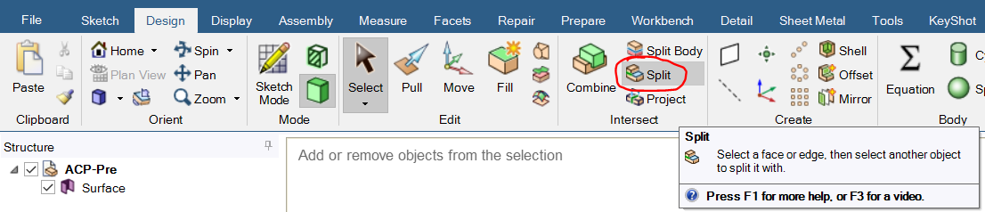

      Splitting the surface in SpaceClaim:
      I think the best way of doing it is to slice your surface geometry in SpaceClaim to have all the regions of the surface where you have different layups (different number of plies). You want to split the face without creating new surface bodies:
      Then, you create named selections in Mechanical for each region. The named selections will transfer to ACP as element sets. You can then use the different element sets to create the Oriented element sets needed to build the layup. This is the best way because if you refine the mesh in Mechanical, the element sets will update properly based on the named selections in Mechanical. Let me know if you have questions about this process.

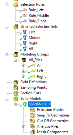

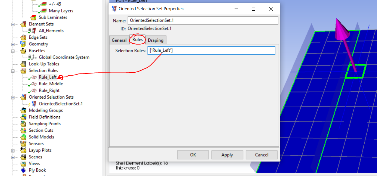

      Using selection rules:
      Using selection rules is the second best option I think. It will keep the regions almost the same when refining the mesh, but you may have some elements that are not picked up by the selection rule and you end up with a jagged region. This may be okay for early design iterations when you don’t know exactly where the boundary of each region will be. So, selection rules is more flexible and allow you to quickly change the boundary of each region.
      So, with selection rules you don’t need to split the surface in SpaceClaim and you don’t need to have named selections in Mechanical. I created an example of a square plate with 3 regions (left, middle, and right). Here is the left region selection rule:

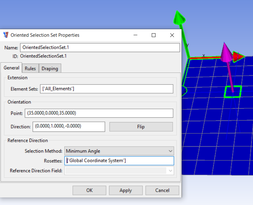

      Once you created the selection rules, you can create the oriented selection sets:
      On the General tab, you select all elements as element set and define the other inputs (point, direction, rosette) as usual. Then, you move to the Rules tab and select the appropriate selection rule for the oriented selection set:
      You do the same process for all regions and then you can build the layup (add plies in Modeling Groups):

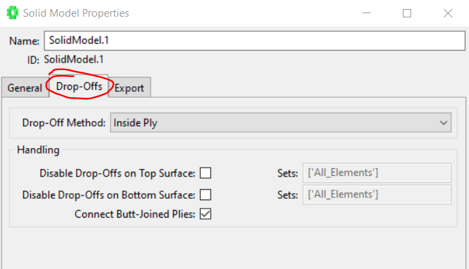

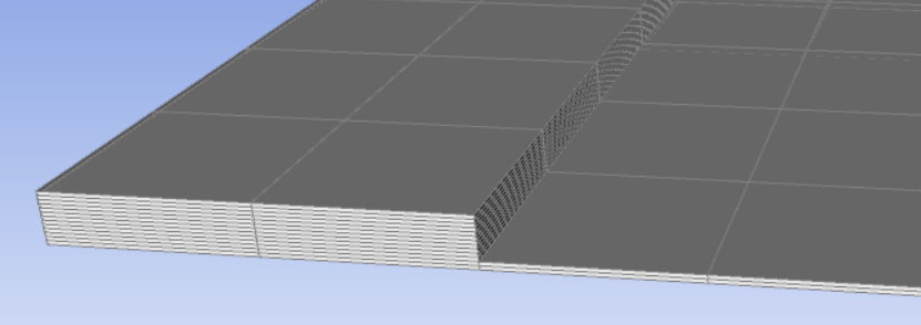

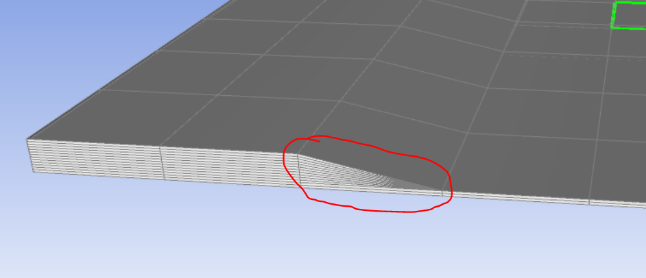

      Then, when you create the solid model, you have drop off options. The default are:
      Which leads to the following:
      The ply drop offs will happen over the length of your element. So, if you have large elements, the drop off will be smoother and if you have small elements the drop off will be more abrupt.

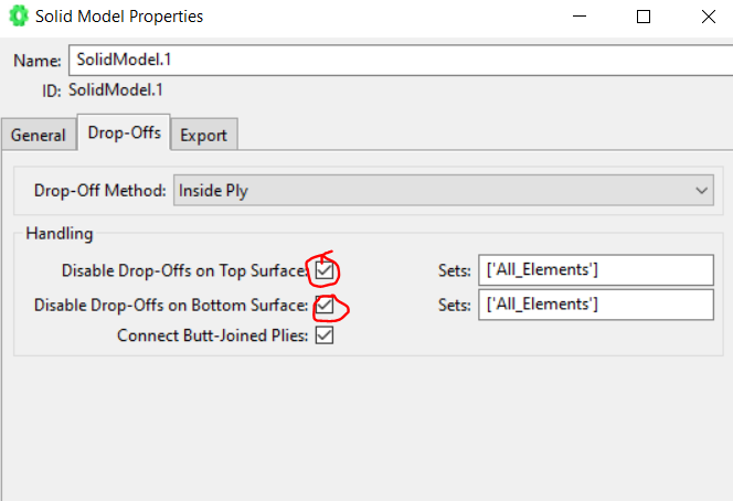

      You can also disable the drop off to get an abrupt drop:
      But, this is not a good design; it will lead to stress concentration which is not good for fatigue life. You should have a nice and smooth transition in your composite layup.
      I recommend you create a simple plate model like the one above and “play” with the different options and see what works best for you. There are many ways to do things in ACP.
      Let me know how it goes.

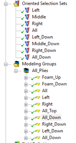

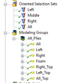

    • Reno Genest

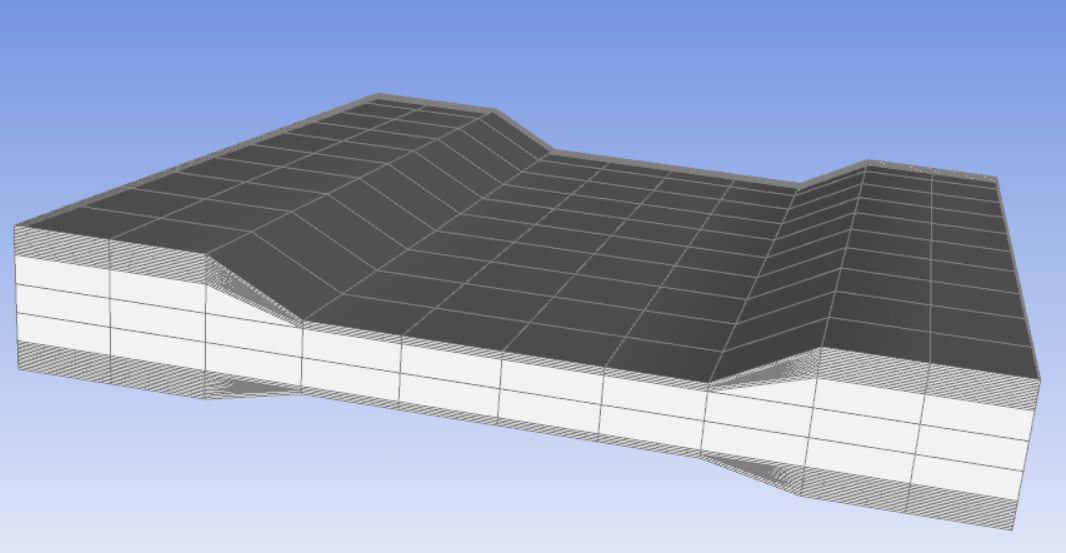

      Hello Sushil,
      If the composite layers are positioned on top and bottom surfaces of the foam core, you can start by adding the foam core as the first “layer” on the surface. You can apply half the foam core thickness in the “up” direction and half the core thickness in the “down” direction from the surface. Then, you can add the carbon layers on top and bottom surfaces. The result is as follows:
      You will need to create double the amount of Oriented selection sets; some for the “up” direction, and others for the “down” direction:
      Let me know if this helps or not.
      Reno.

      I want to model similar to this but also want to vary the foam's thickness.
    • Reno Genest
      Hello Sushil,
      It is basically the same process for variable thickness foam:
      Is it what you are looking for?

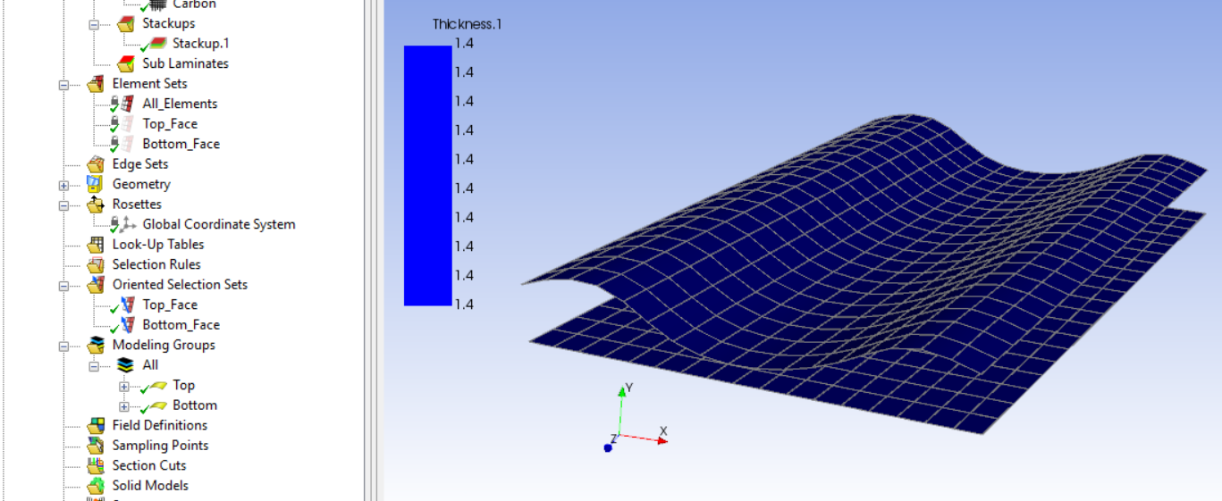

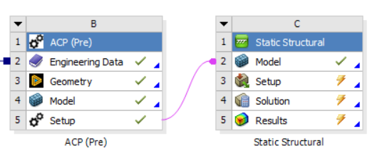

    • Reno Genest
      Hello Sushil,

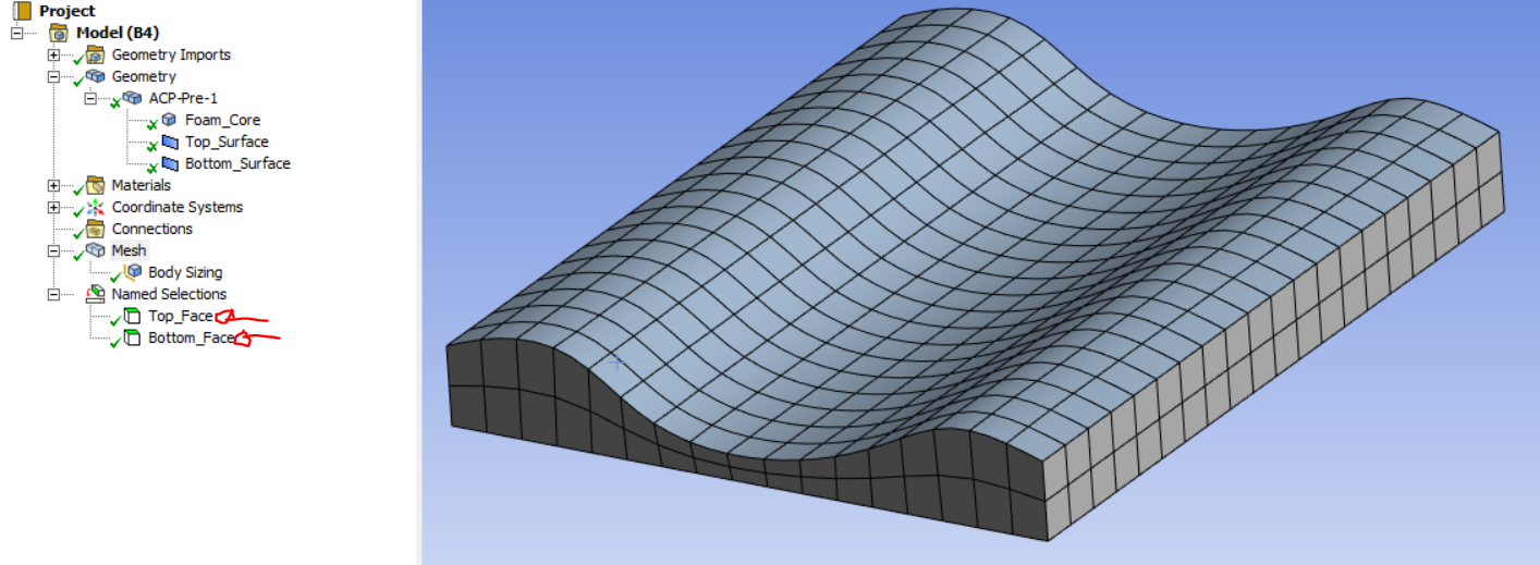

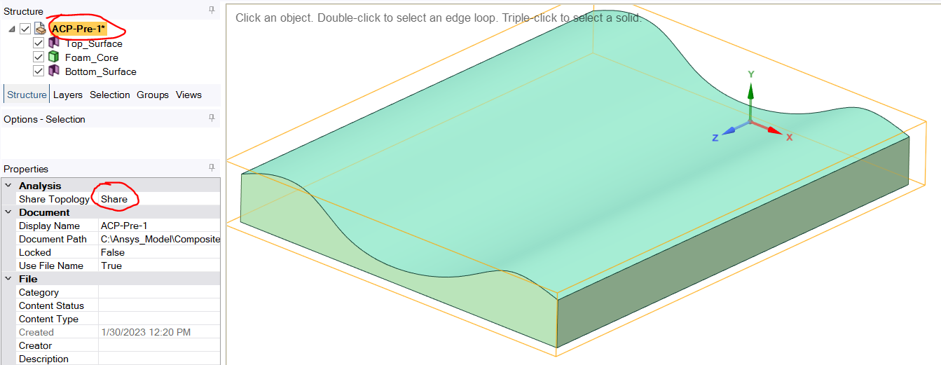

      If your core geometry is complex, you could create the 3D geometry of the foam core in SpaceClaim and then create surfaces on top and bottom faces of the foam core:
      You can select "Share" for the share topology setting to have conformal mesh between the solid core and the surfaces. Without "Share", you need to define bonded contacts between the foam core and the surfaces (used to define the carbon  layup).
      Then, in Mechanical, you can mesh the model and create named selections:
      In ACP, you will only see the top and bottom surfaces used to create the composite layup:

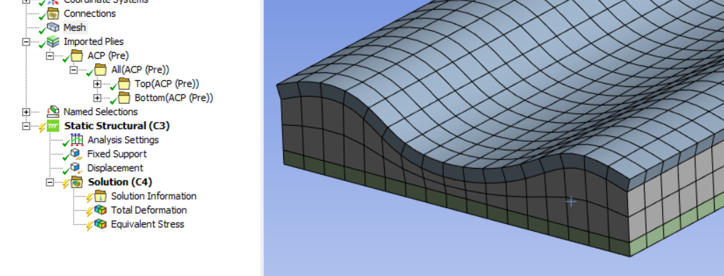

      But, when you link ACP pre to a Static Structural system, the foam core will show up in Mechanical:
      Reno.

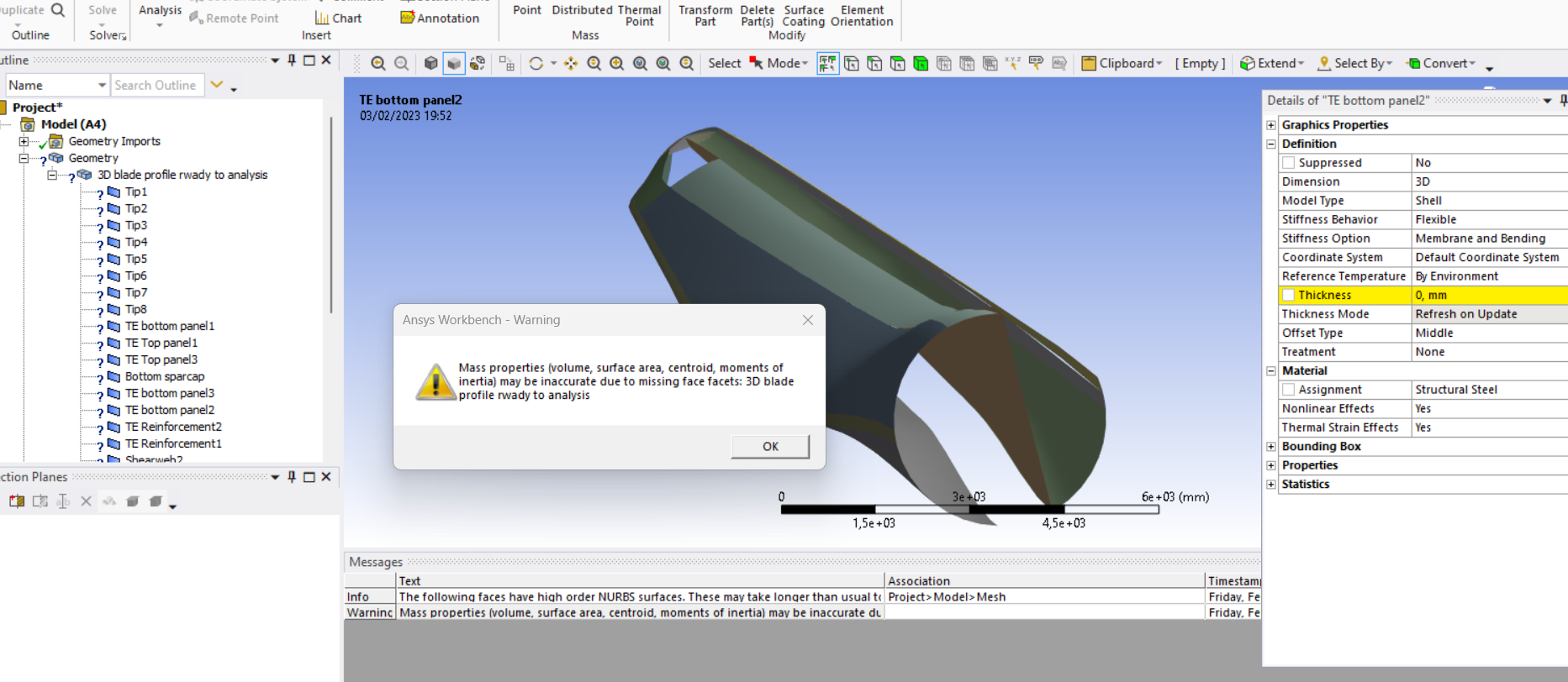

      I modeled a wind turbine blade using surface elements in space claim. I want to perform a model analysis of the blade, so I import such a model to the design modeler. While opening the model file to generate mesh to my model, some elements are not shown in the window(as shown in the attached screenshot), and some element are extra added to the element tree. How can I solve this issue?
      Can you give me any idea about the problem and how to resolve it?
      Thank you
    • Reno Genest
      Hello Sushil,
      You have to assign a thickness to all surface bodies in Mechanical. You can put 1mm for all surface bodies. You are doing the  composite modeling in ACP and so the real thickness will come from the composite layup in ACP.
      Note, that you there is no need  to import  the model into DesignModeler because all the geometry work can be done in SpaceClaim. Make sure the geometry is good in SpaceClaim (no small edges, split edges, etc.). Use the "Repair" and "Prepare" tabs in SpaceClaim:

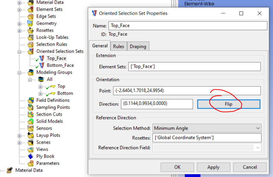

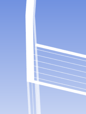

      I use the selection rule to vary my foam thickness, and I hope it works as I assume too. Now I am stuck in another problem shown in the figure.
      I want to wrap my model with four layers of ply from outward, but when I model the ply, it comes inside rather than outside(4 vertical lines on the right side of the outer skin). How can I sift this laminate to the left side of the outer skin?
      Thank you
    • Reno Genest
      Hello Sushil,
      With the Oriented Selection set, you can specify the layup direction to add plies on both sides of the surface (shell elements). You can create another Oriented Selection set and flip the direction to apply a ply on the other side of the surface:
      Also, the order of plies in the Modeling group matters; the ply at the top will be the first ply applied to the surface, the second ply in the tree, the second building thickness in one direction (depending on the Oriented Selection set), and so on.
