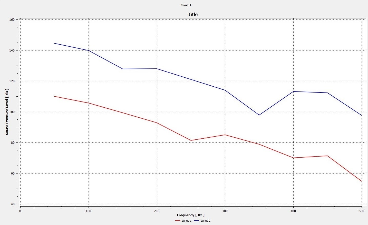

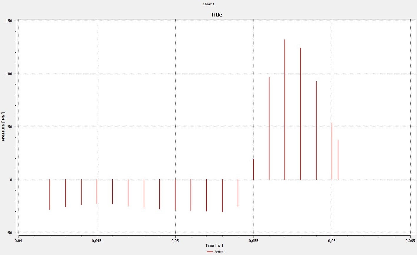

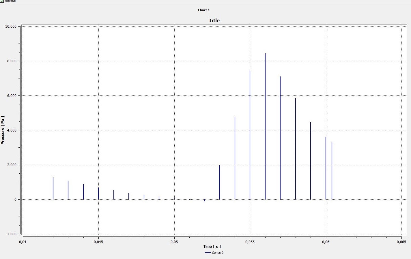

Here are my results from CFD-Post. Series 1 is from outlet, series 2 is from inlet.
Why is the SPL value below 40 Hz missing from the graph? Is this a problem of my periodic transient table?
Do I need to make any changes to the pressure value from simulation? Or I can use the pressure value computed and perfom FFT directly? 140 dB seems unrealistics.
How do I increase the resolution of my SPL chart? It seems as if only one value is calculated every 50 Hz. Does accounting more period/cycle/"exhaust" improve the accuracy of SPL chart?

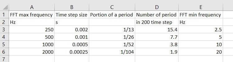

And also, in the case where I am much more interested in the low frequency range (<250Hz), which time step option should I go for? Since I have limited memory capacity, 200 time step is the most I can saved, as it is gonna take up around 50 GB of space. What is actually the best prectice for such selection?
Please advise me on this matter. Thank you in advance.
July 19, 2021 at 1:11 pmMarco Coderoni
Ansys EmployeeHello,
Assuming that you are exporting data every timestep, then your timestep would define the frequency resolution (delta f) of the signal. The overall period of sampling (T) defines the lowest frequency you can resolve. The smaller is the frequency you need to study the longer is the period for which you need collect data.
To reduce the amount of data you save, just select the few location you are interested in. For example, if you need to study only two points in the domain, do not export the full 3D data, but just the pressure signal at that location. You can create a point and use just that as monitor.
