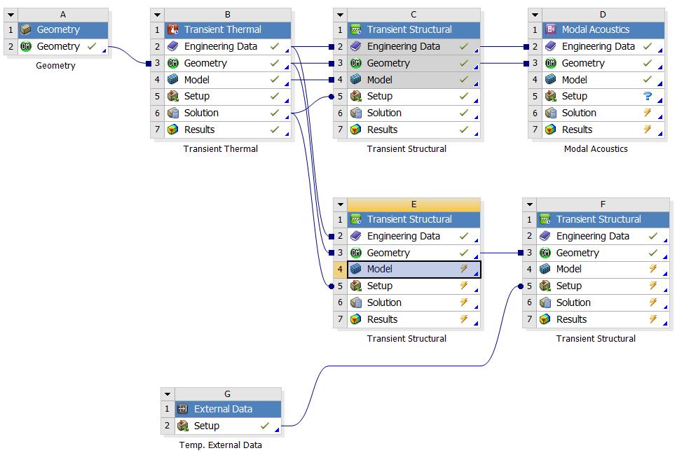

      I need to work on one of the acoustic modules of ANSYS that my task is importing (Displacement) data "Output of Transient Structural Module" in to the Acoustic module and Calculate the pressure (Acoustic Wave) as the Ultrasound idea. I NEED to Know:
      1- Which module should i use Model Acoustic or Harmonic Acoustics?
      2- Should i define a physical region or not ? "N.B.: I don't know what's the meaning of physical region in acoustics"
      Also i have downloaded the ACT and Acoustics Extension; installed them on ANSYS Workbench but still can't work on any of the acoustic modules, there's a (?) beside the module as shown in figure, WHY???
      Help Please... Thanks in advance

      Even when i used a stand alone Harmonic module (Just for exercise for myself), i can't work with any of the modules. Is there any specific parameters i need to define before using the harmonic modules in ANSYS ?

      - May the problem of acoustic results from that it didn't work for 2D Models, Material Properties, Analysis Settings, Time, or Mesh size; I really don't know how to deal with any of the acoustic modules in ANSYS even for 3D models it didn't work with me

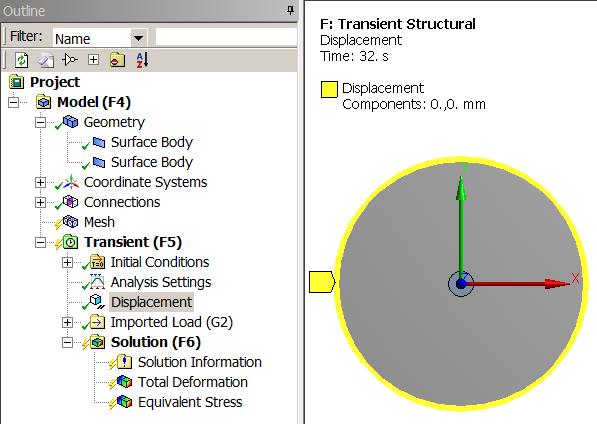

      I have opened your project, which I see has 2D Plane Stress Transient Thermal and Transient Structural analysis linked together in B and C, E and F.
      In all the Transient Structural models, you have constrained the edge to have zero displacement. Could you explain what you are trying to simulate and why a zero displacement circular edge is a good boundary condition for your needs. The geometry for this Plane Stress analysis is only 0.1 mm thick.  Is that the actual dimension of the material?
      The time scales on these Transient Structural models range from 92 seconds to 32 seconds.  The only input that causes displacement over time is the step change in the Thermal model. The response is shown below.
      The solver warns that the initial time step may be too large. I agree with that assessment.
      The heat "pulse" is much too slow to count as an acoustic pulse.
      Are you planning to apply Ultrasound displacement inputs to a model?

      1- For the existing models (B, C, E, & F) it was just to check the difference in output signal from structure when (Model) is linked and not linked.
      2- In Transient Structure; I have a boundary condition that the nodes on the outer circle is fixed, So i put (Displacement = 0 in X and Y) as well i tried to use the (Fixed Support) instead of (Displacement = 0) and found no difference in result.
      3- For the (Thickness); I don't know what is the reasonable value to use i just put (0.1 mm) as it's a small value and my geometry is a sheet! It seems that am wrong here...
      4- Yes the only input that causes displacement over time is the step change in the Thermal model. And subsequently the input that will cause pressure over time is the change in displacement + Acoustic boundary conditions applied.
      5- Exactly i need to apply the displacement I/P to calculate Pressure as in Ultrasound.

      And Yes i downloaded the Acoustic ACT extension from library (ACT_Acoustics_v190.1) and installed it in the "Extensions" of ANSYS. The tutorials exist are for a (Speaker) or (fluid flow & Acoustic using: Fluent Solver). When i follow the Speaker Example the (Acoustic module displays a (?) as shown in Fig. bellow)
