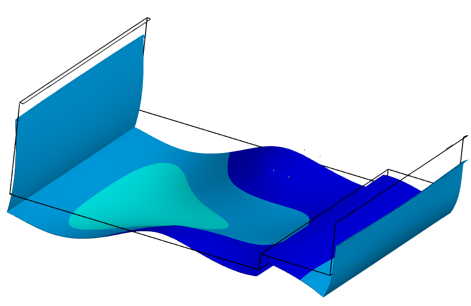

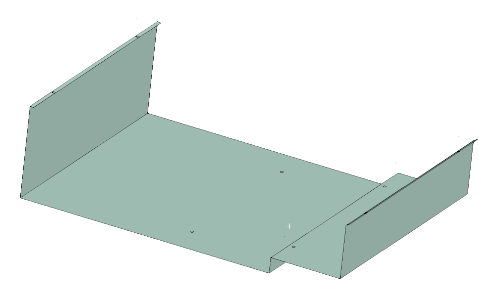

      I'd like to simulate the deformation of a sheet metal with a large width/length to thickness ratio, for example this:

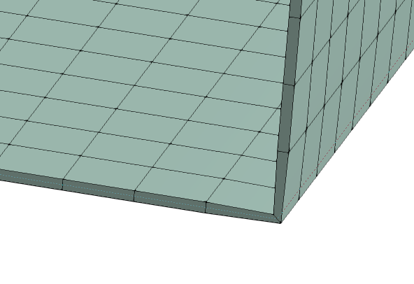

      Solid elements (1 Layer; Hexaeder dominant)

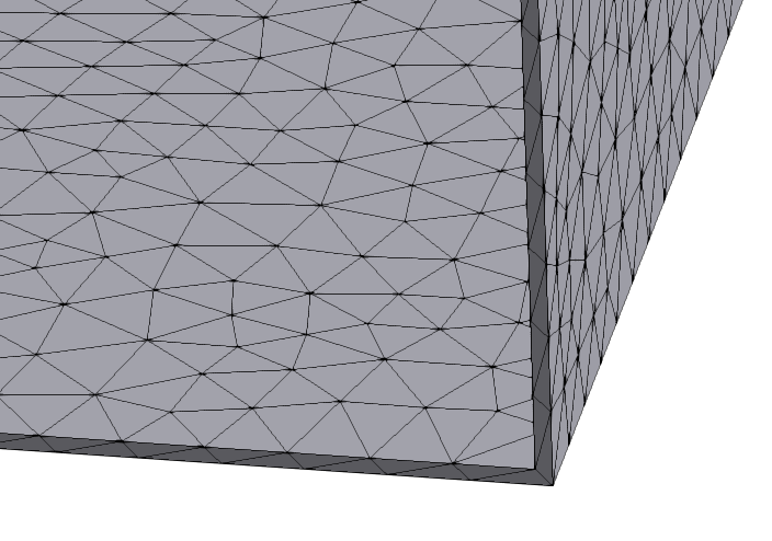

      Solid elements (1 Layer; Tetraeder)

      How does this look?
      Or this?
