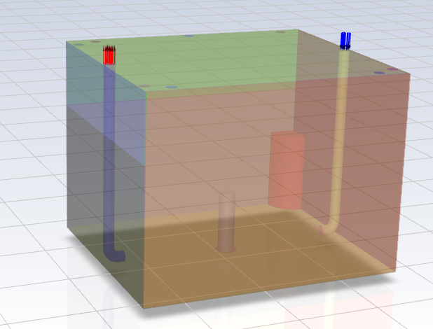

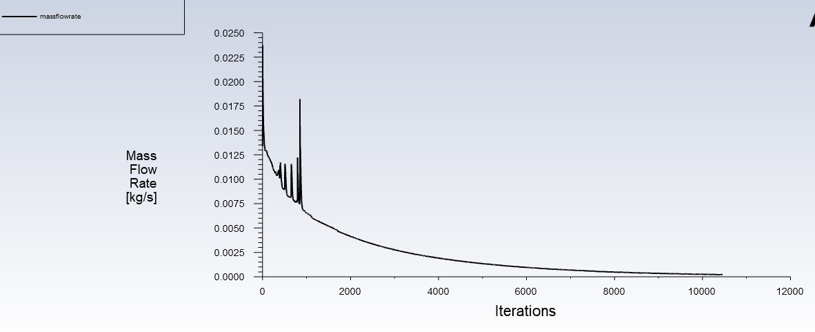

      I have a problem with the convergence of my simulation. It takes about 15.000 Iterations for the mass- and heatbalance to add up.
      The case models airflow inside a room. The air enters through the velocity inlet with a temperature of 55 °C and 0.4 m/s and leaves the room through the pressure outlet. One of the walls contains a heat sink so that mean air temperature in the room results in ~20°C. The mesh has 4.5 mio cells.

      2. I am using the coupled-solver. At first I tried using SIMPLE, but it didnt converged at all. The residuals for the continuity-equation are not going down (~0.1), I guess this is due to the turbulent nature of parts of the flow. Thats why I track my mass-balance instead to check convergence.

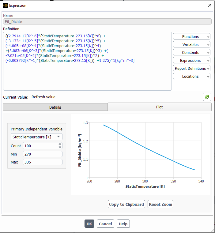

      For the density (and thermal conductivity and viscosity) I am using a polynoma (5th degree) in dependance of the StaticTemperature integrated via an expression.

      Ah. Can you plot the polynomials using the exact values in Fluent? Use the plot function in Fluent in the materials panel.
    • benjamin.walz
      I created my own Polynoma fitting literature data:
      I use this as a "named expression".
      • NickFL

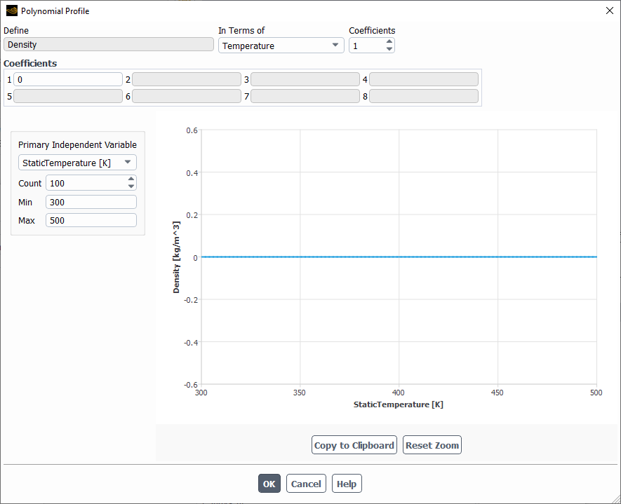

        I look at that data and I think a 6th order polynomial is a bit of an overkill. How many data points did you use to fit the data?  Have you tried to simplfiy it? It won't speed up the computation much, but it can't hurt. Also, is there a reason you are not using the built-in polynomial fit in the materials tab?
      OK. I'm always very wary when seeing coefficients like that: how confident are you that Excel is accurate to give a sensible answer to 2.8e-12 x T^6?
    • benjamin.walz
      I see your point.
      I used around 60 datapoints (between 273 K and 333 K). I tried a 4th order polynomial but the accuracy of the material properties gets worse.
      As far as I know Matlab is calculating 16 digits accuratly. The accuracy of the fit is very good compared to the datapoints.
      I started a new run with the built-in polynomials material panel and slightly improved inicial conditions. Lets see if the convergence has improved.
      Matlab might, as will Fluent. But.... Four significant figures at e-12 with something raised to the power 6 is potentially going to give some interesting results. I've seen a few "smooth" polynomials like that which looked more like a saw than a curve.
