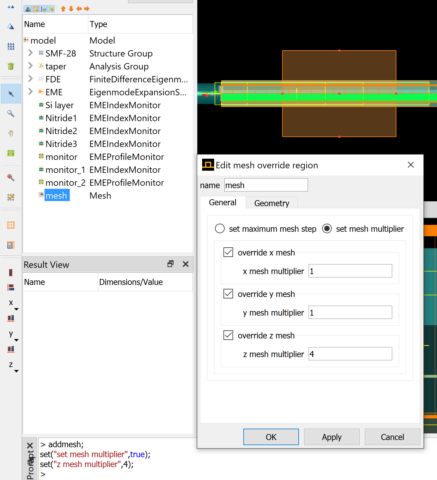

I am trying to simulate this example recently: Edge coupler – Lumerical Support
In the Script file of the no substrate case, (file name: Edge_Coupler_No_Substrate.lms) they are using codes to add taper structures. However, when they are adding the Si substrate override mesh, they used these two lines (line 158 and 159) of codes which cannot run on my computer.
set("set mesh multiplier",true);
set("z mesh multiplier",4);
May I ask what is the meaning of these two lines? Are they important for this program?
June 1, 2021 at 12:59 pmGuilin Sun
Ansys EmployeeHi, This is a special feature for MODE product: it means thatthe override mesh size changes the multiplier times from the original mesh .When the "mesh multiplier" is larger than 1,the mesh is finer; when it is smaller than 1, it is coarser.
set("set mesh multiplier",true); to enable this feature
set("z mesh multiplier",4); to assign value
I tested both R1.3 and R1.4 in FDE and both work. here is the test for the same file you mentioned:
Please check the error message and make some modifications after some diagnoses.
You can enable anther feature (by default) to directly assign the override mesh:
The script is similar. Please try.
Or you may need to update the version. or please tell us what is your computer OS version.

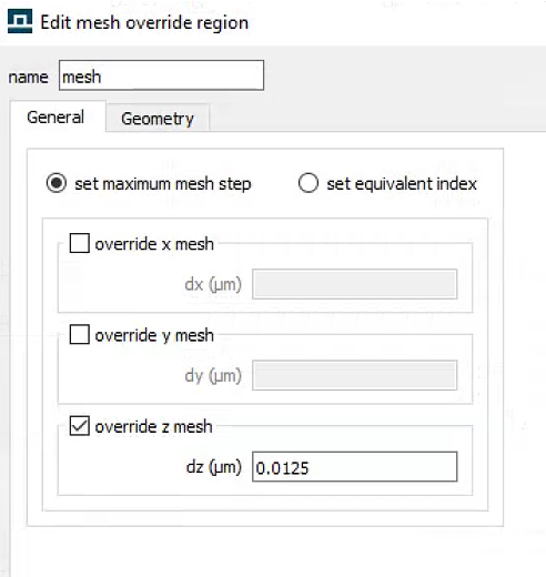

June 1, 2021 at 1:30 pmcqtavee
SubscriberHi!
Thank you so much! I noticed a wired thing:
When I am running the script to add the mesh, the two checkboxes are called "set maximum mesh step" and "set equivalent index". That's where the error comes from. Because there is no checkbox called "set mesh multiplier".
However, when I add the mesh manually, the two checkboxes are changed to "set maximum mesh step" and "set mesh multiplier" magically. And the window looks the same as the screenshot you showed.
(I'm using R2.3 version)
