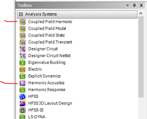

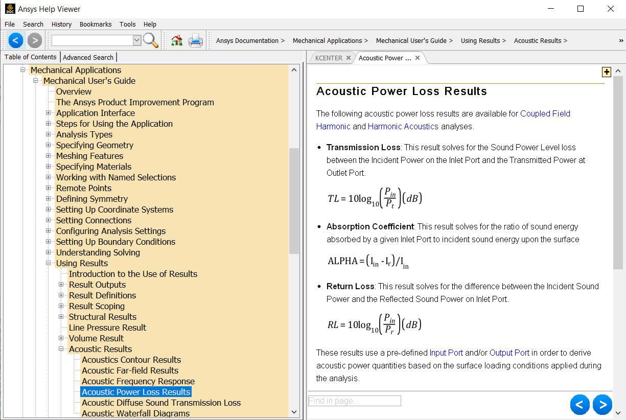

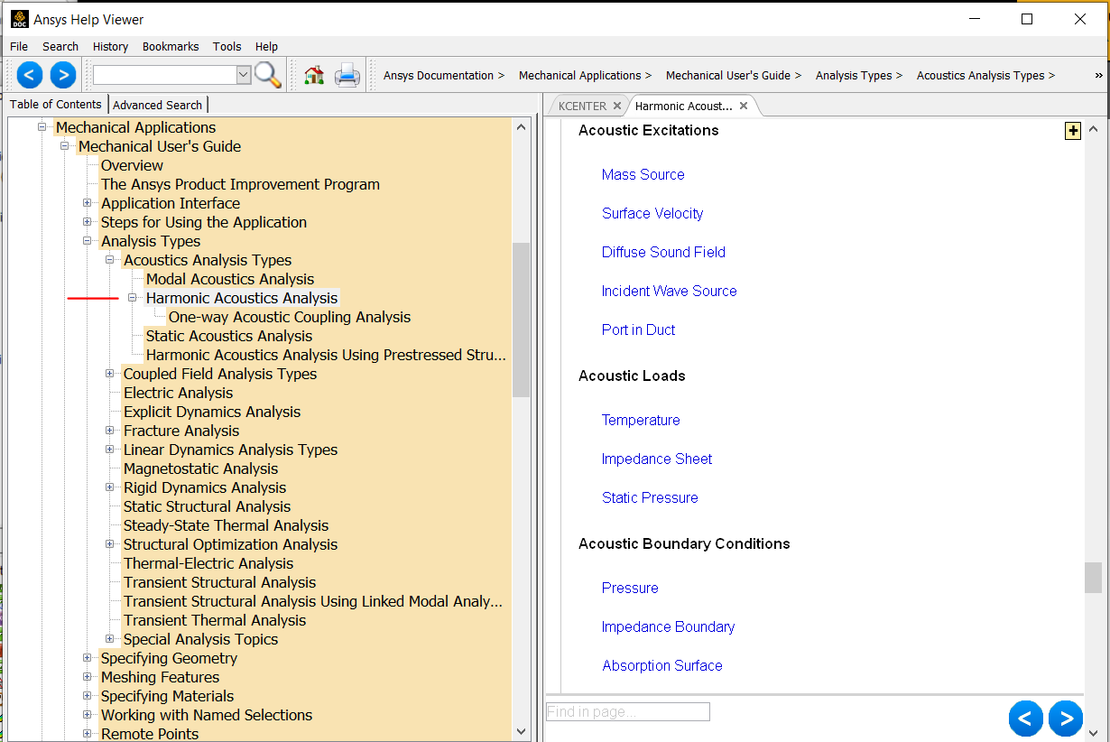

      Is there anyway I can simulate a impedance tube on Ansys? With the goal of replicating this technique and measuring the coefficient of absorption through certain surface

      Have you reviewed the Help section that discusses various options for defining acoustic excitation and boundary conditions:
      Also, post processiing options are discussed here:

      You can do frequency domain (harmonic response) acoustic simulations using either of the analysis systems indicated below:
