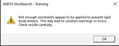

I have a solid cylinder fixed at left face A as shown in the figure below.
May 17, 2021 at 2:04 pm1shan
Ansys EmployeeFirst, insert a cylindrical support, scope it to the cylindrical face and just fix the tangential DOF(rest free). Second, add a displacement to the circular face and fix the DOF along axis of cylinder(rest free). Also this link https://ansyshelp.ansys.com/account/secured?returnurl=/Views/Secured/corp/v211/en/wb_sim/ds_Geometry_Behavior.html contains details about the 4 behavior options.
