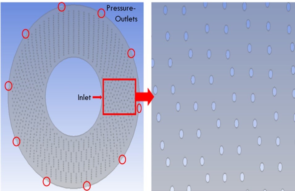

        This
        This is the actually geometry. The inlet is rotating in a clock wise direction with respect to the inner packing (in circular rings). The whole geometry was initially filled with carbon dioxide and the solvent, i.e., Potasium carbonate is injected into the reactor through the inlet. The mass transfer UDF is hook to study the efficiency of the reactor to assist the absorption of CO2 in to K2CO3. To model the rotation of the inlet the Reference fram model was employed in combination with the VOF and SST-Komega model.
        To study the mass transfer of CO2 in the K2CO3, species transport model was enabled. The inlet fluid (K2CO3) was changed to mixture template (CO2 and K2CO3) with K2CO3 mass fraction of 1 to ensure only K2CO3 is only injected into the reactor. The purpose of CO2 in the mixture template is only to monitor in concentration of CO2 in the mixture template at the outlet.
        With transport model disabled and when K2CO3 is injected alone (not as mixture template), the hydrodynamics are normal as the reported literature but with using the mixture template the hydrodynamics become abnormal even though the mass fraction of CO2 in the mixture template at the inlet was set to 0.
        This is actually the main problem. If guide in this regard.
