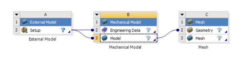

Aniket Chavan
Forum ModeratorIf you want to take the mesh to Mechanical, then you can use "External Model" system and connect it to the model cell of the Static structural (assuming you are using one), and then transfer mesh from Model to Geometry.
There is no supported way to translate the odb file to a geometry file as per my knowledge.

Rob
Forum ModeratorIf you right click on the External Model (A) you should be able to browse to open the odb file. If that doesn't work, you should be able to export something from Abaqus that'll read into either External Model or Fluent Meshing. The problem you may find is the model size (number of faces, facets or cells) on the Student version: this can be avoided by using a research licence.Â

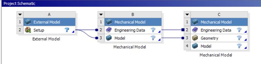

mariannebassil
SubscriberI don't find the external model neither the mechanical model... Maybe because i am using Fluids package to use Fluent CFD . DO i have to install another packages ? on the other hand i tried to export the mesh from abaqus to Step format but it didn't work ...

Rob
Forum ModeratorWhich licence are you using? The Student version should have everything.
October 30, 2018 at 11:05 am
mariannebassil
Subscriberi attached workbench page above. The license for academic package

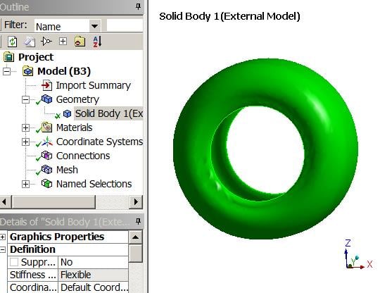

peteroznewman
Subscriber Marianne,

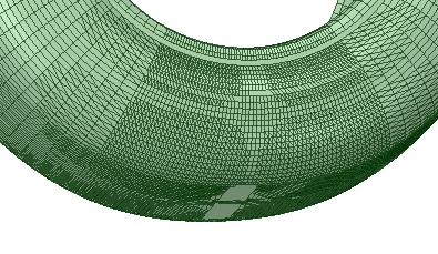

I can see the Geometry and Mesh in ANSYS Mechanical using a Mechanical Model component.
If I open Model B3, this is what I can see in Mechanical under Geometry...
Click on Mesh...
If I RMB on the Mesh I can export an STL file.

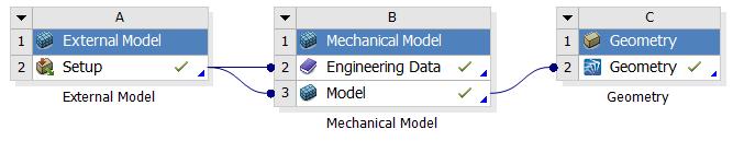

If I RMB on the Solid Body an Export menus shows up...
I saved it as tyre.pmdb.
If I open the Geometry component at C2, SpaceClaim opens but is empty.
If I create a new Geometry component D, I can import tyre.pmdb, but again, SpaceClaim opens and it is empty.

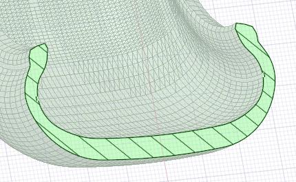

I can open SpaceClaim and read in the STL file.Â
This is the at least Geometry that can be edited.
RMB on Facets and Convert to Solid, with Merge Faces = Yes.
Section view of the solid in SpaceClaim.

mariannebassil
Subscriberif i can have the geometry as a single surface rather than the mesh format ( it means like the green solid body above like it appears in the external model)
November 14, 2018 at 1:09 am
peteroznewman
SubscriberYes, the green body in the top image is the same solid shown below, just without the facets being rendered, but they are there all the same.

peteroznewman
SubscriberIn Mechanical, RMB on Mesh and Export STL File. Open SpaceClaim, then open the STL file just saved. It shows a Facet in the Structure. RMB on Facet and Convert to Solid. You have a choice to Merge Faces.
