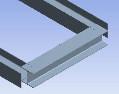

SubscriberThank you, peteroznewman (Peter?), for your quick and inspiring response. Yes, I want to analyze the effect of cable tension on a crane lift assembly. To answer your questions:
The steel plates were idealizations of more complex structures. The first plate, connected to the crane hook via cables, represented an H-pile rigging spreader frame, depicted below. The rigging frame below consists mostly of H-piles with designation 12 x 53 manufactured by Skyline Steel out of A572 Grade 50 steel. The frame is 53 feet long and the long H-piles are 6 feet on center. H-pile flanges are welded (bonded) to H-pile webs, H-piles are welded together, thickening blocks for shackles are welded to H-piles, and for the sake of simplicity, screw pins are welded to shackle hoops, though the screw pins have frictionless contacts with H-piles. If you recommend it, I could very easily model the steel plate we talked about and add some shackles.
I chose 1-3/4-inch Crosby screw-pin shackles, which is overkill for now. I'm good with a 1-inch wire rope for now.
Let's say that the crane hook is 60 feet above the top of the H-pile rigging frame.
I'm interested first in the behavior of the rigging frame; then I'm interested in the behavior of the wire ropes.
Let's start with a static analysis with no wind load. I would be interested in accounting for wind load and/or acceleration later.
The H-pile rigging frame would probably start off on some 7" x 9" x 8' railroad ties.

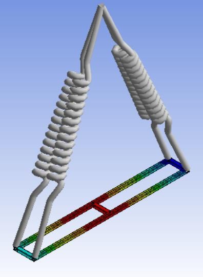

SubscriberI found a reference to look up what an HP12x53 I-beam looks like, and better yet, if you want to model this structure with beam elements, that section is included in the SpaceClaim profile Standard Library.
What is the correct orientation of the beams? It's very easy to rotate the beams by 90 degrees.
A beam model is the simplest idealization of the structure, but it doesn't have any detail about the thickening blocks.
It will be necessary to have a solid model of the structure for more detailed analysis.
I put 4 springs, one from each corner to a point 60 foot above the center and turned on gravity. It successfully solved. The center of the frame sags 3.8 inches, the springs, which represent the cables, have stretched so that the corners are down 1.8 inches after gravity turns on.
Peter
Attached is an ANSYS 19.2 archive

SubscriberHi Tom,
A beam model is probably too simplistic for your needs, but it is proof of concept for more advanced models that are built from the solid models that come from Inventor. SpaceClaim may be able to open an Inventor file directly, but if not, you can export an ACIS file from Inventor and open that in SpaceClaim.
The only math I used in the tutorial below was to divide 53 by 2.
https://youtu.be/3ImhbgVgET8

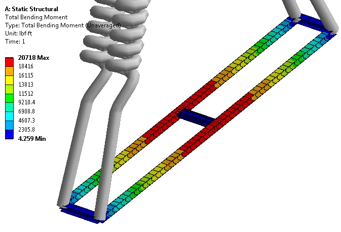

Here is the bending moment that I added later.

I ran the analysis you presented in your video above. Thank you. I now know how to perform a simple static structural analysis of 1D beams in a 3D arrangement sharing endpoints subject to gravity supported by 1D springs. The only issue I had was that I needed to collapse the view of the idealized beams down to lines so that I could select intersection points as connection points for the springs.
