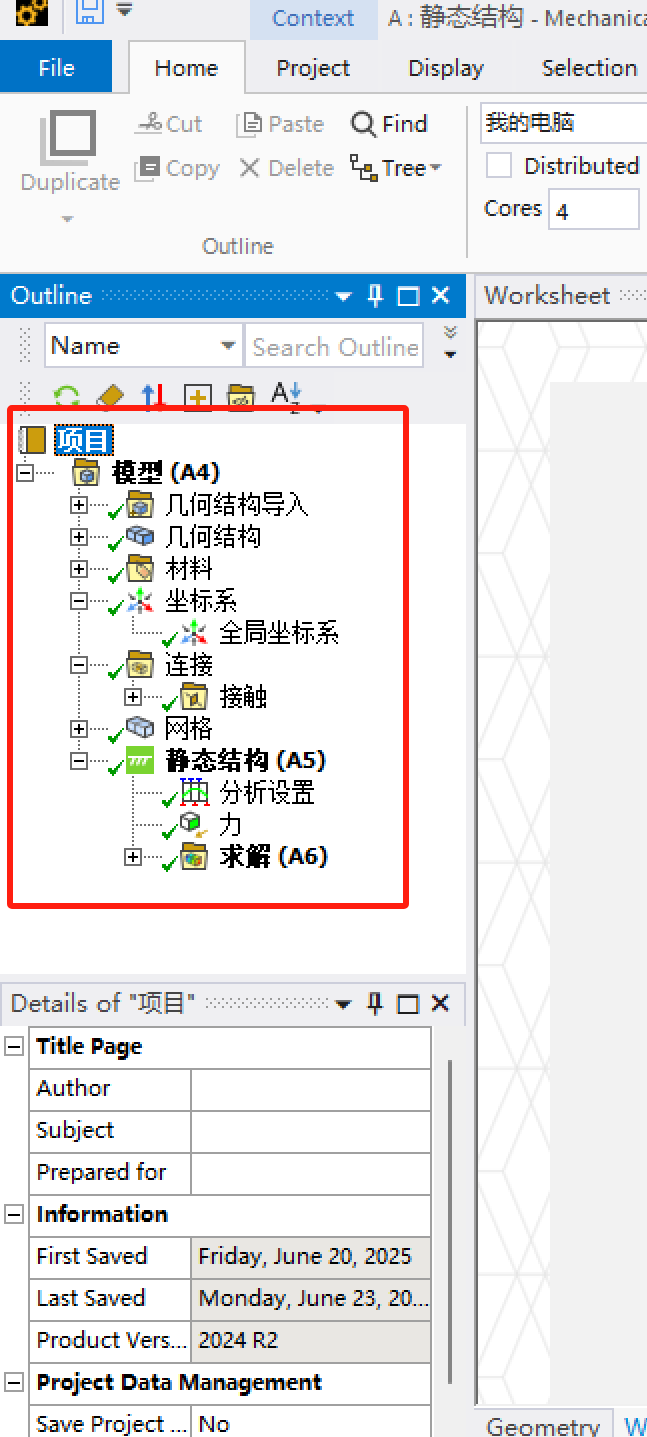

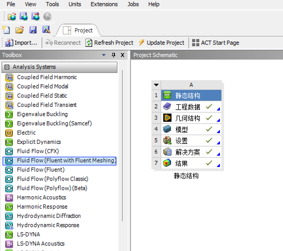

      Hello everyone,
      After switching the software language from Chinese to English, I noticed that some Chinese text still remains in the interface. Even after entering Workbench, a lot of Chinese labels or items are still present (as shown in the image).
      Renaming all of them manually might work, but I wonder if there’s a more efficient solution to completely switch the interface to English?
    • Gary_S
      Changing the language settings does not automatically rename the fields in existing Projects.
      If that is not the case, we can try resetting the Application Data folder.
