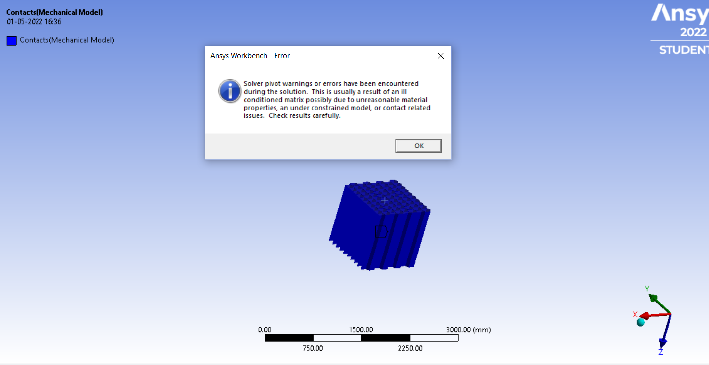

May 1, 2022 at 11:12 amSrinivas_Kotuma
Subscriber.I have a similar problem can you please go through it and solve my issue?
A solver pivot warning or error has been detected in the UZ degree of freedom of node 26650 located in Surface Body(Top Plate). This is usually a result of an ill conditioned matrix possibly due to unreasonable material properties, an under constrained model, or contact related issues. Check results carefully. You may select the offending object and/or geometry via RMB on this warning in the Messages window.

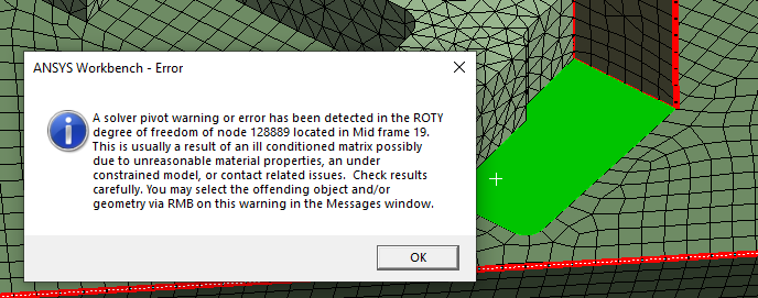

.May 1, 2022 at 11:17 amNovember 4, 2022 at 12:59 pmEef
SubscriberHi Abe, I have exactly the same problem. Every time I fixed a DOF error, related to a certain node number, a new node appears to have the same error.
Also some nodes are in the middle of a surface. Not connected to any edges. Merge nodes doesn't make a difference.
Please help. Takes ages to get this complex plate model running.
