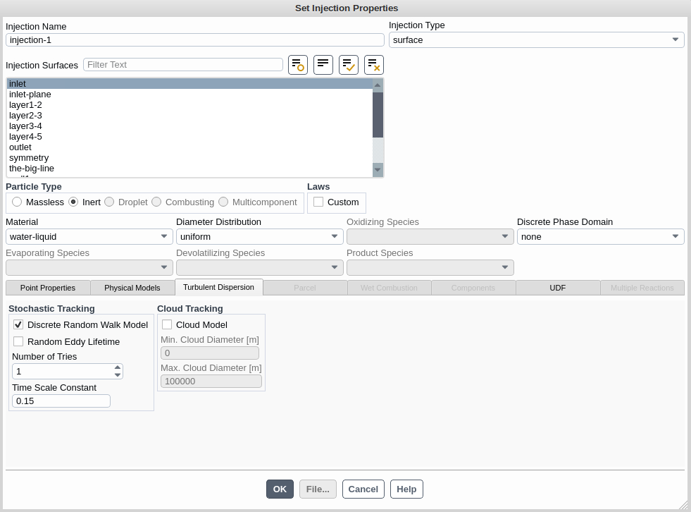

      I have a question about the particle time step and the number of times the particle equation of motion is solved in a single cell for a single parcel passing through that cell.

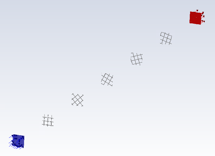

      I am simulating particle capture in multi-layer screens in fluent using DPM. K-Omega SST model is used and DRW is added to the DPM model to see the impact of turbulence dispersion on the particle capture. I have defined multiple mono-size injection groups under the specified settings according to the attached photos. size of the smallest under-study particles is 50 nm and the largest size is 10 microns.

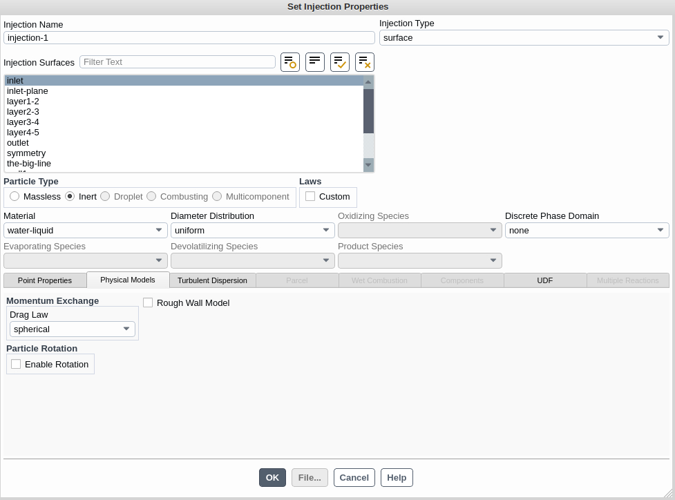

      The drag law is spherical. It is noteworthy that the "number of tries" will be set to 50 for the capture study but it is set to 1 here for studying the trajectory of one single parcel.
      both the flow and particle tracking are calculated in steady-state conditions. I have extracted a "step by step" file report of the particle track for the 1-micron size group while the "track single particle stream" was activated.

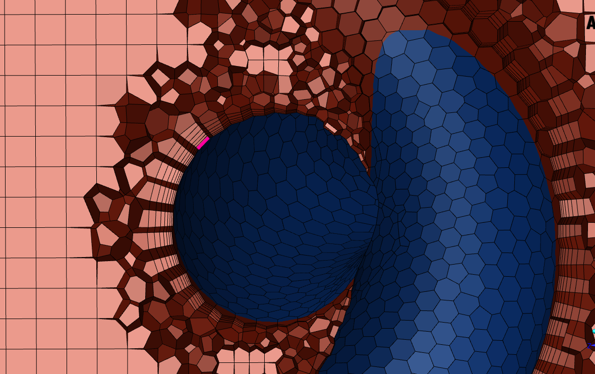

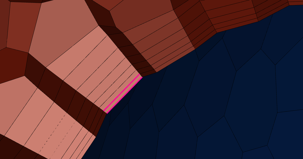

      These are 3 different zooms of my mesh. The height of the first layer of mesh, right above the walls, is about 3e-7m according to the third photo in the following.

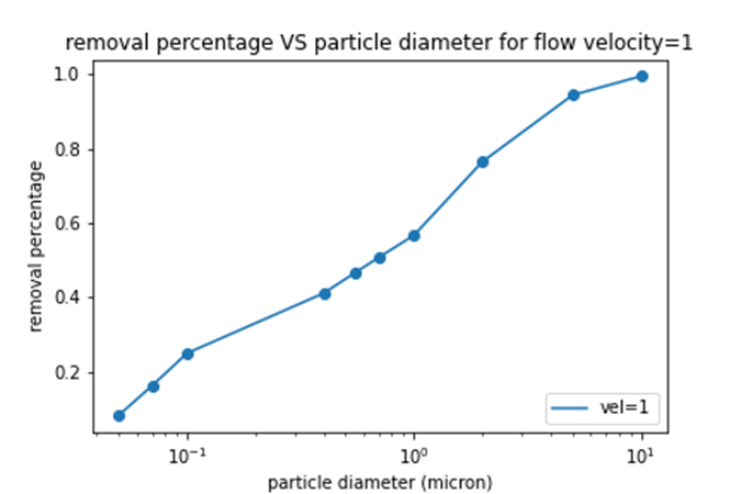

      At high velocities (above 1m/s) because of the higher inertia of the particles, they cannot follow the sudden change of streamlines close to the wires well enough and hit the walls and get captured (filtration by impaction mechanism). My wire diameter is 0.05mm (50 microns) and the wire distance (i.e. aperture size) is 0.1mm (100 microns). the porosity of the screen (ratio of the area covered by the wires to the total area) is about 60%.
      I currently observe about 60% removal of the 1-micron particles at 1m/s.
      OK, you may want to revise the first cell height. DPM won't check wall collision unless it's in the near wall cell, at one micron diameter at the point the parcel enters the cell it should have hit the wall.

      The trajectory is checked in the near wall cell, so depending on the angles etc the particle can still miss the wall. The position relative to the wall (ie if it'll hit it) is NOT checked until you're in the near wall cell. So, if the cell height (remember Fluent reports cell centre height, Meshing returns cell height) is over the radius you should be OK.
