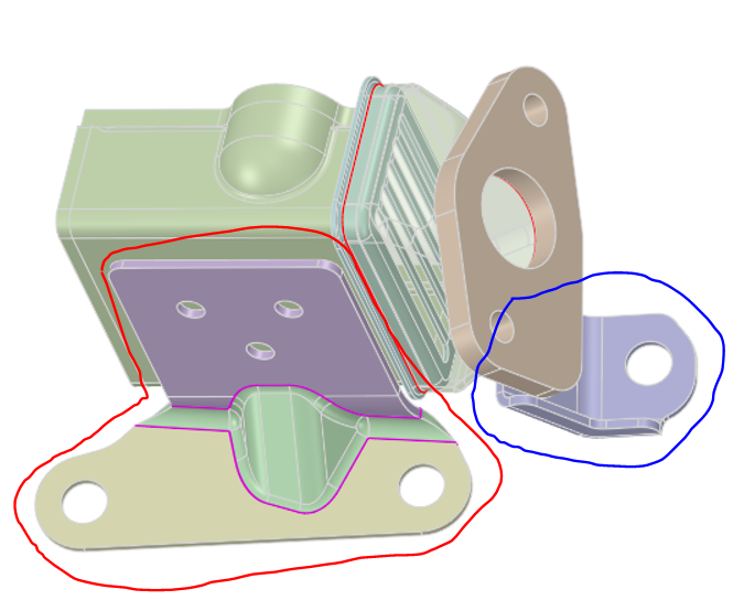

Forum ModeratorCan you post images of the geometry? Are any other volumes linked as sweepable is checked by the meshing tool and topology issues can cause problems.

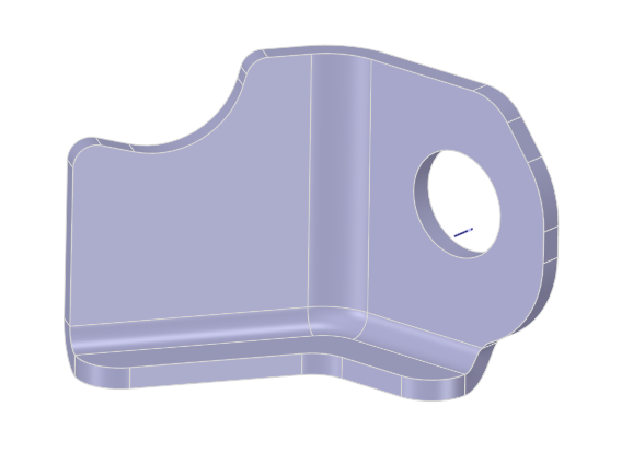

The top image is simplified assembly model and below that is sweepable model. I think you are right. It's about topology issue. Cause when I deleted all the share topology feature and went to ansys model. It worked. However, when I set up some "share topology" feature. It doesn't work with sweep num div tab even though the topology shared is not about this sweepable model. So my following question will be how do you fix this issue? Thanks in advance.

SubscriberI think I solved it by creating a new component where I put the shared topology geometries. Thanks anyway.

Forum ModeratorSweep has restrictions on number of source & target faces (1 at each end) and may need the source defining. In theory it's automatic, but with more complex shapes it doesn't always get it right. We did add in a multizone-sweep method but most meshing is now done with Fluent Meshing. The new approach is fine except for thin bodies, we're working on that.
